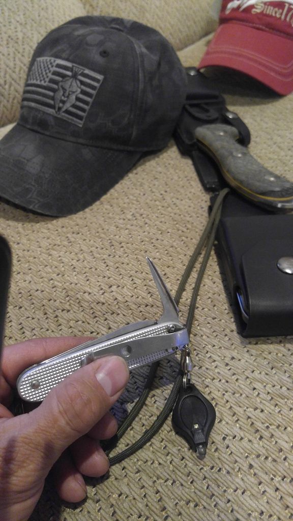

This is the one I use. It's on an Alox Pioneer, my preferred edc, and the only one I've tried on a SAK.
Pretty sure that one came from knifekits. It is really stout, all my efforts to destroy it have failed!! :D
That is the leather awl/reamer, same as what I use but in the farmer alox model. The belt clip will work in a pinch as well to piggyback the sak.
[/URL][/IMG]
LOL I assume you tapped the holes yourself?
Yep, I did two. One I totally disassembled, drilled and tapped the holes (super easy to do that when it's apart) and then reassembled and pinned it back together. The Pioneer took 2mm and 3mm pins and I just peened the heads over with a ball peen hammer. The other one I drilled pilot holes, did NOT tap, and worked the screws in. I locktited the screws on both knives. I really thought the second knife would not hold up, but I'm still using both of them and they have held up well. The hardest part of the whole thing was trying to keep from peening the pins too tight.....tap and check, tap and check!
