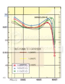

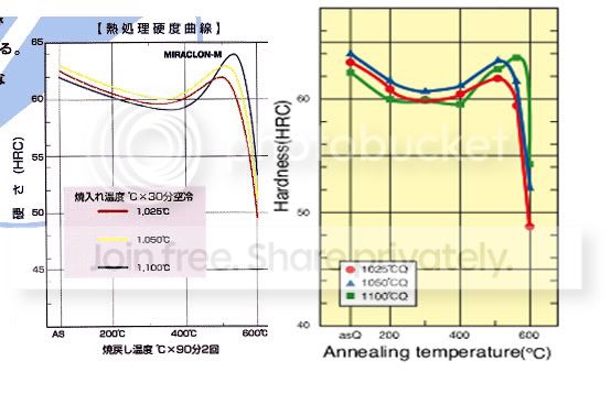

Well, here is a speculation:
In the link provided above (and elsewhere), you can notice Nippon Koshuha (NK) is the maker of the steel.
Maybe OU-31 could be somewhat similar to D2 (KD11, SKD11, KD11S, etc., see Gator's database). NK makes their "improved" version, as KD11S - http://www.koshuha.co.jp/eng/products/kd11s.html - but look at the quenching chart - note that it doesn't concur with the proclaimed hardness of OU31. So let's go on, there are three more steels under the "tool steel" option. RC55 is said to go "up to 55 HRC", that doesn't concur too, let's exclude it. KRCX "may be hardened in the same conditions as the SKD11 and SKS3" - therefore let's assume the similar quenching chart as with the aforementioned KD11S and the same outcome.
Then comes the KPS-6 - http://www.koshuha.co.jp/eng/products/kps6.html - apart from hints like "high tenacity" (OU31's "Toughness more than 3 times higher than that of D2") and similar hardness range, there is one interesting thing at that page, the quenching chart. If you compare it with the one from the pdf (or pic) above, there is obvious similarity.
I attempted to roughly scale the charts to the same dimensions:
Overlay of the two:
I think OU-31 is just fancy name, like "Tru-sharp" or "Carbon V", and maybe it might be worth trying to identify the composition of the KPS-6.
