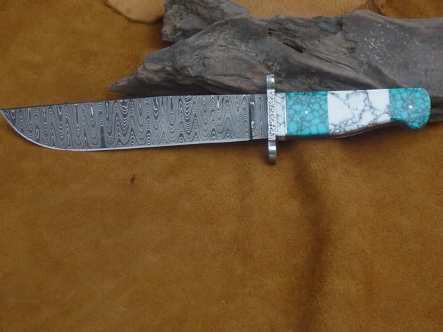

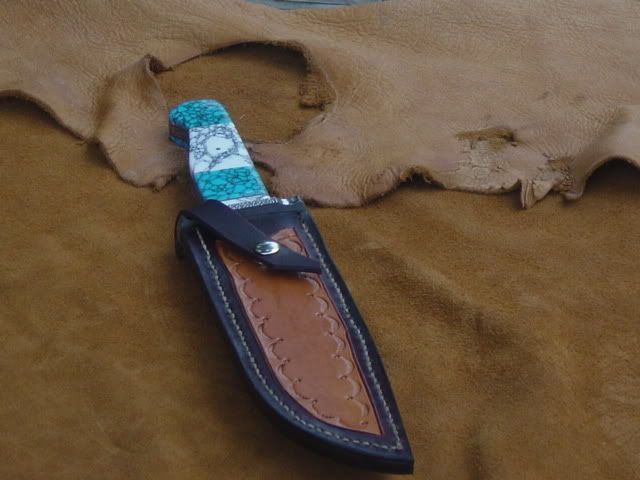

This looks well made. :thumbup:
My take? I dislike nearly everything about it - handle material, blade material, and overall design. Turquoise is a material which is best used in moderation. As to nickel damascus, it should only be ever used on fittings, in my opinion.
John,
It makes sense to reward people who have supported you at the beginnings.
I know some ABS MS use nickel damascus, but as far as I'm concerned this is non functionnal and therefore not appropriate for a blade.
Kevin... that really isn't how it works. 15N20 is often referred to as a Nickel steel because it contains 2% nickel. It's the alloy that allows the 15N20 in pattern welded steel (usually 1084/15N20) to resist the etching process. However, it does not make any noticable change in the heat treating over its typical companion of 1084. They are both shallow hardening steels that require similar times/temps/quenchants.
Pure nickel, or nickel 200... is a different story. It is VERY corrosion resistant, but cannot be hardened. The only proven way of hardening it is by cold working. So it adds a lot of flash to damascus, but it also adds layers that are not hardened like the rest of the blade/layers.
