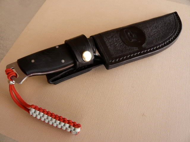

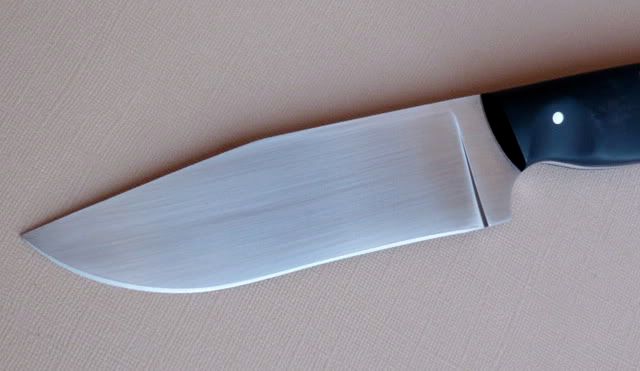

I take pictures on a cloudy day or in the shade on a sunny day. I'm no expert but it seems for work fine. Here is one taken in the shade;

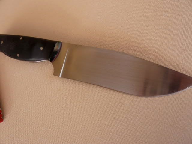

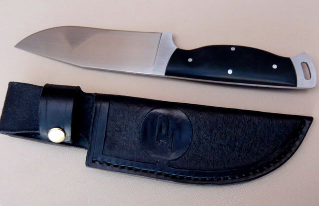

Thanks for the reply, Mr. Bump; that's a great photo and a gorgeous knife as well. Here are a couple of shots I took yesterday in direct sun inside my makeshift light box:
I think the color is off, there is some glare and shadows, and little detail of the blade finish.

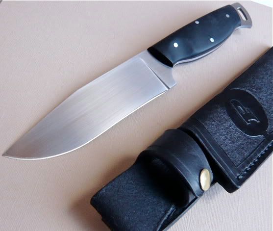

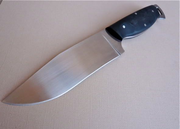

I took these just now in the shade in full daylight:
These shots definitely look better to me all around than the first batch, but there are still problems with glare, shadows, reflections, etc. I took a lot of shots from lots of different angles as well trying to minimize these things. I'm not too sure what I need to do differently to get results comparable to yours.

I try to take mine on a cloudy day or a little before dusk. Seems to work for me...of course the camera does all the work because I suck at pics. My pic started to get MUCH better after I got my Panasonic Lumix.
BTW my pics are unedited. The camera has a ton of settings and after playing with it for a while I found out what works best in which situations.

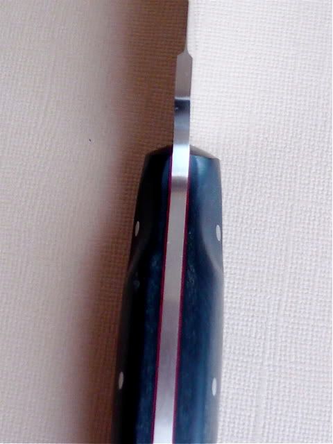

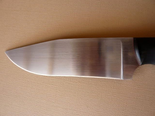

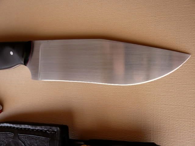

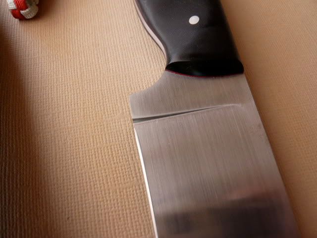

Here's a few more I did earlier in the morning in the shade. I think the blade finish detail is improved, as is the glare/reflection problem, but the color seems kind of washed out and they are a little blurry (perhaps this is my fault and need a tripod, although that would further limit my angles and positioning.) I did play around with some minimal software editing on some of these, using an Enhance button, and tweaking the shadow and sharpness adjustments. Too much shadow adjustment, and the black handles washed out and looked phony. I'd appreciate any input on these shots.
I'll keep playing around...thanks again for your suggestions.

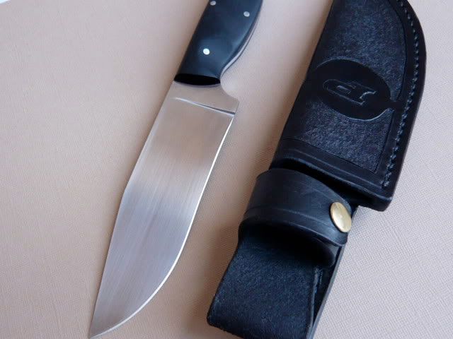

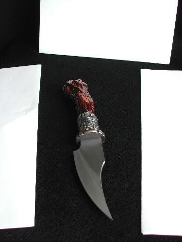

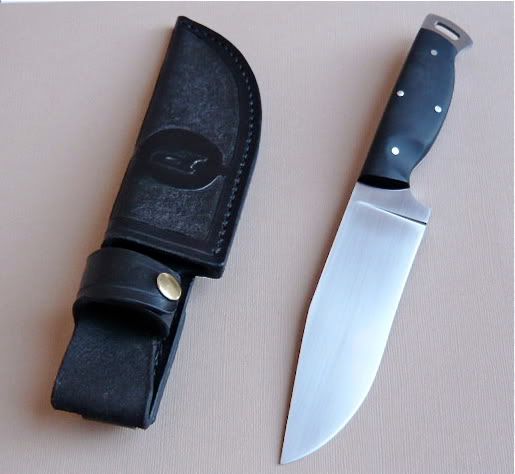

Hi Paul, I also live in AZ as you know. I use all natural light for my pics. I shoot indoors with the light coming through a window or door at an angle to create a more dramatic lighting effect. My ceiling is white which is reflected on the knife.
In the auto mode my camera tends to add light when shot without a flash and with a black background, but found I could compensate for that by framing the knife itself with white sheets of paper and then cropping them out afterwards. The more white that shows in the original framing the more light gets cut out and the less white that shows the more the light is added. It’s easy to achieve either effect just by zooming in or out. In other words the smaller the original framing the more light, and the larger the less light.
No direct sun light, (all reflected light indoors in the shade).
No editing other than cropping and re-sizing.
... trying to get the most out of a crappy old camera. :)

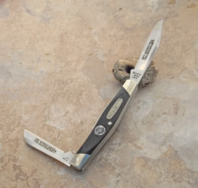

Here's a trick for sunlight photography, most folks have the stuff laying around.
Light tent, for even light, made out of a white trash bag, dowel rods and duct tape.
Here is the actual photo of the knife, $99 camera, extra floor tile, rock (free), GOOD tripod (most important). Not pictured is some folded paper I used to reflect sunlight into shadow area of knife.
