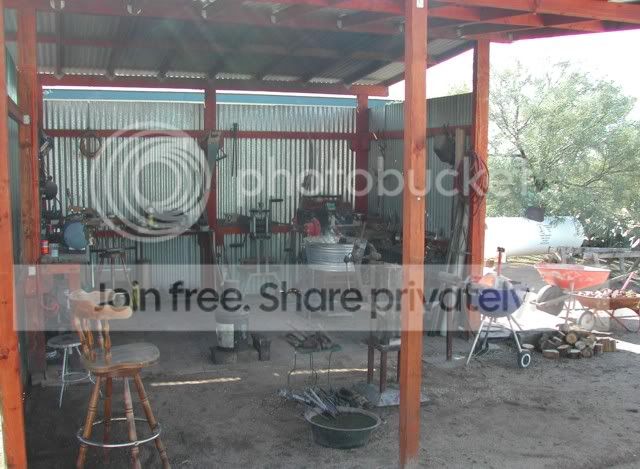

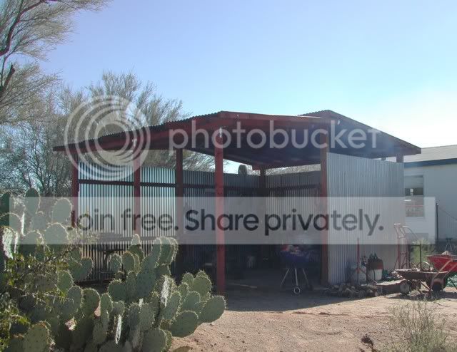

I built this "fire shed" for about $1000 in materials, but it's been a while. Materials might be a little higher now.
Aha! Thanks Tai, that front part of the shed, the overhanging portion, is almost exactly what I wanted to see! And the corrugated metal partial walls look like a good idea. Thanks.
It's worked out great for me. The bare metal is fire proof and cheap. It rattles a little on a real windy day though, but that part never really bothered me.
I scavenged the bricks for the back part of the shop floor.
Cheap buildings are us. :)
