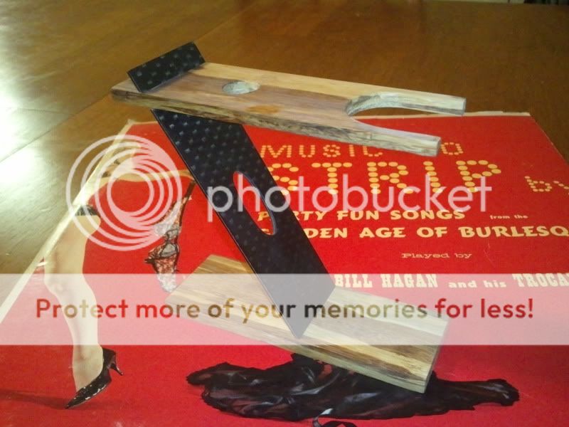

The degrees are the amount of tilt of a circle. Ellipses are just circles on an angle, or isometric view. A 45* elipse will be wider in the sort dimension than a 30*. Most templates will have two or three angles marked on them, a 2" cirlce tilted 45* will be 2" wide and 1" tall, but if turned 90* (so the long dimension is towards you) it will make a vertical 1" circle on a 45* plane.
Here's an example, the ellipse in the CF makes a perfect 1/2" circle to match up with the hole on top. I used an ellipse template when I made this razor and brush holder.
-Xander
