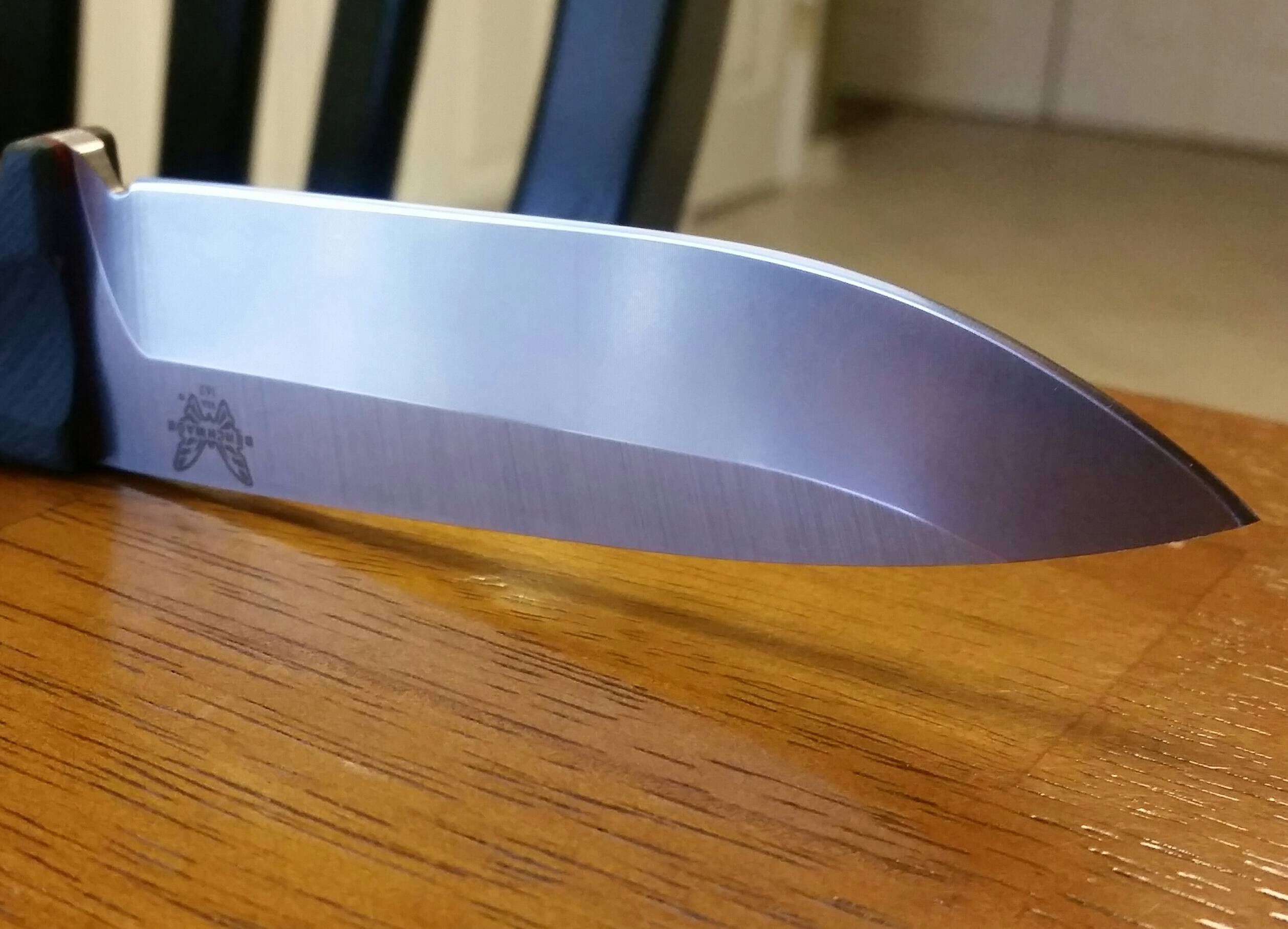

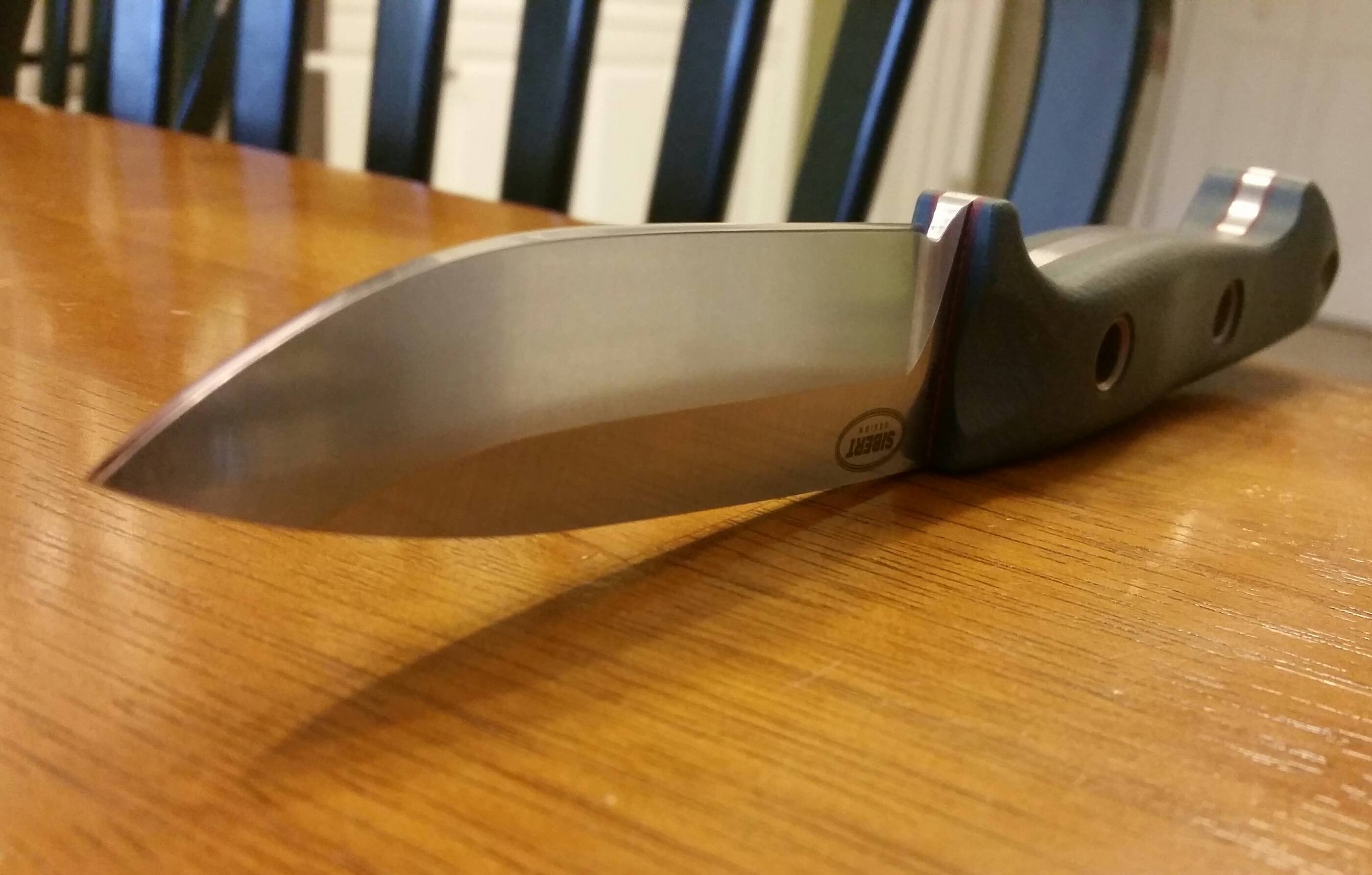

Hmm interesting, I've found the opposite for me...I find it easier to hit the area near the hilt and to keep a very pointy tip with the bga..
I also find it easier to match factory grinds with the bga. That doesn't matter to me as I typically reprofile but occasionally I'll sharpen for someone who insists on keeping the factory edge and just wants it cleaned up.
Like this one, the guy wanted to keep the factory angle, but wanted it cleaned up.
BEFORE:
AFTER:
I wouldn't been able to do that using the standard unit with the guides..the bevel would've been ground into a more pronounced convex.
