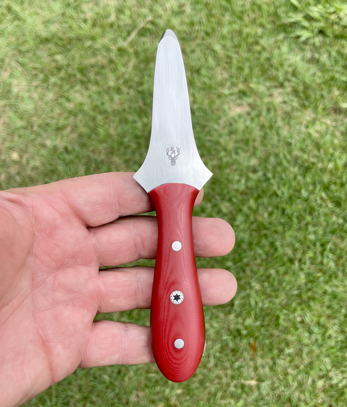

I like 1.25 to 1.5" wide flat sided handles with an elongated teardrop shape. This gives good leverage even when wet and slippery.
I have never had one returned broken.
Thanks so much. Here's one of mine.
