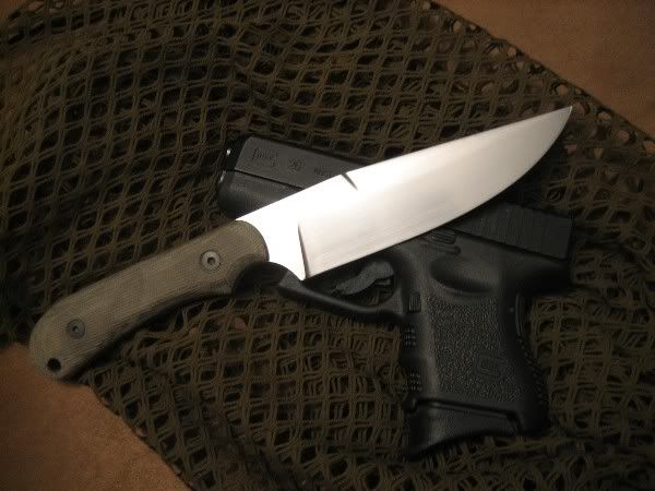

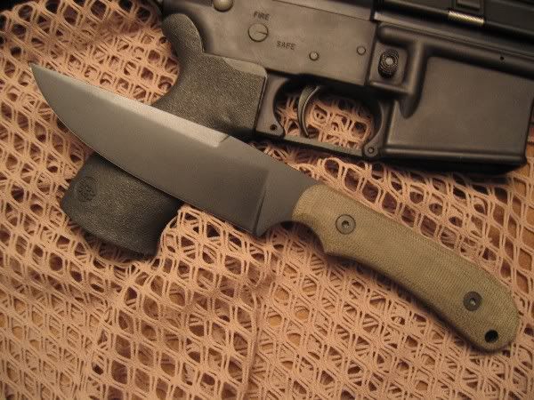

This is a fighter I ground from .200" D2, the blade is 5.5" and overall the knife is 10 1/8". Flat ground with a convex edge. Handle is OD green Micarta. Heat treated by Paul Bos to 59-60 RC.
I had a lot of fun making this one, but I don't know if I like working with D2. I just like forging too much!:D
That's nice. i really like the blade shape and grinds.
