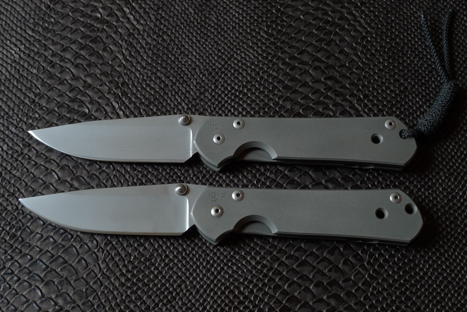

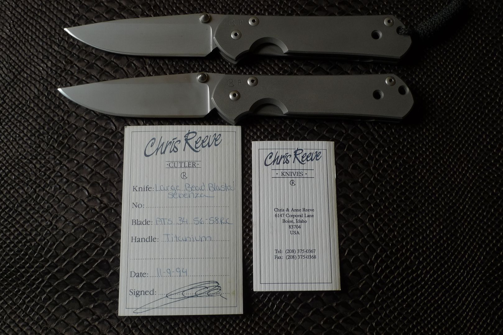

Here's a couple of P's with the BB finish on the blades. Chris's wife Annie sent me an email explaining how Chris was experimenting with the different finishes on the blades but in the end he decided against the BB finish because of rust issues.

I can't remember if it was Dino, but someone had a pic of like three different blade sheens/finishes.
With what looks to me like matching blasted screws as well, sure is a fine looking Sebenza.
Thanks for sharing those Dino, I have never seen one like that before.
Seems that at least half of the time I see a pic of a CRK on the forum and think to my self I would really like to have that one, I look up to see who posted it, and, it's Dino !
I sure would love to see a pic of your whole collection some day Sir.
Why, Thank You Sir.
WOW! These are some fantastic looking comparisons. Its one thing to hear about the differences, its anther to see them. This is like a virtual museum. :)
Thanks for sharing Dino!
