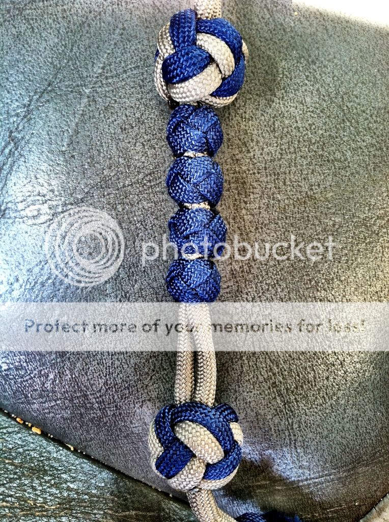

Tan and navy blue paracord ranger pace counter beads. A first time color combination request; instantly one of my favorites!!!
