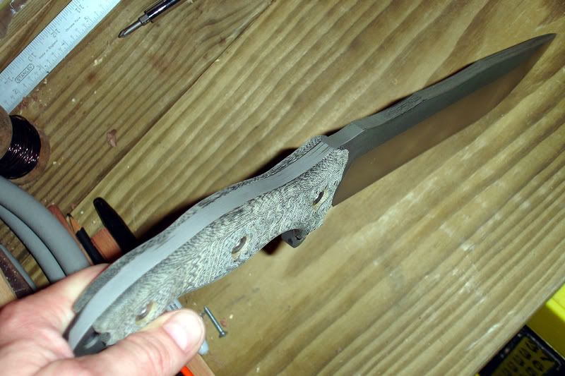

I'm considering stripping a TGLB and am wondering what would happen to the micarta if I were to dip the knife in paint stripper. I also would bead blast the blade afterwards and am wondering how the micarta would take that as well. I know removing the handles would be the best way to do it, I just don't have a way to reattach if I drill out the tube fasteners.
The bead blasting should not harm the micarta, in fact I prefer to have micarta bead blasted as it gives a different feel in hand. Just to be clear though, I am referring to either glass or ceramic type blasting. Sand blasting will eat away the micarta more readily and isn't recommended IMO.
Here's some pics of a Terror Monkey Desert Storm Fighter that was double cut bead blasted by AValenz here at BF, the handles were bead blasted along with the blade...... :)

Paint stripper didn't hurt the linen micarta on my FFBM...
A few years later, after much use...
I started out easy on cleaning my micarta handles, but have used full-strength bleach(SARQ) as well as Simple Green (SHSH2). It's tough material.
There have been some reports of stripper causing a whitening of G10. That has not been my experience on the one G10 knife I stripped.
As noted above, micarta will be fine. Done that many times. And I agree, micarta with a light blasting is a very nice grippy material.
