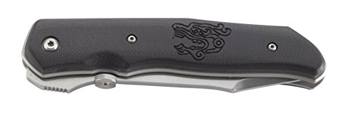

Painting g10 handle relief
Maybe try mixing up a batch of jb weld with red rit dye in it?
Glom it all in there, then sand off the excess once it dries. Sand the other scale to the same grit to match.
I think it would look super cool. Like an inlay.
If I were doing it though, I wouldn't even add the dye. I think the grey of the jb weld would look nice and understated. I think it would look super cool against the black handle.
what I would do is coat the scale around t relief in a thin coat of glue, careful not to get any in the channel. that prevents coloring that part. then apply fingernail polish into the channels with a toothpick. then remove dried glue around design. since its in a channel it might stay there as is, or you could add a layer of super glue
