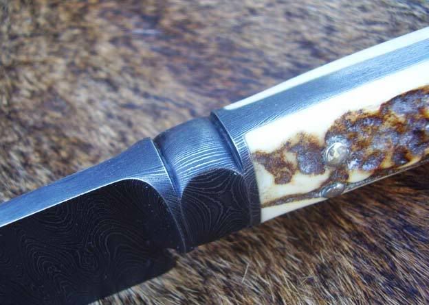

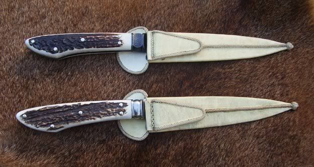

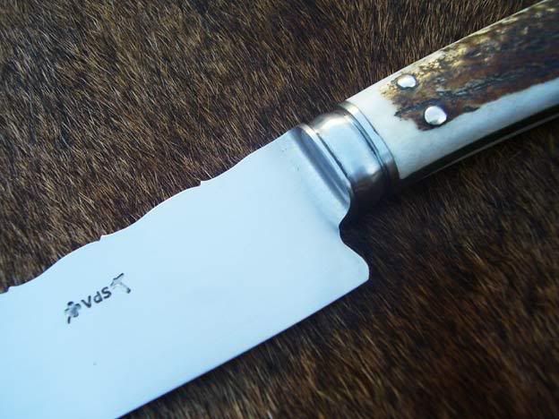

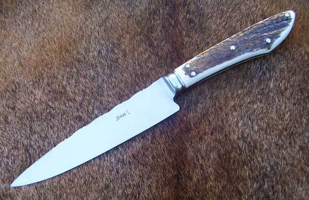

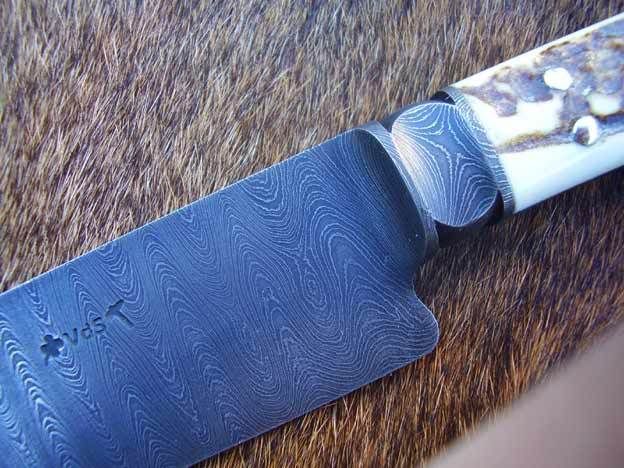

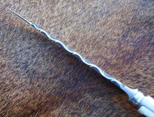

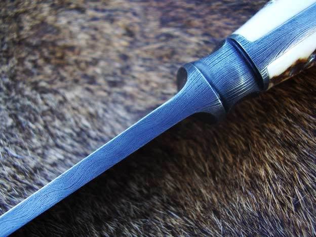

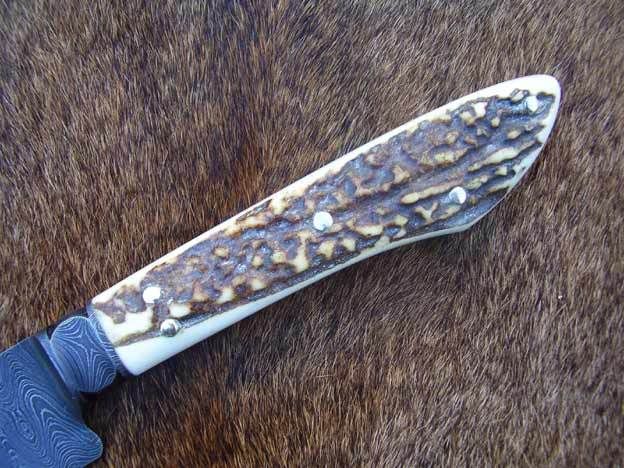

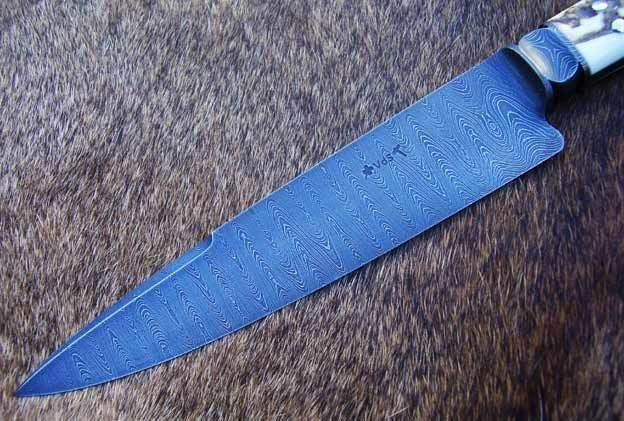

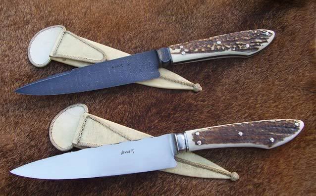

Hello gentlemen, I share with you some photos of a pair of integrals knives inspired by the traditional knife of Argentina and Brazil gauchos.
Both are one-piece blade, collar and handle, one in pattern welded steel ladder pattern from W1 and 15N20 carbon steels and the other is forged from a bar of 420 stainless steel with filework in spine.
Both have handle with red deer scales, alpaca rivet pins and rawhide sheaths sewn with strips of foal leather.
Hope that you will enjoy
Thanks for looking.
