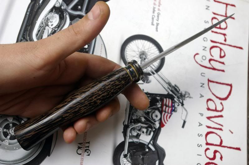

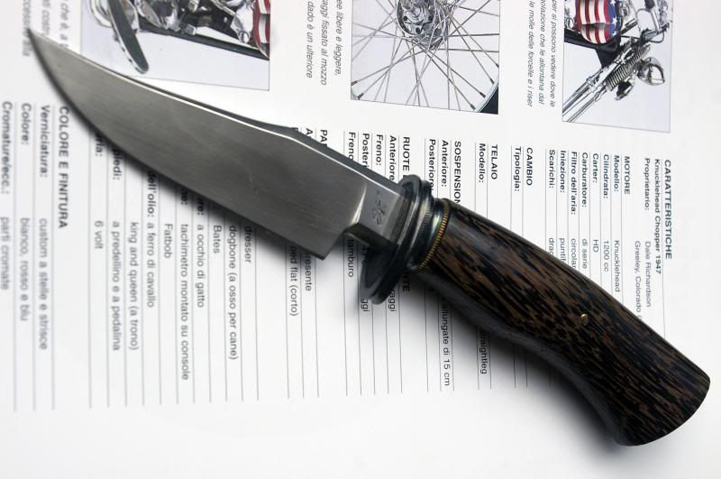

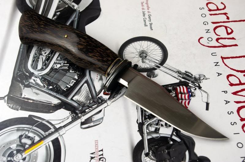

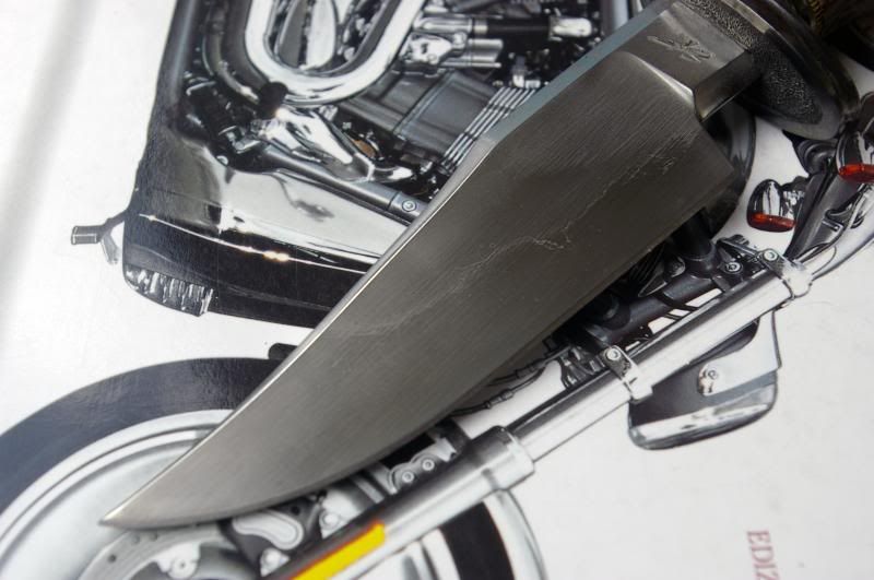

3/16" 1095 with hamon
Black Palm handle
Burnished mild steel and brass guard and fittings
Tot length 9.6"
Blade lenght 4.1"
I didn't made the sheath yet, my leather dealer is closed for holiday 'till september
Ciao!

I use the oil bluening method.
Just heat the degreased guard to blu/violet color and dip in seed oil, take it out and redo the process 'till satisfy you. Then rinse with warm water with some soap to remove burnt oil.
But it work with carbon steel, mild steel and iron only.
