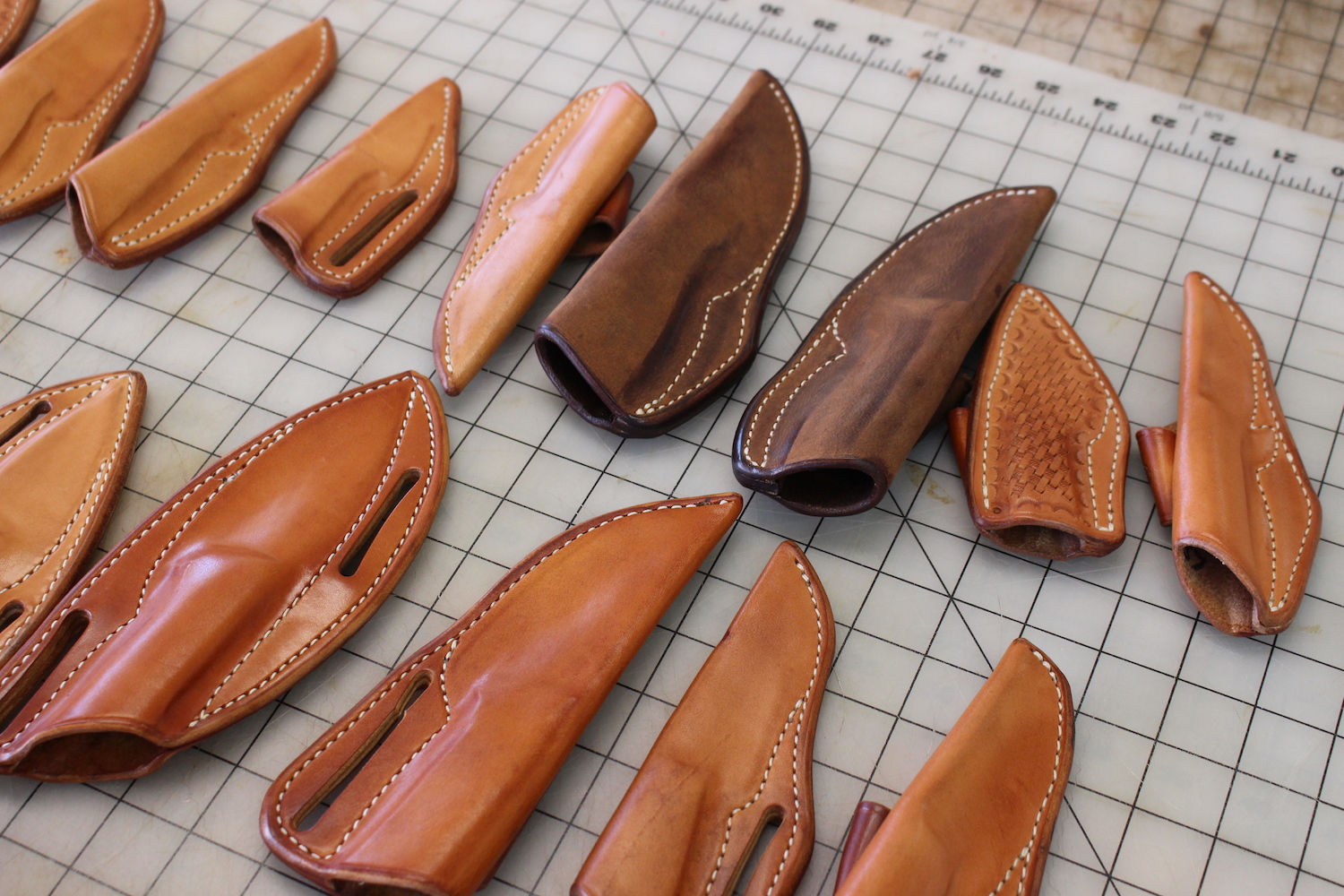

Finished this batch couple of weeks ago:
Those two brown ones at the top are not dyed, they are made from Water Buffalo.

Right. I reread what I wrote and I didn't quite clarify what I meant. For tooling, I'll just case it, then tool. But for the soaking to wet form it, will that affect the definition of the tooling?
I'm assuming not, looking at Horsewright's picture.
Also, Horsewright, what do you use for the background on the 3 in the front middle?
Jrmysell, here's a closeup of those three. All wet molded after tooling. You don't loose definition from getting them wet. Its the rubbing while wet to mold to the knife that can kill the definition. The background tool is called a bargrounder. Have 4 different sizes from Barry King Tools. My wife did this flower carving on these three.

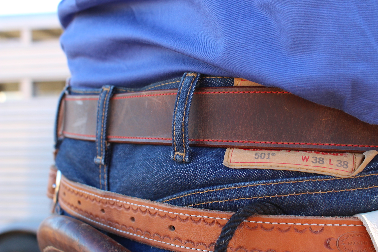

Customers wanted water buffalo leather to go with the water buff horn handles on the knives I was making for them. Found this leather at Weaver. Not my first choice for sheaths, wasn't real keen on how it molded. However, rocking belt leather. In fact got these two and their knives back from the engraver yesterday and will now make two belts for the customers. A buddy stopped by the shop one afternoon, saw this buff leather, ripped off his belt, cut the buckle off and had me make him a belt there and then. 8/9 oz water buffalo leather (Crazy Horse color), split to about 7 oz and lined with 4/5oz California Belt Latigo. Took about 20 mins, he brought the beer. Then we went roping out at the ranch, well they did I was still just taking pics recovering from surgery. Sorry for the drift Jrmysell.
