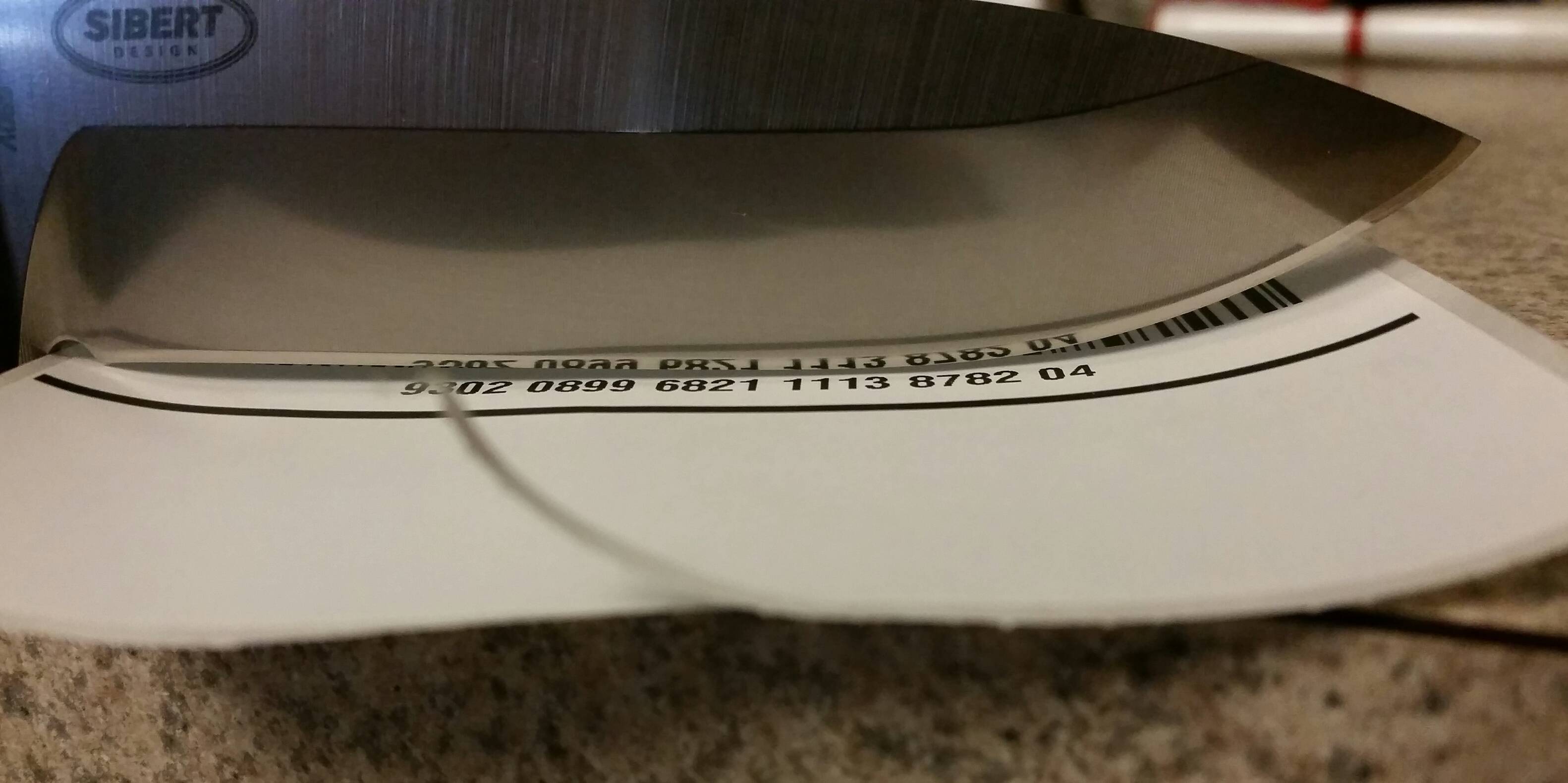

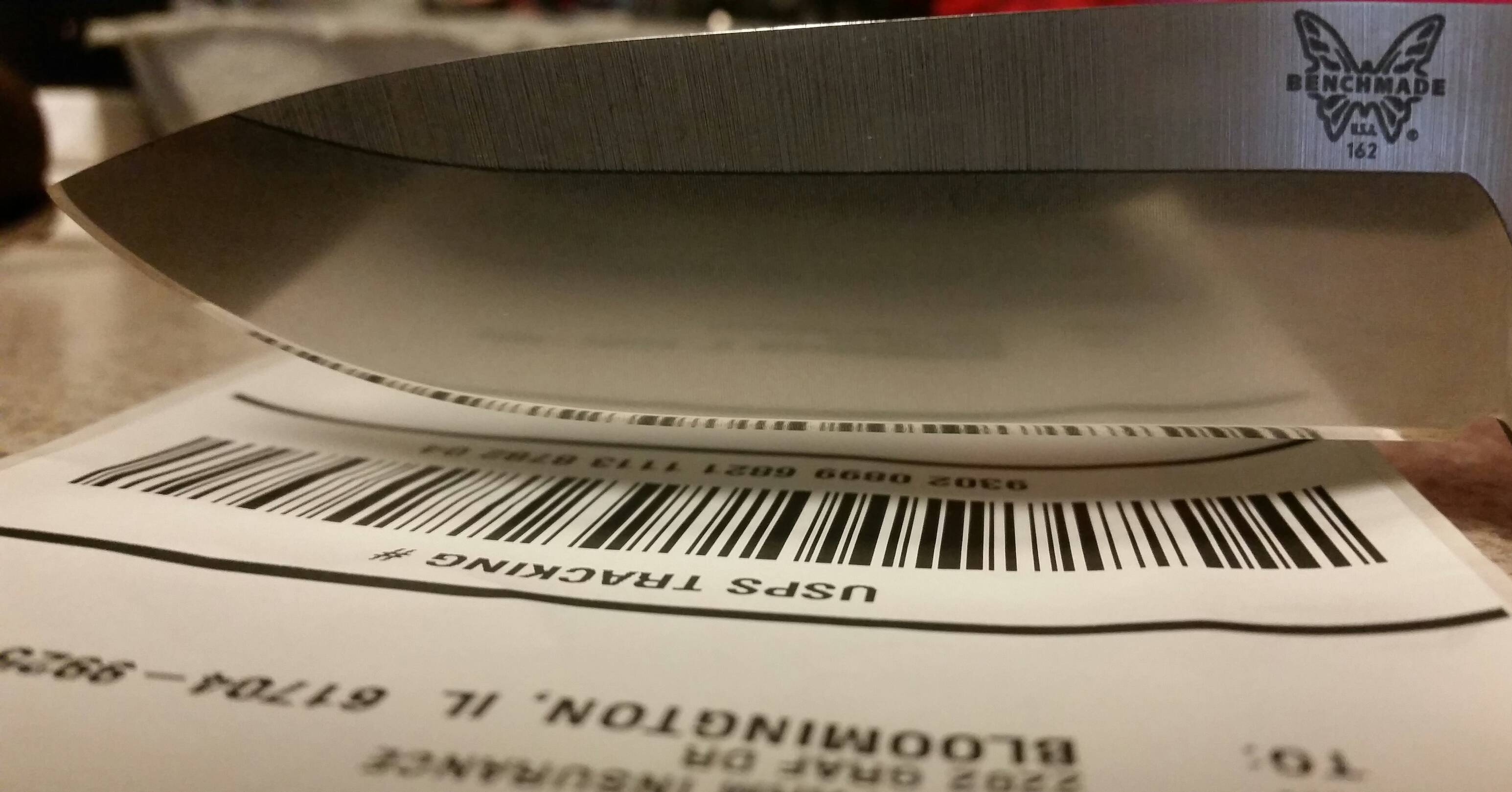

For s30v I usually use the p120 belt, then the x65, and deburr on the 12k grit belt..
Ive never taken s30v to a high polish on a Bushcraft knife, so I'm going to experiment and see how well my benchmade 162 holds a polished edge cutting wood.
Highly polished edges excel at push cutting tasks. Like making fire sticks and other "whittling" type tasks. Low grit "coarse" edges do better at highly abrasive tasks like cutting through cardboard. They also do better at slice cuts.
Brian.
Brian.
I just took it thru the series of belt grits.
P120, x65, x22, x4, and 12k belt, followed by stropping. It's by no means a high or perfect mirror polish, but more polished than I'd typically put on it. Gonna see how it performs tomorrow compared to my typical toothy edge.

For a folder edc knife I'd stick with a toothy edge with s30v, especially if you're cutting cardboard and things. I've never had good experiences with polishing a edc in that steel. I'm just curious how it'll hold with a more refined edge on a Bushcraft knife, thus the above knife.
