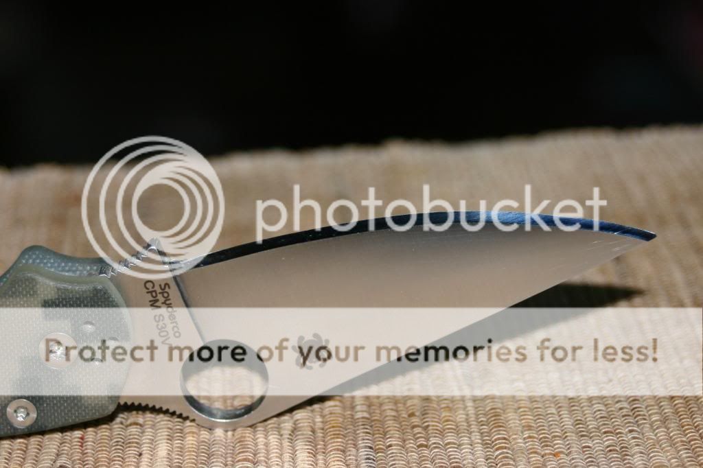

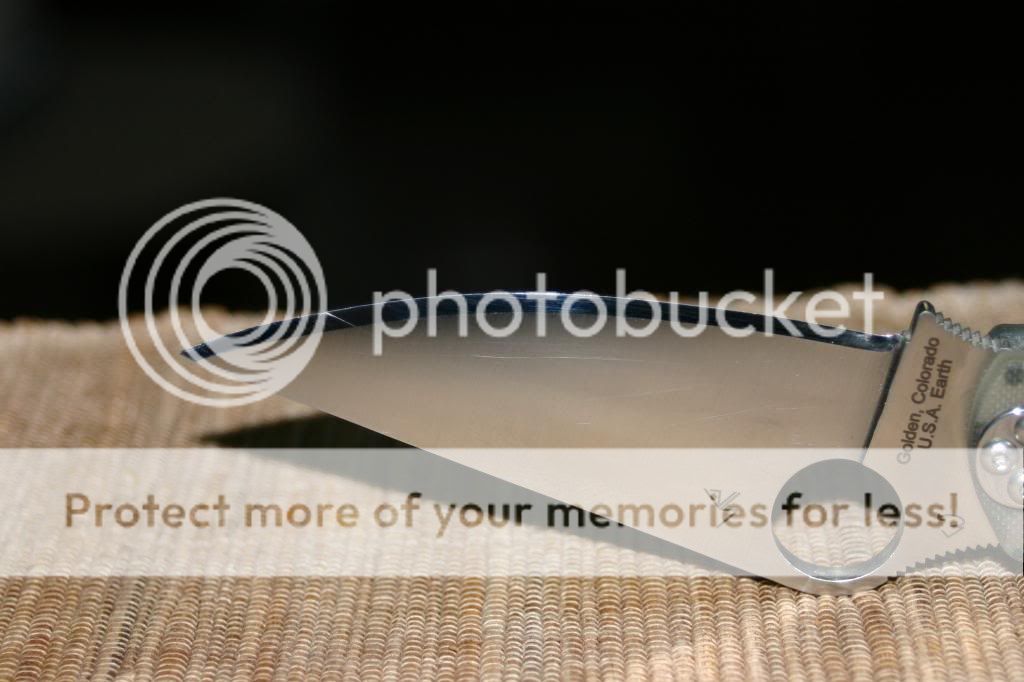

I will use the knife for everything. Opening boxes, cutting cardboard, cooking.. But not heavy stuff like battoning. These two pics look awesome. If I wanted to fix the bevel and create nice microbevel, it looks that I have no choice but sharpen the blade at 11°. When it is sharpened 12° and more Im almost hitting the secondary bevel. Angle cube says 12,5° in attached picture. If I were sharpening it at 15° I would have nice tip but rear of the blade would be bad. What would you do? :-)

I have some knives that are sharp, but not clean all the way down the bevel.I figure a few sharpenings and they will clean up. I would set the edgepro at 17 deg and work on it and see what you get. Post a photo and get some more feedback.
Why 17°? Isnt it too much? Should not I rather sharpen it , lets say at 14° and just do more work on the rear of the blade? :confused:

So it took me 5hours on the 220grit stone to reprofile the bevel - hardcore. Maybe in time I will polish the bevel but for now my hands want to rest :D I decided for 17° microbevel.
Nice work... Wow, that's a long time for a reprofile on the Edge Pro...
