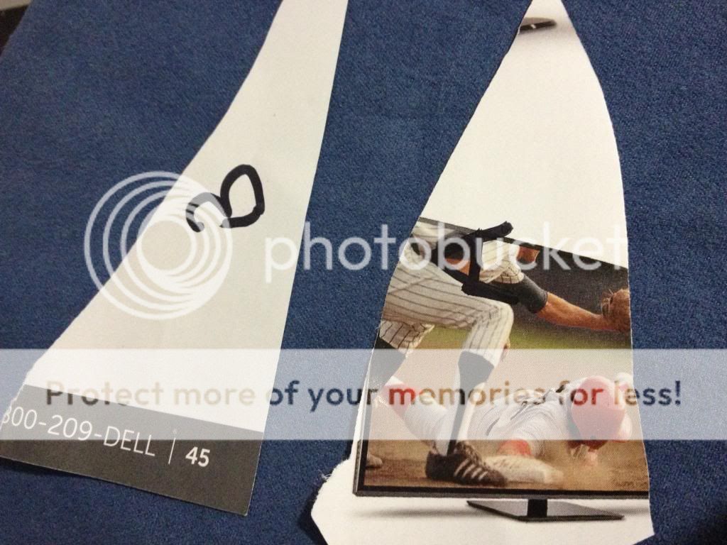

Did a little test. Cutting 1.16 lbs of cardboard up.
Edge help up fine and still push cuts printer paper, and slices thinner brochure paper.
Here you can see the edge being dulled a little but still cutting fine.
A=After testing
B=Before testing
S30v blade, no not the factory edge due to it being badly sharpened and thus not being controlled for this testing which would just cause issues with results.
For edge retention I do one of two edges: Straight 20 degree bevel with newspaper stroppping (this is for beefy geometries). Or a 20 degree microbevel on a narrower backbevel. For consistency's sake, I sharpen on the sharkmaker prior to stropping and after stropping I measure the angle via an iphone app.
This particular test was done was a 20 degree microbevel stropped on full grain leather with 6,000 grit compound. It was hair whittling sharp before testing.
