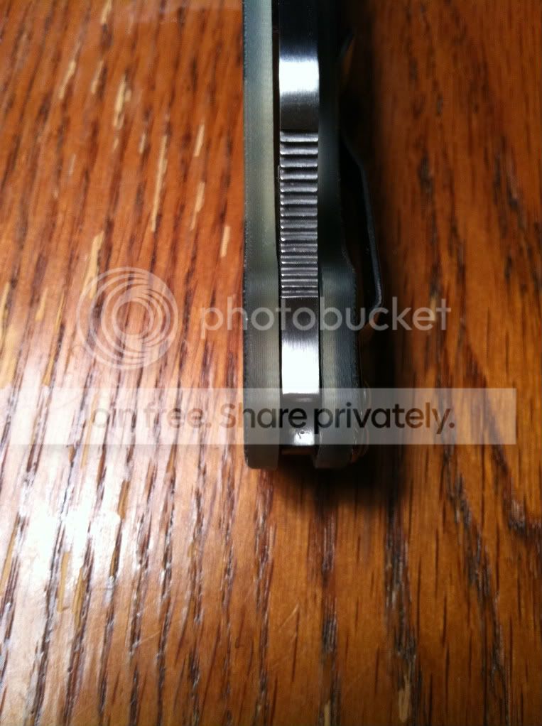

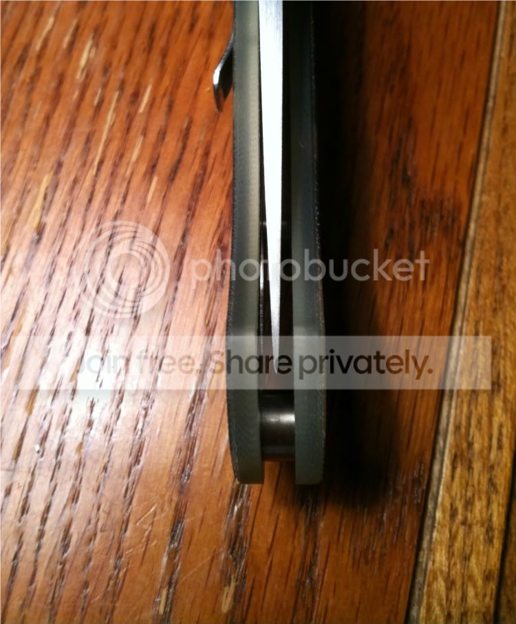

I have a couple of Paramilitary 2s. The black G10 model opens and closes buttery smooth. The digicam handle model is a LOT more difficult to open. The compression lock was very stiff at first, but now it operates just fine after I rotated the stop pin. When opening the knife with the spyder hole one handed there is a lot of resistance. I have to build up a lot of pressure to get the blade out of the handle. I have backed off the pivot screw a bit, but it doesn't help.
The weird thing is I can flick the blade open with no problems and it snaps open with authority, but if I try to open the knife slowly it takes a lot of pressure to get it started. My black handled model has zero issues. It drives me nuts that the digicam one isn't the same. Is there anything else I can do to adjust the tension on the blade? There is zero blade play when opened and again it closes smoothly. It's just opening is difficult.
Any ideas? Thanks in advance! :)
Okay, last night I noticed that the part of the blade near the pivot didn't have equal space on both sides of the G10 scales and that it was rubbing a little bit. I looks like the blade was rubbing against the handle scale a bit and that was causing extra friction. I loosened both screws for the blade pivot and tightened each one of them until it evened out all the way. I guess this was missed during assembly in the factory. The action now is a LOT smoother than before and I can open it a lot easier one handed. It still isn't exactly the same as my other Paramilitary 2, but I am a lot happier with the results. :)

Okay I couldn't find Break Free CLP, but I found something similar that works about the same. After that I fine tuned the pivot screw from both sides and centered the blade a hair more. The action now is EXACTLY like my other Paramilitary 2. SWEET!
Thanks for all the tips. I love the knife and glad both are working the same! You guys are awesome! :D
Thanks again for all your help guys. Here are a couple of pics and a video. Thanks!
