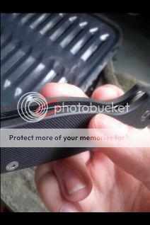

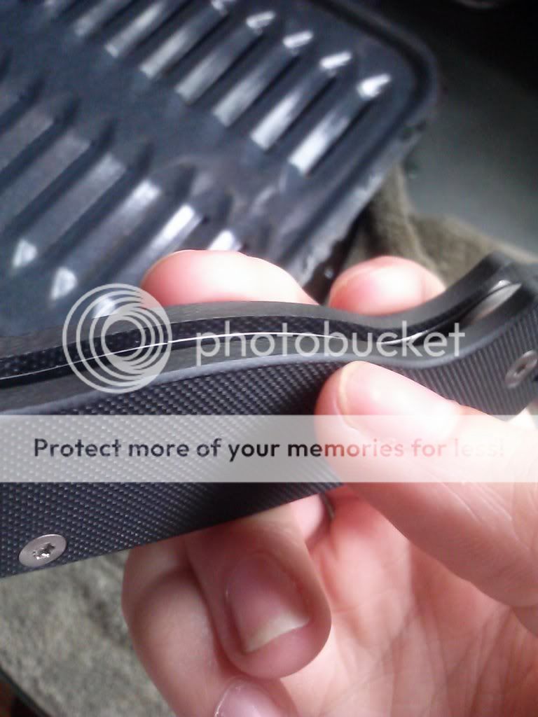

I just recently got a Paramilitary 2, everything about it is great, but I did notice something strange. Has anyone else seen these notches in the handle liners? It looks like it was cut with a water jet or whatever they use to mill out the handles, but I don't know what its function is, if any. They are on both sides, but they aren't straight across from each other. Has anyone else noticed these little notches?
Sorry if the photos aren't too great. Was dealing with some bad lighting.
Yep. Well documented. Most likely where the water jet cutting started and stopped. Totally normal. :thumbup:
They use the laser to get the profile of the blade and liners, then clean them up on a mill. Reaming holes and machining the ramp for the compression lock to engage.
That part is called a tactical notch, it's function is being a notch in tactical form. ;)
All 20+ of mine have it too.
Laser is way cheaper (faster) than waterjet and usually yields better results. I'm a design engineer and only use a waterjet when it's really thick steel (over 1/2") or aluminum because it requires special optics to cut on a laser.
We have a Mazak laser at our shop and I've thought about these marks a bit. The "notches" are where the steel has essentially been cut twice: once when the beam entered the profile and once when it leaves. The outer .01"-.02" of steel is heated well above it's upper critical tempature and impurities are able to enter the steel matrix. Lasers require quite pure steel and very pure gasses to make a clean cut. Since the steel is allowed to absorb impurities at the cut, a second pass will be cutting impure stel. The only way to prevent these marks is to add a tab to your geometry and put your start point on the tab. The tab must then be ground off after. This obviously adds a significant amount of time to the process than just picking pieces out of the sheet of steel.

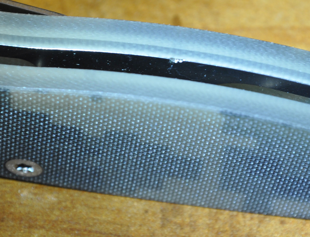

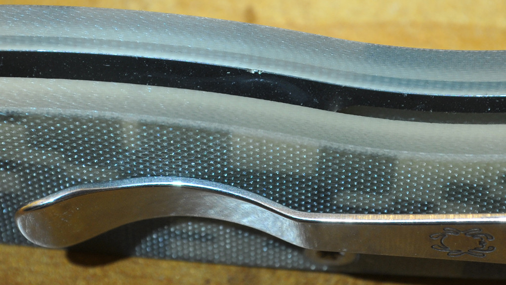

The liners on the PM2 have a definite "bumpy" surface, any idea as to if this is normal on laser cutters?
I've seen all types of finishes straight from laser cutting, just wondering if the difference is in the machines?
The bumpy surface is what made me believe that it was water jet. I thought a laser would more or less melt the steel, rather than blasting it like a water jet does. The notches I photographed seem rough in texture, not smooth. Does a laser create a rough surface?
