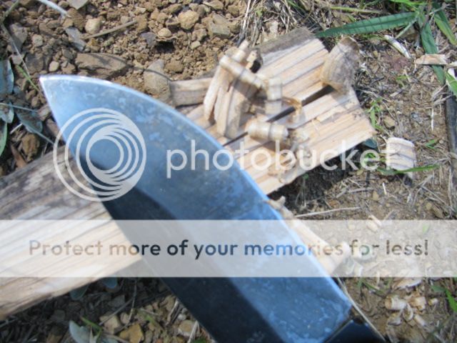

So I'm modding my 9. I'm thinkin about a mustard finish. Does anybody have any picture examples of this on the 1095 or some how to tips? Thanks!
This is the only picture of a mustard patina I have. It's with regular old yellow mustard, not a brown dijon or anything. Basically just smeared it on at random and let it sit for a while.
I didn't really care for the way it came out, but I did a apple cider vinegar over top of it last night and I like it a lot. I've seen other ones I like but maybe they used brown mustard or something.
Thrill is right they do wear off rather quick. I've noticed ones that are put on through more 'natural' use stick around for a bit longer, when I took my BK-14 camping I used it to cut up tri-tip and bacon for different meals and it still has that patina, but I have put on many forced ones with mustard, sriracha, vinegar, etc. and they start rubbing off with use just as fast as the factory black coating.

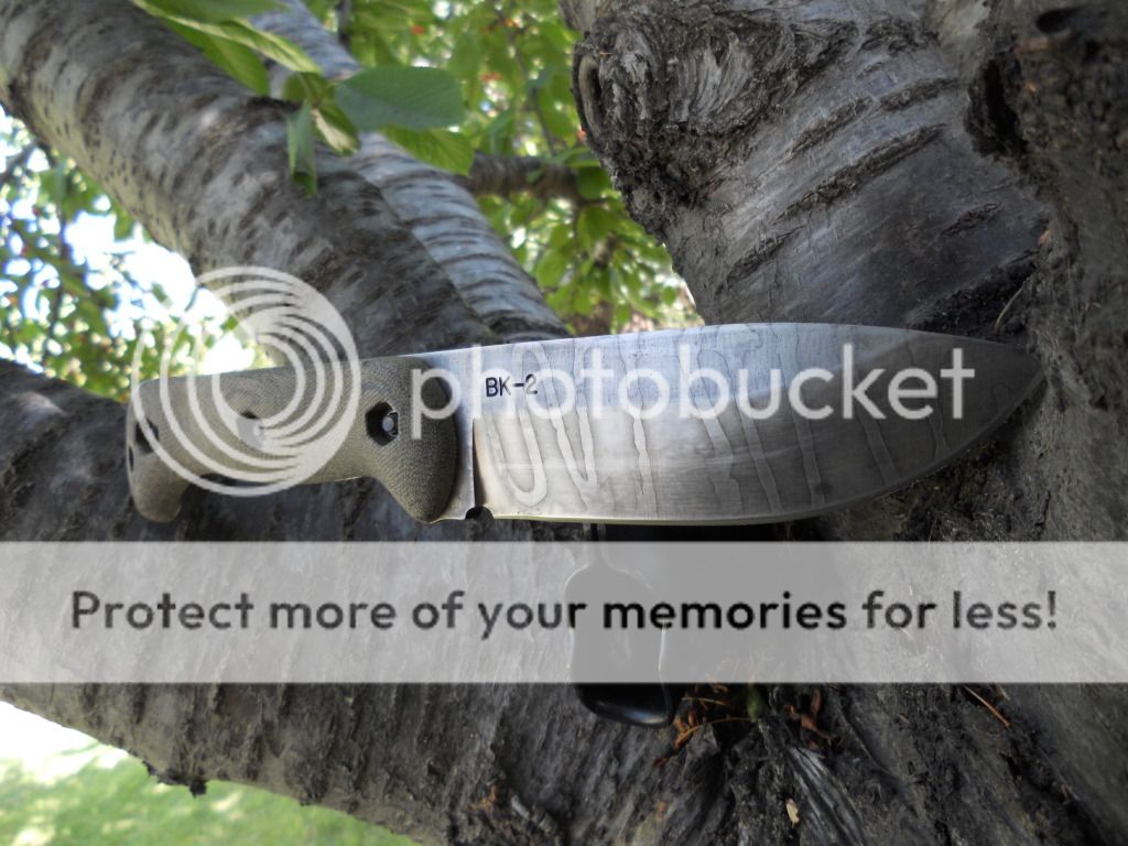

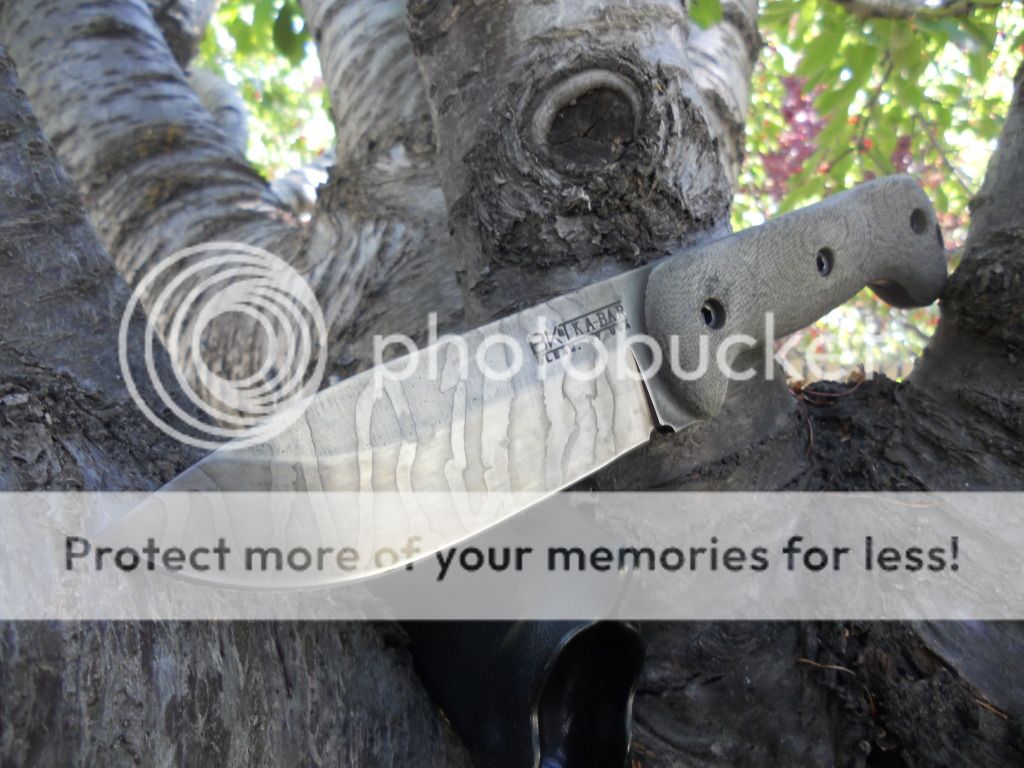

Here's my 2 with a mustard patina.
To get that finish, I covered it in A-1 sauce for a base coat and set it on a cookie sheet standing on it's spine for an hour. Then I cleaned it off and applied some spicy brown mustard in a pattern and let it sit for an hour on each side. It turned out okay, but I messed up the pattern a little. I've been thinking of changing it, which is easily done with some 600 grit sandpaper. The patina hold up pretty well, although it shows scratches easier than a blue/bleach etch, and if you don't like how it turns out, you can always try again.
