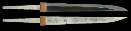

Rolf- I have to admit, I'm not up to speed on Japanese terminology, so I had to google kozuka. I actually saw one result of, "samuarai steak knife." LOL So is that kind of what you're talking about? A pic of a kozuka like you're meaning would be greatly appreciated. Thanks! :)

these are kozuka
this is a kogatana or small utility knife found in the saya of a katana.
the kozuka is the handle for the kogatana.

Bill- Thank you for the photos.
Nick- I was thinking something more like a Hartsfield or Leu style kozuka but with a wood handle. Go take a look, please.
