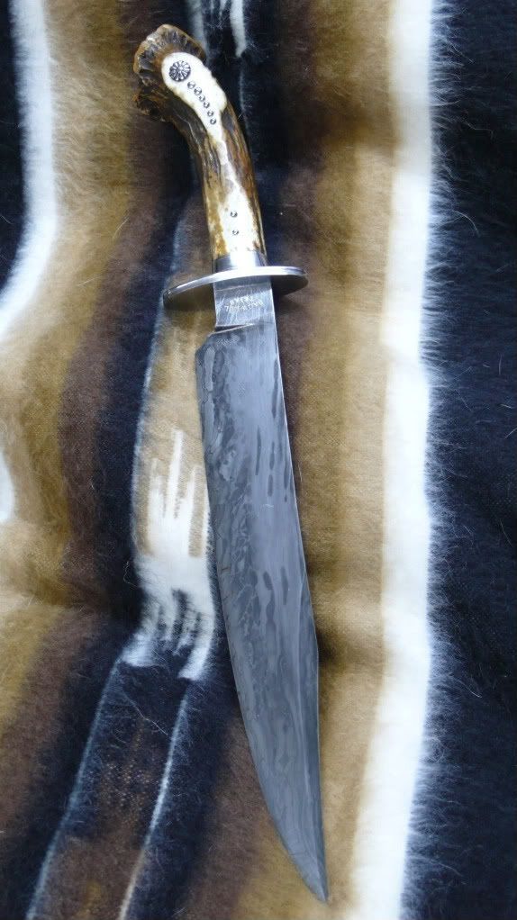

The finest Bowie’s in the world are stick tangs
A full tang Bowie unless it is a tapered tang is a camp knife and not in the same world as its peers
When people think/thought of Jim Bowie, they don't think of him the same way they do Daniel Boone, or even Davey Crockett. The latter were proper outdoorsmen, and known survivalists of the time. Bowie was a fighter, and by all accounts, a mean, tough, SOB. People looking for a 'Bowie" knife were fascinated by the fighting aspects of the various and sundry 'Bowie' designs. They weren't looking for a camp knife. In MY opinion, had the Respect been available in 1830, they'd have sold them by the trainloads.
I agree
A modern fighting Bowie has nothing to do with a camp knife
It’s all about balance weight and feel

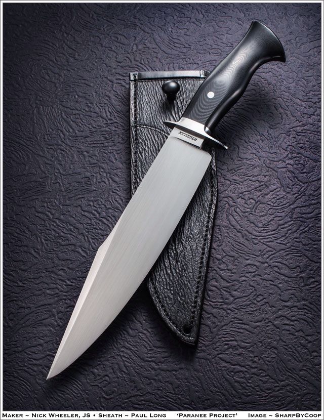

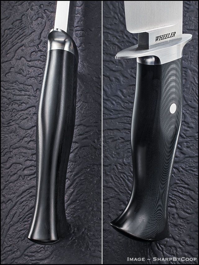

Two of the finest performance Bowie’s on the planet
Both stick tangs
Bagwell
Wheeler
Bagwell proved long ago a Stick tang Bowie can be plenty Strong
