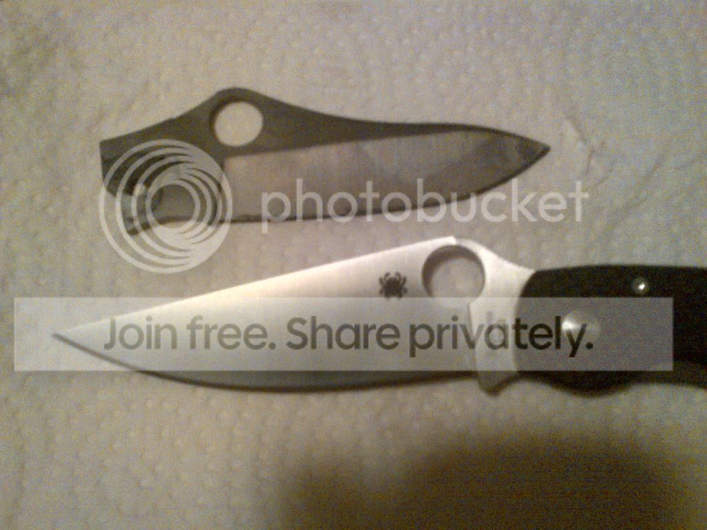

At this point in time I took a quick picture on my cell phone for color reference, here it is next to a regular blade, they looked the same before the GB's vinegar bath.

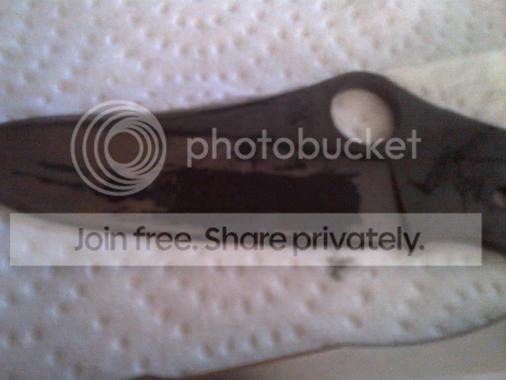

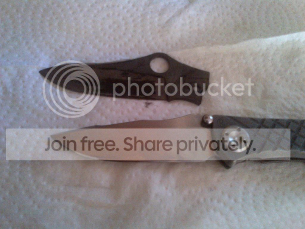

The next morning is when something puzzling occurred, I removed the blade from the Pepsi and it looked slightly darker, but when handling it my fingernail 'scratched' the blade and left a black mark. It was like I was scratching silver paint off an underlying black surface. I scratched my fingernail vigorously across the entire blade to see what would come off, and the result can be seen here (with another blade for comparison):
I couldn't get any more of the 'silver' to come off so I put in back in the Pepsi bath. This morning was about 48 hours later and the blade looks the same:
Can anyone explain to me what's going on? Maybe this is a normal or uncommon but well known result? I have no experience with non-stainless blades and patina outside of seeing pictures online and the events above.

Sorry for the cellphone pictures, I'll get a better picture of the current condition of the blade tonight after work (I put it back in the Pepsi for now).
Well it's uglier than homemade soap but likely no worse for the wear. Looks like the blade blackened like crazy with a top layer of oxidation that can be scraped, rubbed off. You'll get a seasoned patina pro that can give more advise I'm sure.
Any chance the GB had some sort of oil, lacquer, wax, or other light ant-corrosion coating? That would explain why the part you scratched got darker afterwards.

Ok, so the blade is cpm-m4? The blade most likely had a layer of oil because since its not a SS blade and its a carbon steel. The oil might have come off and like RetiredGuns said created an oxidation by seeping under the coating and creating that so the coating was "floating" on the oxidation. the reason it smells like "pennies" is because the patina is a fancy word for rust. I dont know why it smells like vomit though.
This is just my guess on what happend.
I'd get some mothers wheel polish or flitz and polish the hell out of it until it has a uniform appearance, then use some hot water and soap to remove any polish and oils...then you'll be free to try the patina again with a prepped surface if you want.
