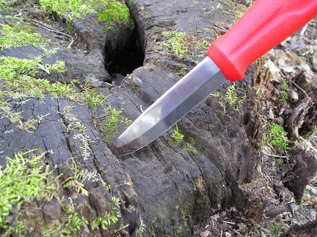

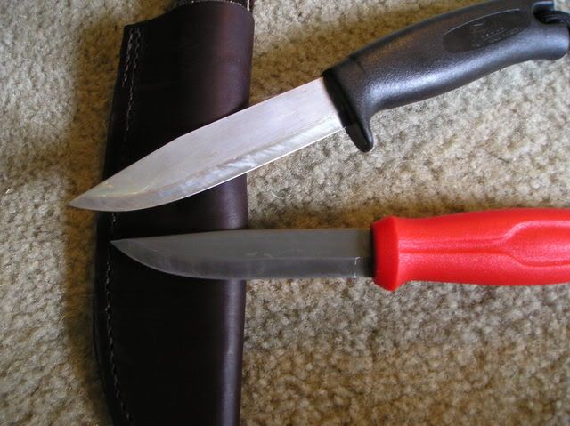

Hello all-
I had read once or twice on here that a patina could be added to a carbon blade by using something acidic. I didn't know how acidic it would have to be for it to work (or how long it would take), so I just took the plunge and put my Mora 510 into a glass of lemon juice. I left it in for around 45 minutes (frankly, I forgot about it and left it longer than I meant to).
I was hugely surprised to see how dark the steel had become after removing it! i really like how it looks right now. I rinsed it well, then sprayed some WD-40 to displace any water/acid and wiped it off as well. Here are some before & after pics, with a Triflex Craftsman for comparison:
This was a fun and very simple way to add some character to what is probably my favorite blade. I would definitely recommend it to others. I will also be monitoring the patina for any changes over time, and making sure there is no change in the corrosion (or lack thereof) on the blade.
