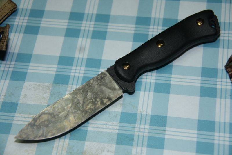

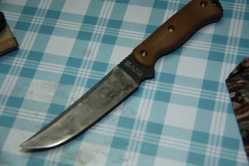

These were done with vinegar soaked toilet paper applied with rusty steel wool then left to dry. The wrinkles from the paper leave a cool pattern...
BK12
Bk16

All were given a final go over with 0000 steel wool soaked in mineral oil, a baking soda and warm water wash, soap and warm water wash, then a final coat of mineral oil.
Hi - I'm not sure what you meant by "applied with rusty steel wool"? Would you mind explaining that a bit more to me?
Thanks in advance,
Steve.
I lay a piece of toilet paper on the Blade, then use a price of rusty steel wool dipped in vinegar to dab the vinegar onto the toilet paper. It sticks to the blade. Then I let it dry and peel it off leaving a cool pattern. Dunno if rusty wool makes a diff, its just what was handy, I can't help but think the rust added a bit of color esp if you look closely at the BK12
