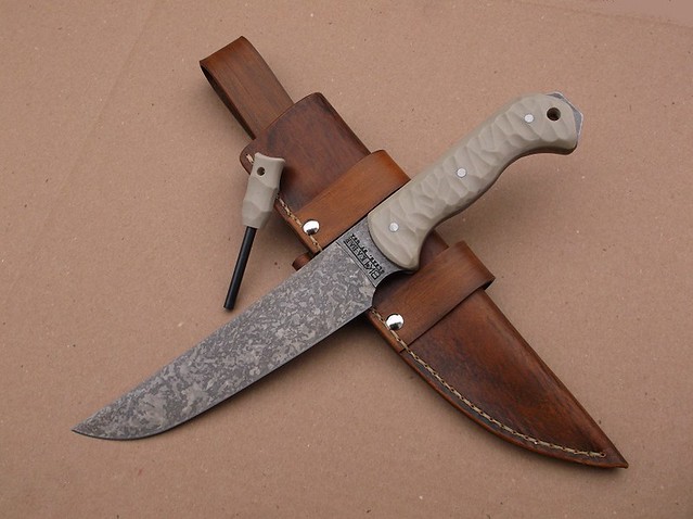

Does anyone know how to get the pattern for this bk7? I think it looks pretty cool myself.
Or the patina on this bk5? I'd really like to put this one on one of my knives.
P.S.: Anyone know how the scales for the bk5 were done?

Looks like the Bk12 (not a 7) was done with a paper towel soaked in vinegar. Essientially wrap the knife in any paper towel soaked in vinegar and the design of the towel will semi transfer... while the 5 probably was just done with mustard. Just experiment my friend. Patinas are not permanent and if you have a set design its going to change over time as the knife is subjected to use. Best way to get a patina? Use the blade. Everywhere you can. Cut all your food with it, do all your out door tasks with it. Everything. Over time it will develop its own character which is very cool. BTW those scales look like sculpted G10. Probably were a custom job.
