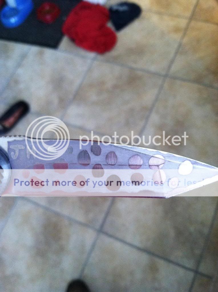

I use PCB etchant (ferric chloride) from Radioshack. 16oz for $12. Tutorials at this link. http://m.youtube.com/watch?v=Zs3JvnS4sr8
Keep in mind the acid is temp sensitive. Lower temps equal longer etch times. I heat the acid in the bottle to 90 degrees in warm water. DO NOT overheat ferric chloride. Produces caustic vapors. I use ferric chloride for stainless because it is cery forgiving...takes approx an hour to do a decent etch.
This is 440c stainless after 25 min. Only etched several thousandths.
I really recommend testing on a knife you hate with the same blade alloy as the ones you want etched. Also, I have better results using clear fingernail hardener than i do fingernail polish. Hope this helps.
