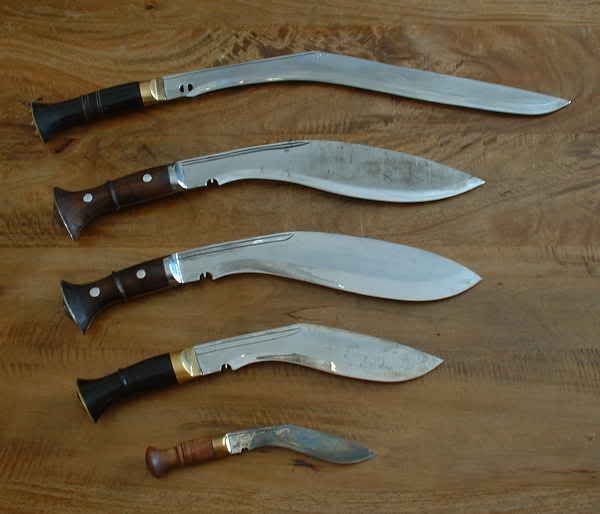

Samsher (top), Bonecutter etched with FeCl (bottom):
Kitchen use is a good way to "earn" the patina, though it can take a while. My Bilton on the bottom here was used for food prep for several weeks:
Here is my Tirtha WWII with a vinegar patina. I tried mustard, but it wouldn't take. The vinegar worked well and fast. Take care.
