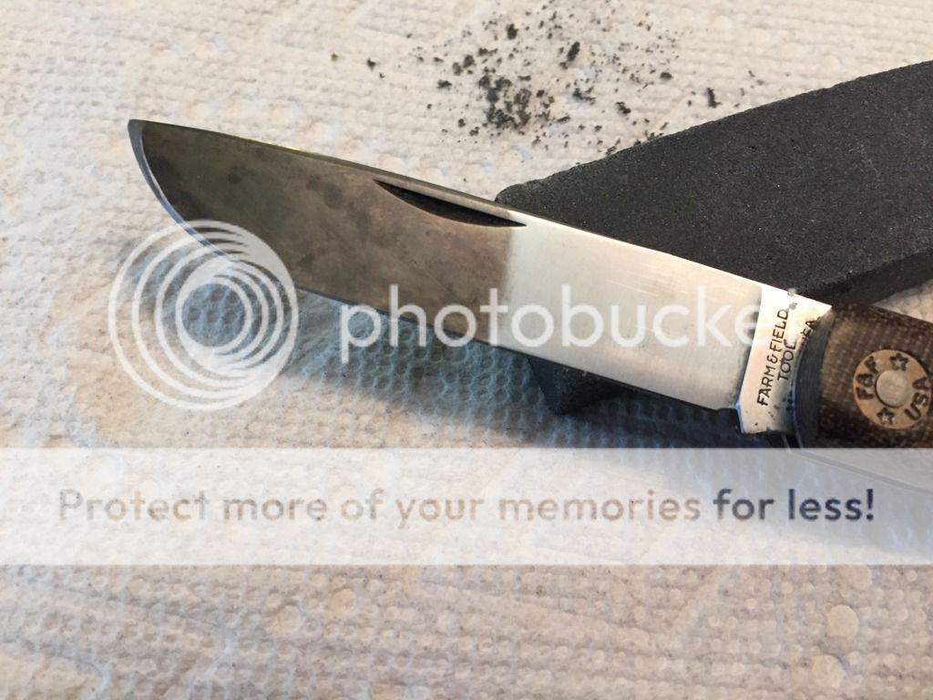

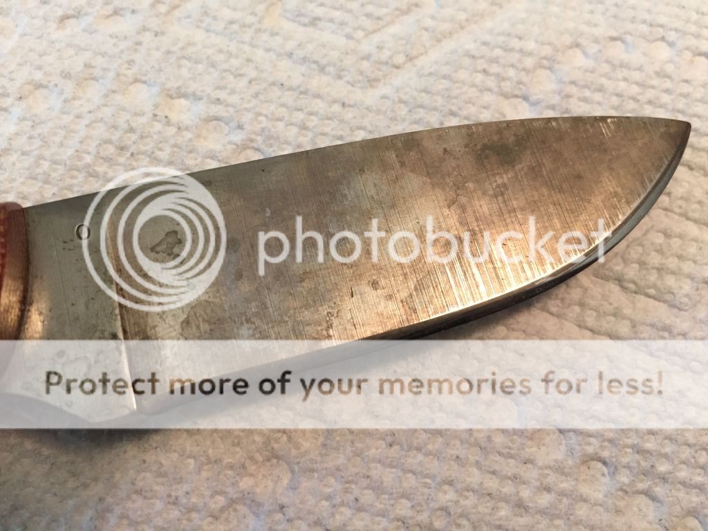

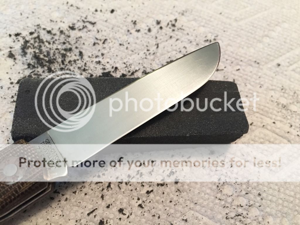

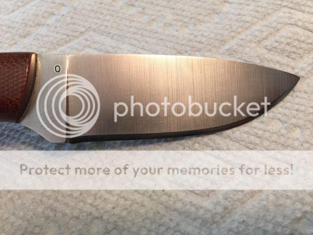

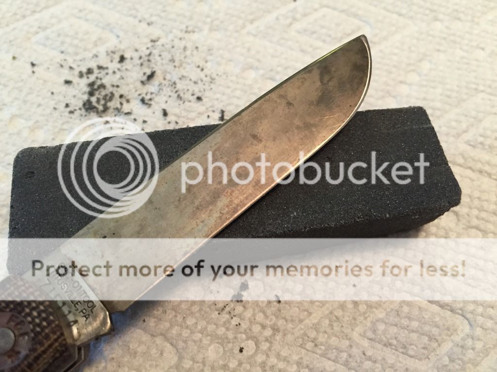

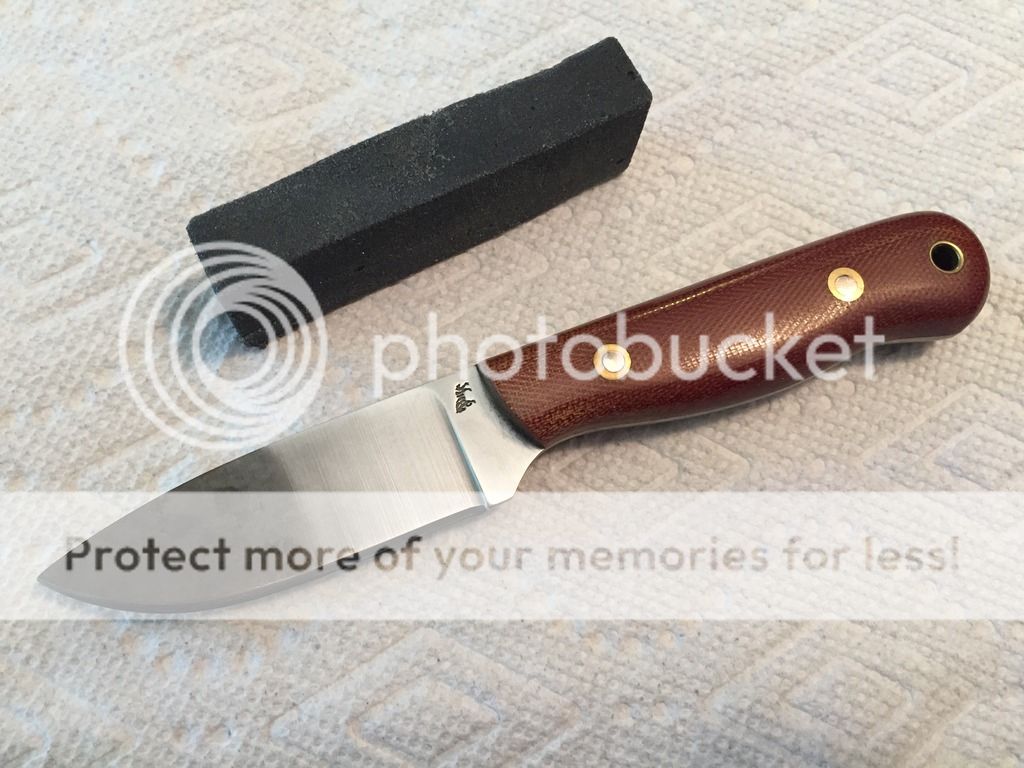

I've had good luck with the "super eraser". Its a soft block that isn't abrasive enough to scratch your blades. Works great on blades, liners, back springs, bolsters, etc.
I received this BHK O1 fixed blade and GEC 71 Bullnose O1 last week. Both knives had heavy patina and the eraser made quick work bringing them back to life.
do you use that with anything applied? like Flitz? or just the rust eraser alone
I use it dry without any compound. I did try it with mothers mag on a really tough 1095 patina but the results didn't change. I've actually never used flitz but heard enough rave reviews to order some this morning.

Looks like that eraser works pretty well. (I will say, though, the patina on that #71 looked pretty great. Kind of a shame to see it go. :( ;))
Awesome results! I will definitely be picking one of these up. Thanks Terry

I don't believe any forum sponsors sell the product so I can't say in open forum per the rules. They run about $7 on a website named after the largest river in South America. [emoji6]
