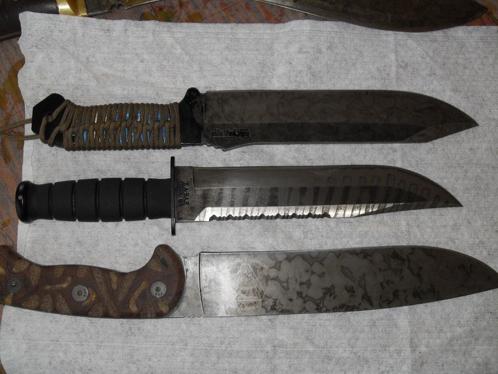

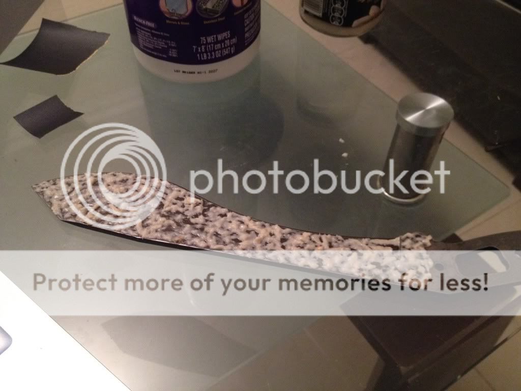

I used horseradish on this one.
Spread it on pretty thin, let sit for 30 min.
Nice Job,, Not bad for only 30 minutes.. I might have to try that with a UVG I recently bought. Strip it, then go for a nice patina..

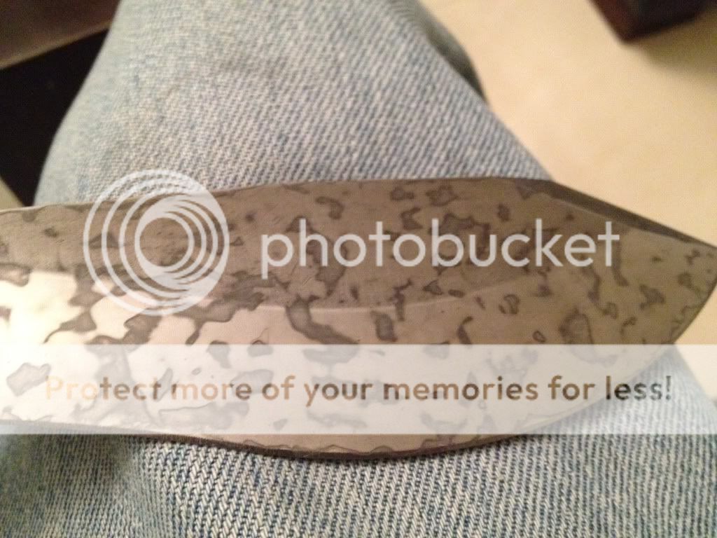

I used a paper towel and soaked it with vinegar, left it for an hour or so on my 16.5" Villager CAK.
Before:
After:
Thanks!![]()
