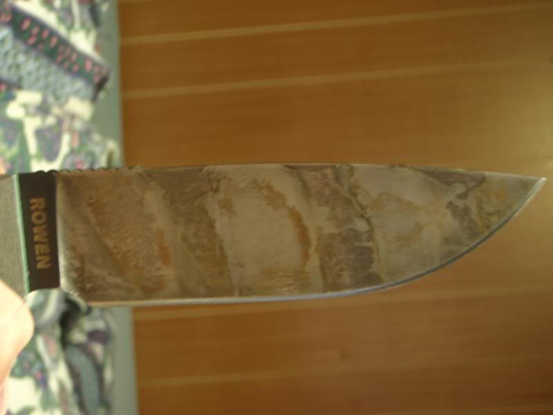

Anyways, a Patina is a light coating of rust (not red rust, red = bad) that protects the steel from further corrosion. This only applies to carbon steels however (althought some stainless can form a patina, it will take a MUCH longer time to do so)
The funky patterns you see are what we call a "forced" patina. Normally, using carbon steel and keeping it clean over time will allow it to develop a natural and more permanent patina. A forced one however, can be achieved by exposing the carbon steel to anything acidic, such as: Cutting lemons/limes, vinegar, mustard etc... By drawing on the specific acidic material in a different way can allow you to achieve a different affect.
The main difference is, a natural patina will be harder to wear off, and a forced one is usually easily removed with a scotchbrite pad or high-grit sandpaper.
Here is a picture of my RC-4 that I sanded the blade finish off and got this patina effect by soaking a paper towel in vinegar and wrapping it around the blade several times.
In the end it comes down to personal preference. Having a coated blade will ensure it won't rust... but a smoothly sanded and patina'ed blade may rust but has better slicing ability... <-- because of the lower friction. Plus you can make your blade 100% unique!
