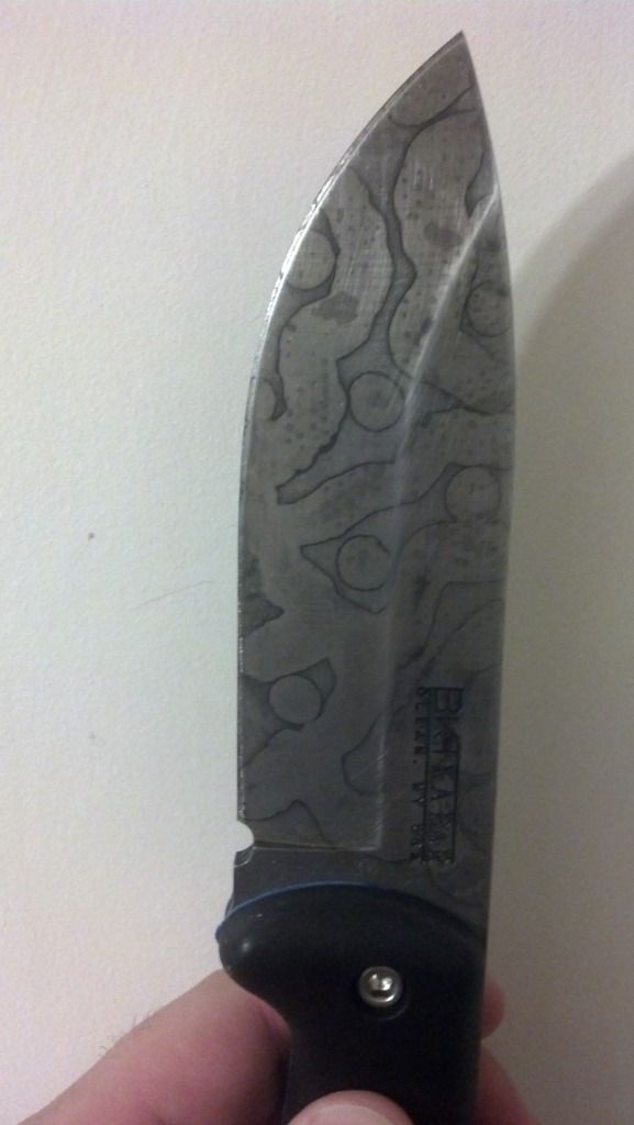

hey everyone im new here i just signed up a few moments ago, and i wanted to first say hello to everyone here. ive done an awful lot of reading this forum [both ka-bar and becker sub-forums] and i have seen a trend concerning forced patinas only covering a portion of the blade, usually in a design, which i really like alot of what i have seen and has given me a few ideas of my own for when im ready to strip my new bk2& bk11 so my question to you is why not cover the entire blade? or am i missing something?

If someone only strips/patinas a portion of the blade itself then it's purely for aesthetic reasons. For example, on my BK2 I sanded off the coating on the grind only and left the flats or upper portion of the blade coated because I though it looked cool. Doesn't serve any other purpose other than I was really bored and it sets the knife apart from most.
A lot of times you can achieve a design and still have the whole blade protected. It just takes multiple applications. On my BK2 i used mustard with a few drops of apple cider vinegar to thin it a little. I used a q-tip to apply the design and left it on for about 45 minutes. I rinsed it,dried it and did the same thing to the other side. After 45 minutes i washed it off and dried it. Then i soaked a paper towel in Apple cider vinegar and wrapped it around the blade. I left that on for 15-20minutes. I have had the same patina on it for well over a year and no issues (with very minimal maintenance). The paper towel application leaves these small dots that look like golf ball dimples. I liked it a lot.
