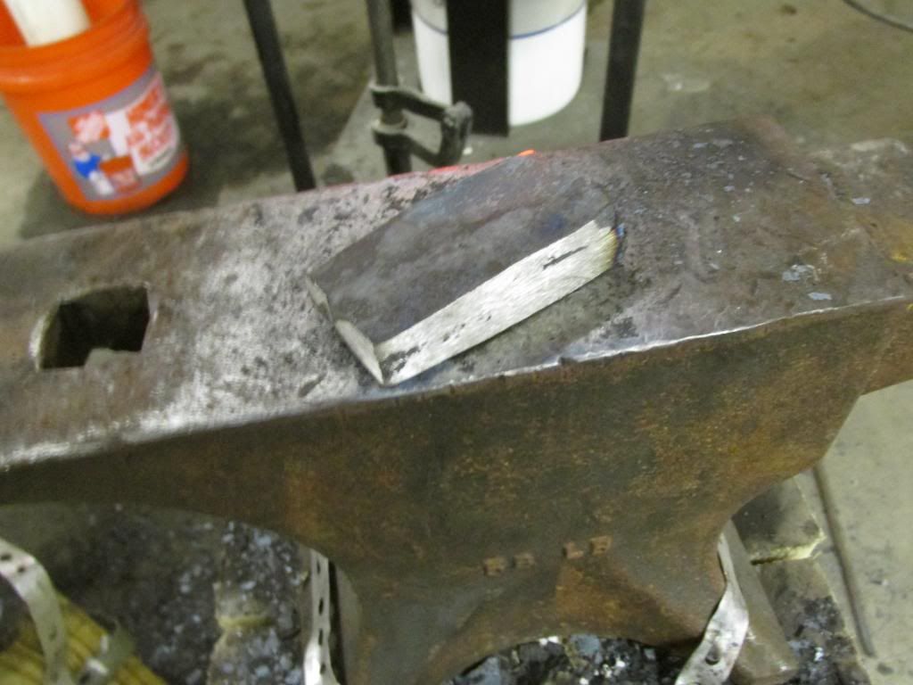

So I started out by welding a 16 layer billet of 1095 and 15N20 and flattening it to the dimensions of a bar of 1084 I had. I intended to wrap the billet around the 1084 to guarantee having a homogeneous edge since I was using such a low layer count in the edge. The dimension were about 1 1/2 inches wide by 1/4 inch thick and the 1084 was 1 1/2 inches wide by 3/16 inch thick. When folded and welded this resulted in an approximately 3/4 inch tick edge bit.
The edge bit after welding and some cleaning:

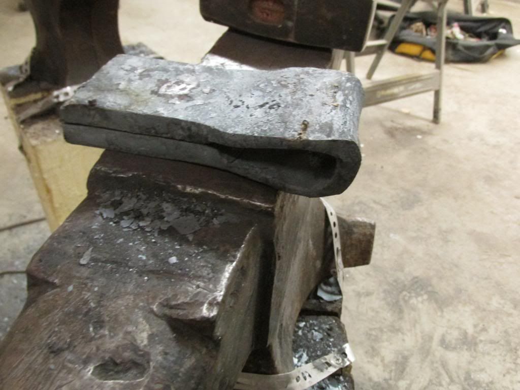

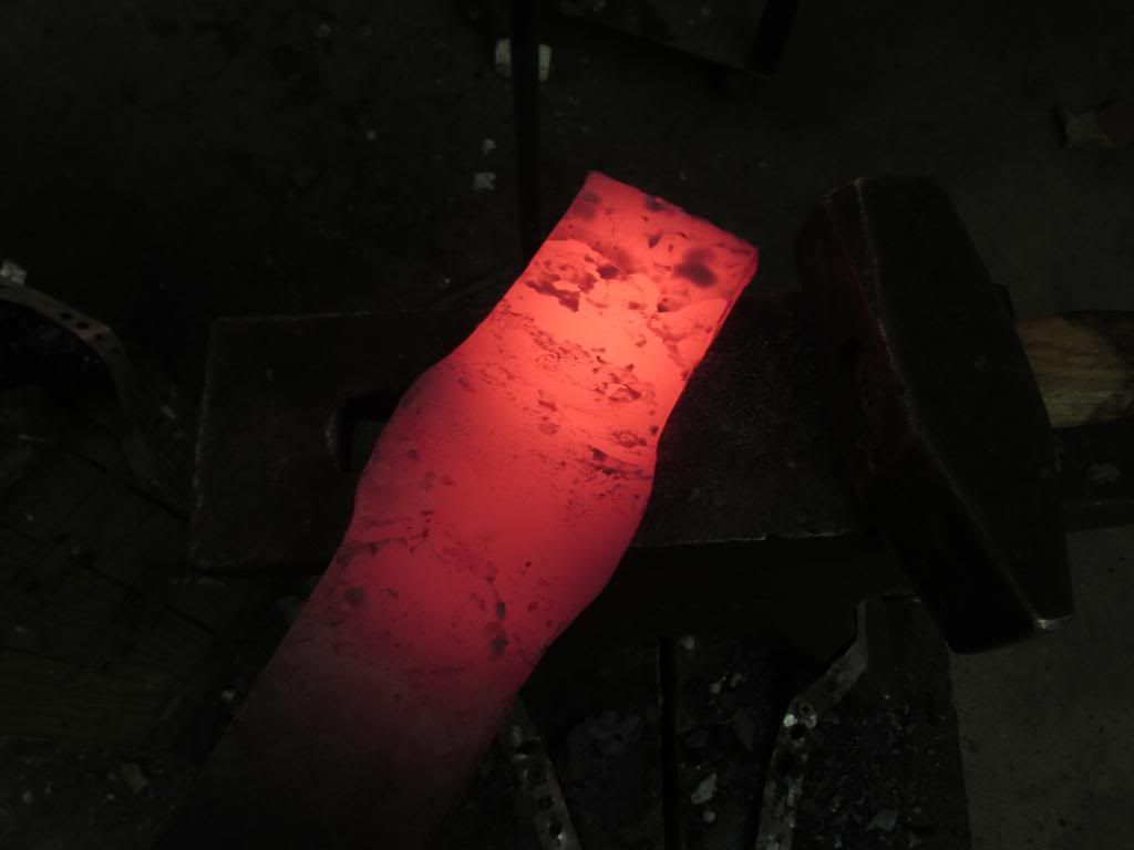

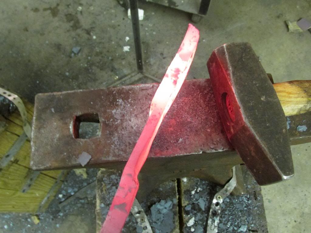

Next I started to prepare the axe head. Because it is a wrapped and welded axe I start by creating alternating steps to allow for thinner cheeks and a thicker back to the axe. The stock for this head was 1/2 inch thick by 2 inches wide mild steel.
This is then bent in half and folded on it's self. If you make the ears the same size then it should line up:
And the axe blank is then cut from the parent bar.

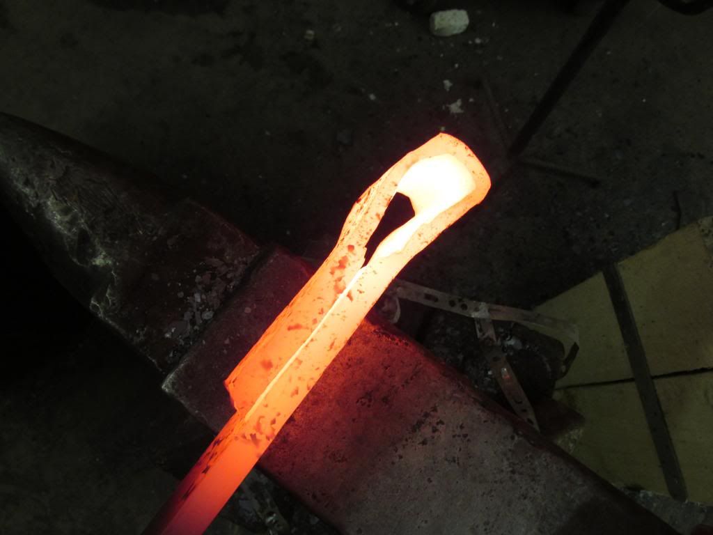

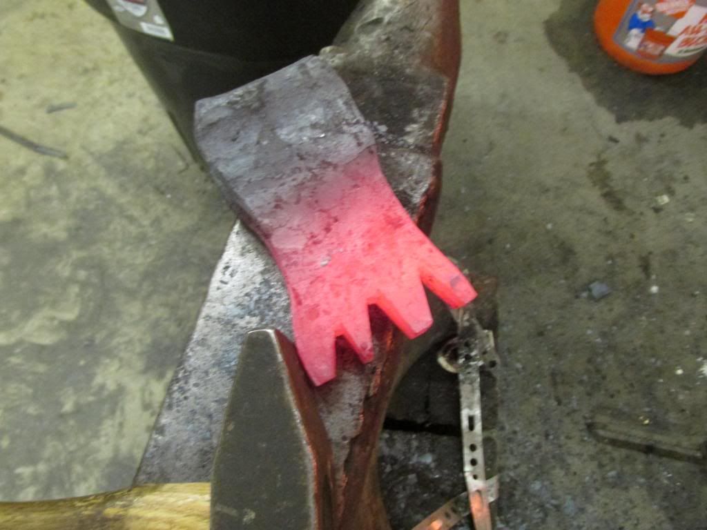

After that the teeth are cut in, this can be done with a hardy or a hot cut but I used an angle grinder for speeds sake.
Note: this is all done pre-welding so that the bit can be inserted later.
The teeth are then spread apart using a chisel.

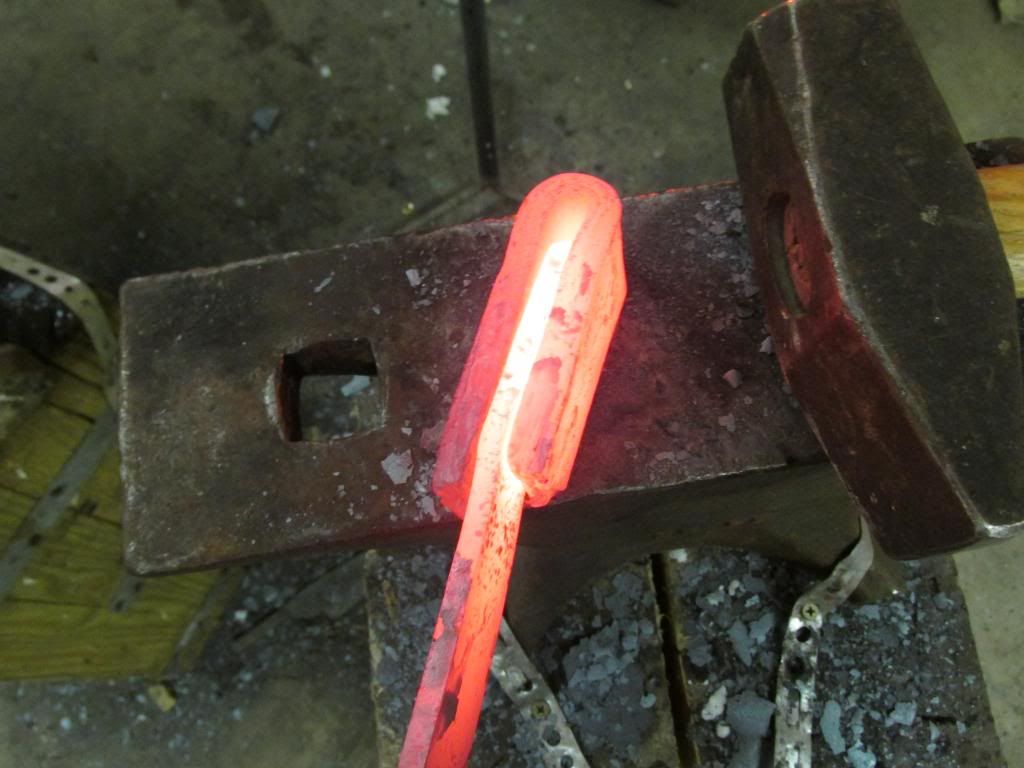

And the bit is inserted:

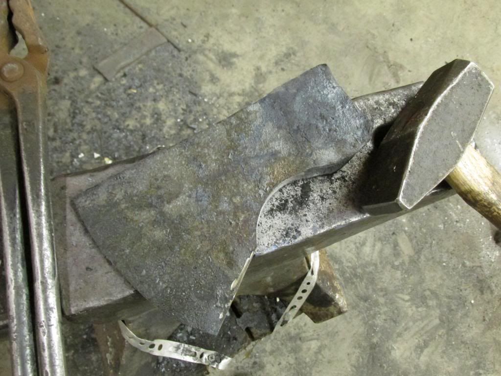

Unfortunately this was were I lost one of the teeth, but the rest went together well and the axe is spread and shaped.
http://s1304.photobucket.com/user/scottishsmith24/media/IMG_1385_zps7736a4d5.jpg.html
At this point the eye is still unshaped, I save this until the end to prevent damaging it.

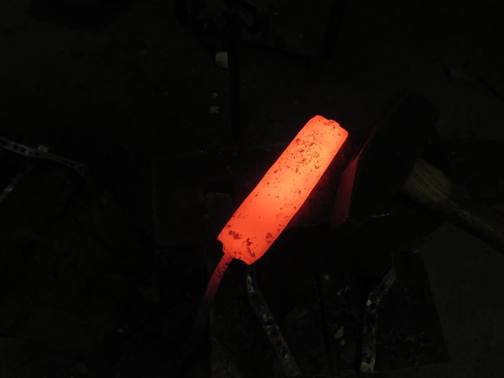

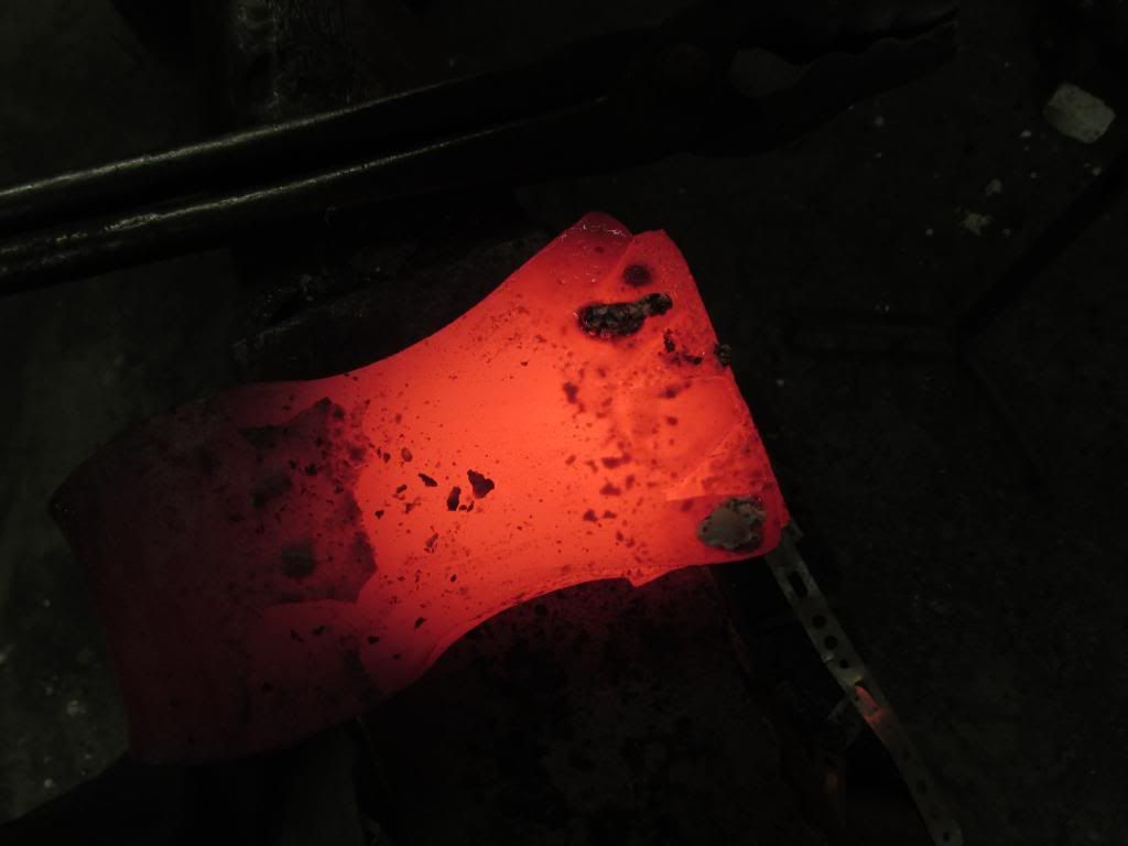

And the axe head welded and spread.
Right not the axe head is about 7 or 8 inches long with a 7 inch long edge. That will be reduced when all is trimmed to shape. Again this can be done with a hardy or hot cut, but I used a grinder as I was working by myself.
The final edge is 6 inches long.

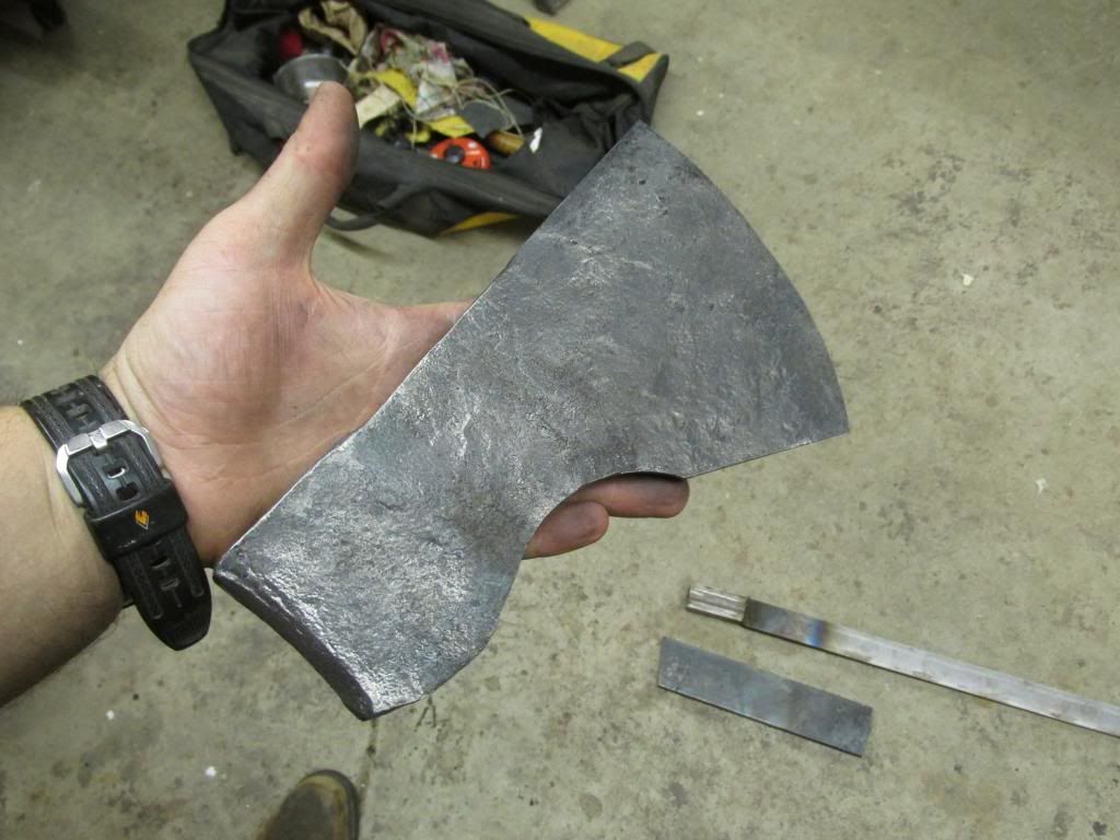

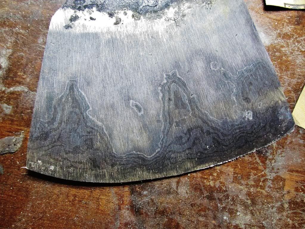

The next set of photos are of the edge at 60 grit after rough grinding and a preliminary etch...as you can see no wolf's teeth so a failure but still a cool axe. I'll just have to try again. I had to turn the contrast up to 100% to show the pattern at 60 grit but it gives you a good idea.

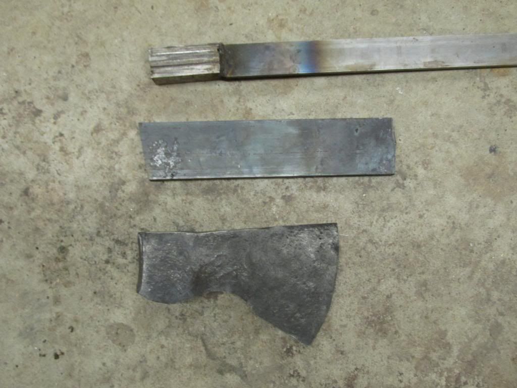

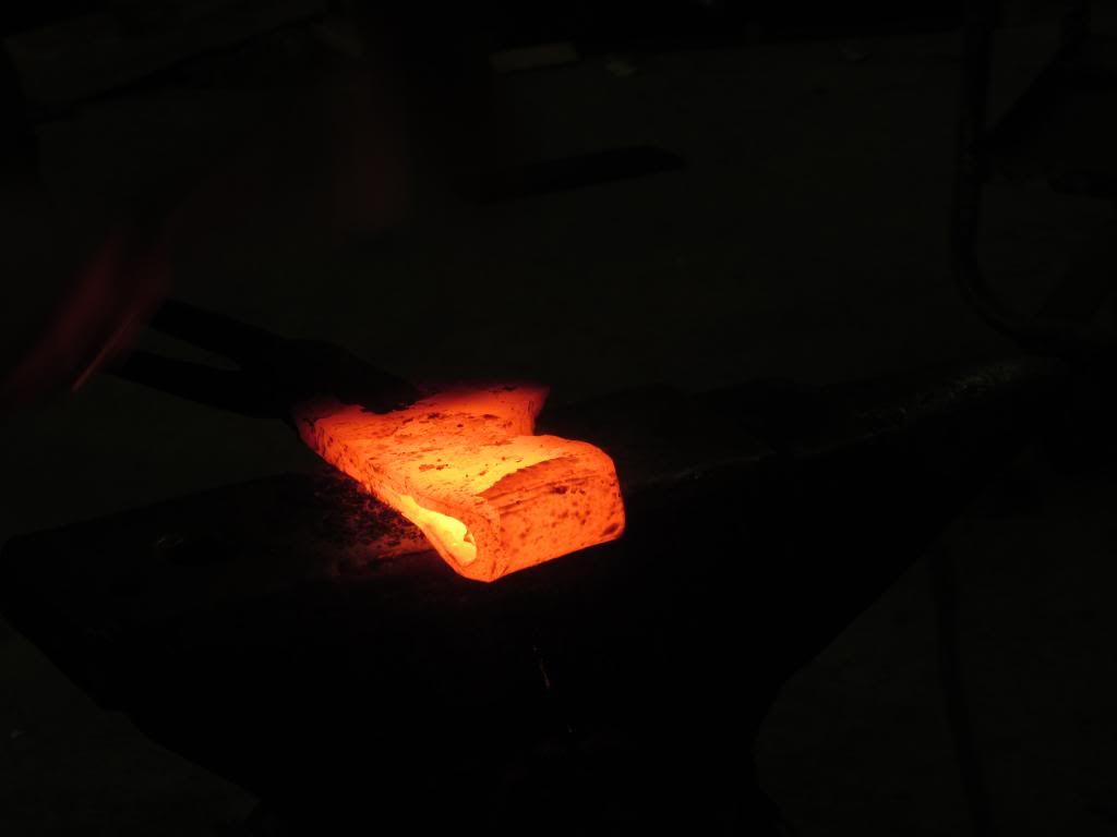

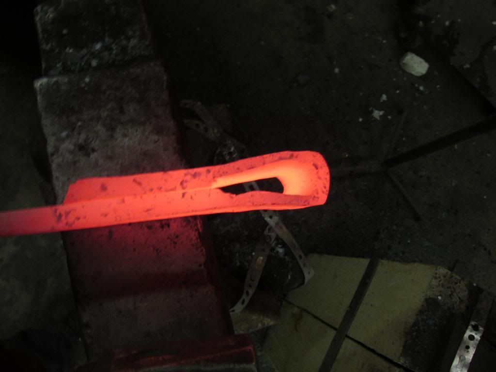

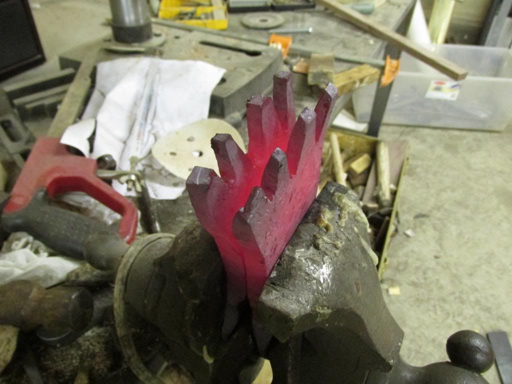

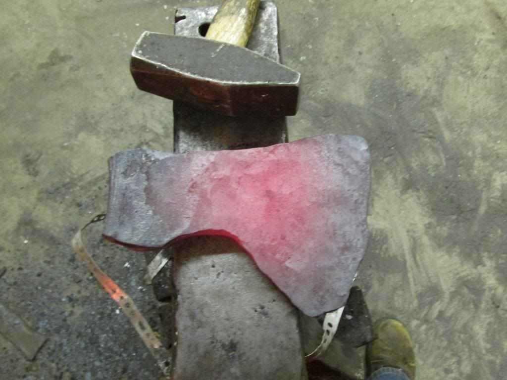

And lastly the starting materials and axe in the same photo.
And the final product:
