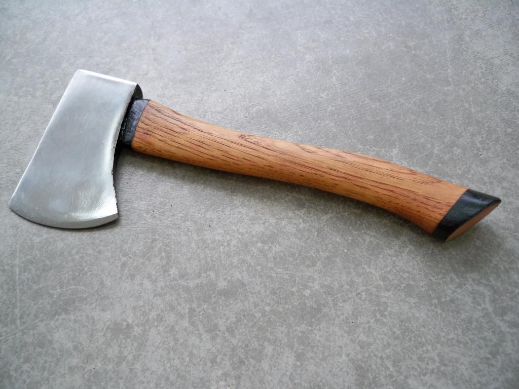

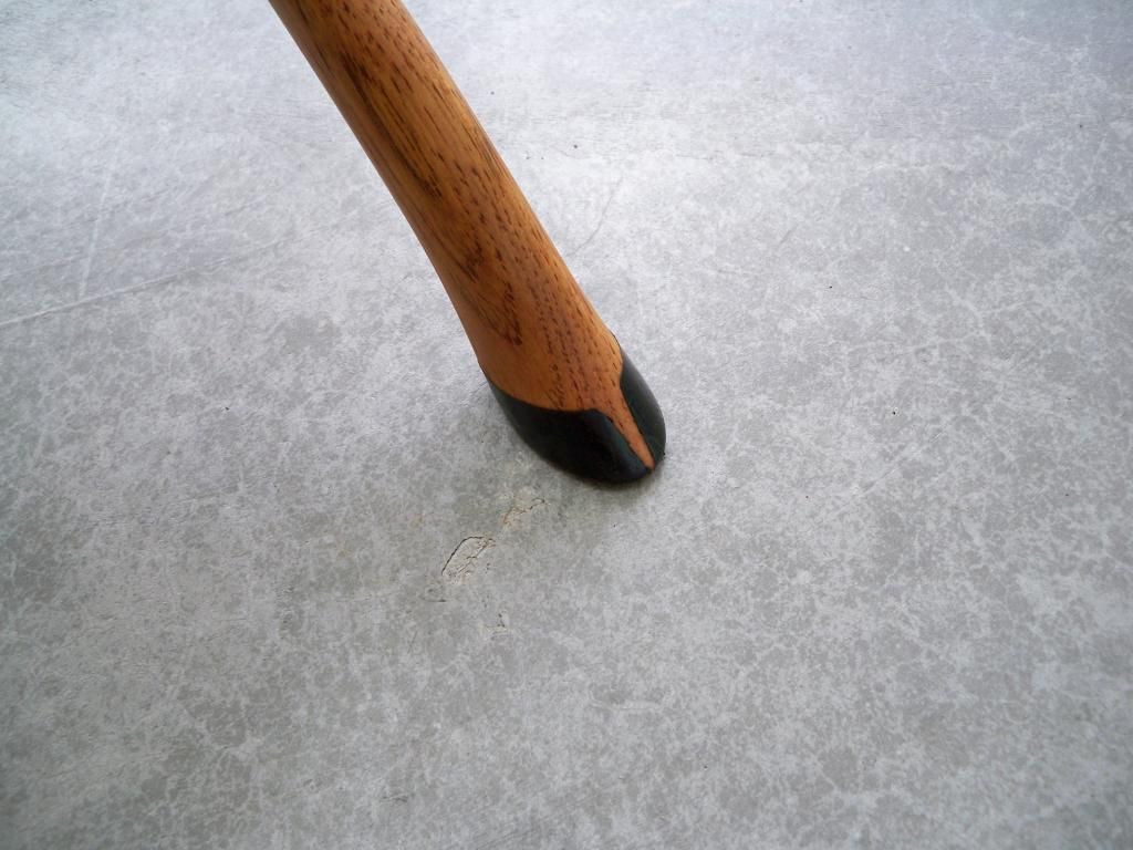

I found this little Plumb at my local pawn shop last Thursday. I put a few hours into it this weekend between assorted house and family projects, and like the results. I decided to accent the "fawn foot".

I took the paint off the head with a wire wheel on my grinder and then sanded it as smooth as I could, but next time I will do it all with sandpaper, the wheel leaves too deep of marks. I ground off the mushroom on the poll with my grinding wheel and then dressed the top and edges with a file to get it square and clean. I took a little belly out of the cheeks near the cutting edge, then filed a new bevel to a nice sharp edge. That red paint on the handle is tough stuff, it took a fair amount of sanding to get it off. I painted the black stripe on the top to hide some red that was just too much work vs reward, it was easier to cover it up. I thought I would do the "hoof" on the bottom to make it unique and I like how it turned out. I stained the rest of the handle and will put a coat of wax on to finish it off. I am pleased with the outcome, and plan on looking for abandoned heads to build on for each of my 3 adult kids. A few years back I did my own Norlund HB Cruiser that I bought just after graduation from college. The handle finally cracked, I did the same work on it and enjoyed it enough to want to do it again. It's fun to see something returned to it's former glory. I will post a picture of it one of these days.
Hi Elk,
Thank you sir for that information. You did a very nice job (love the Fawn hoove) it's very clever and artistic., I agree, it is a lot of fun returning something to it's former glory. I've only started collecting Axes/Hatches for about four weeks now and have acquired eight-ten Axes. I'm in the process of cleaning. I too have a Norlund "Saddle Cruiser" which is one of my favorites. Thanks again for the "tips" on cleaning/prep. I got to buy sandpaper (and more Steel Wool).
