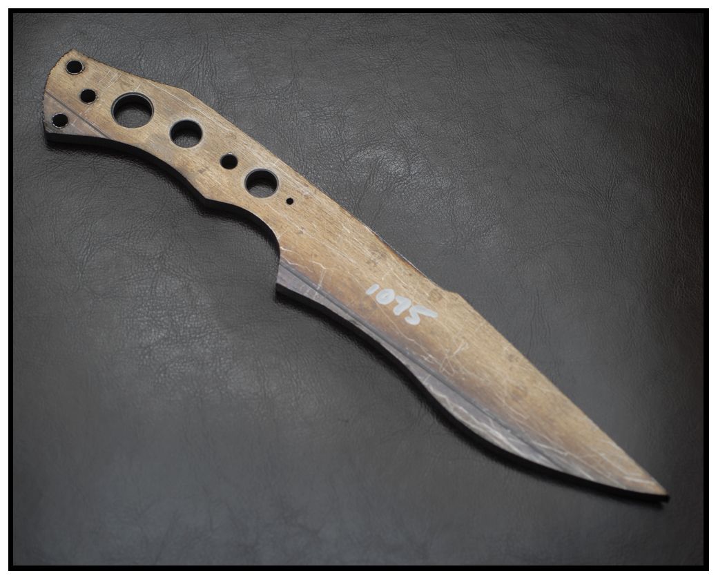

Here is the Blade Drilled and Profiled

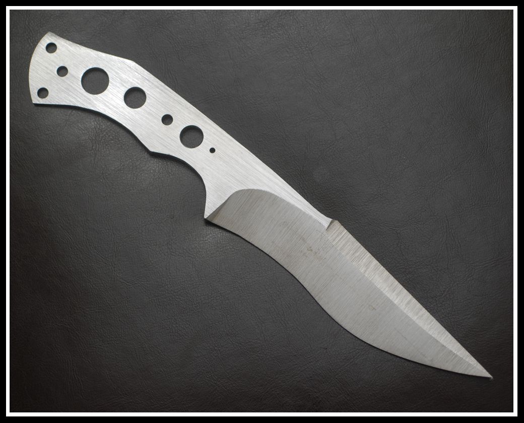

Blade is Rough Ground and Tapered the Tang

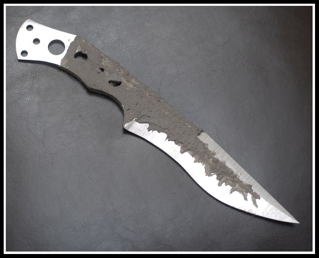

Clay Coat for Differential Heat Treat

Got the blade Machine Finished, Hand Sanded, Etched Logo and polished out the Hamon... Loving it, always worry about knives that will have a sharpened Clip getting that top edge fully hardened with Clay below it! Got Lucky :D

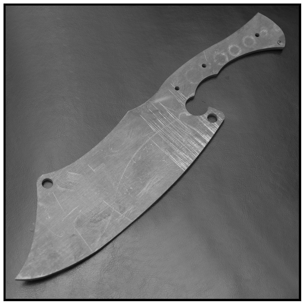

1. I had ICI (New Jersey Steel Baron) Water Jet the blank due to the difficult curves and size of the blade, They do great work! Next: I will be drilling the handle out a little more and correcting the 1/4″ Pin Holes with an #F bit (Slightly larger than .250″)

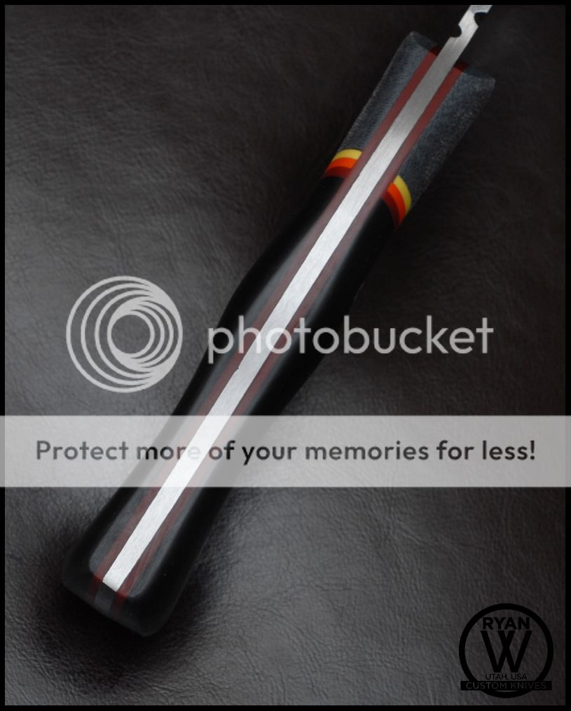

Here I have the Blade Rough Ground, Not tapering the tang on this one because I want to keep as much weight in the cleaver as possible to add to the Strike weight. That is also why I did not do the usual Skeletonizing of the handle that I usually do.

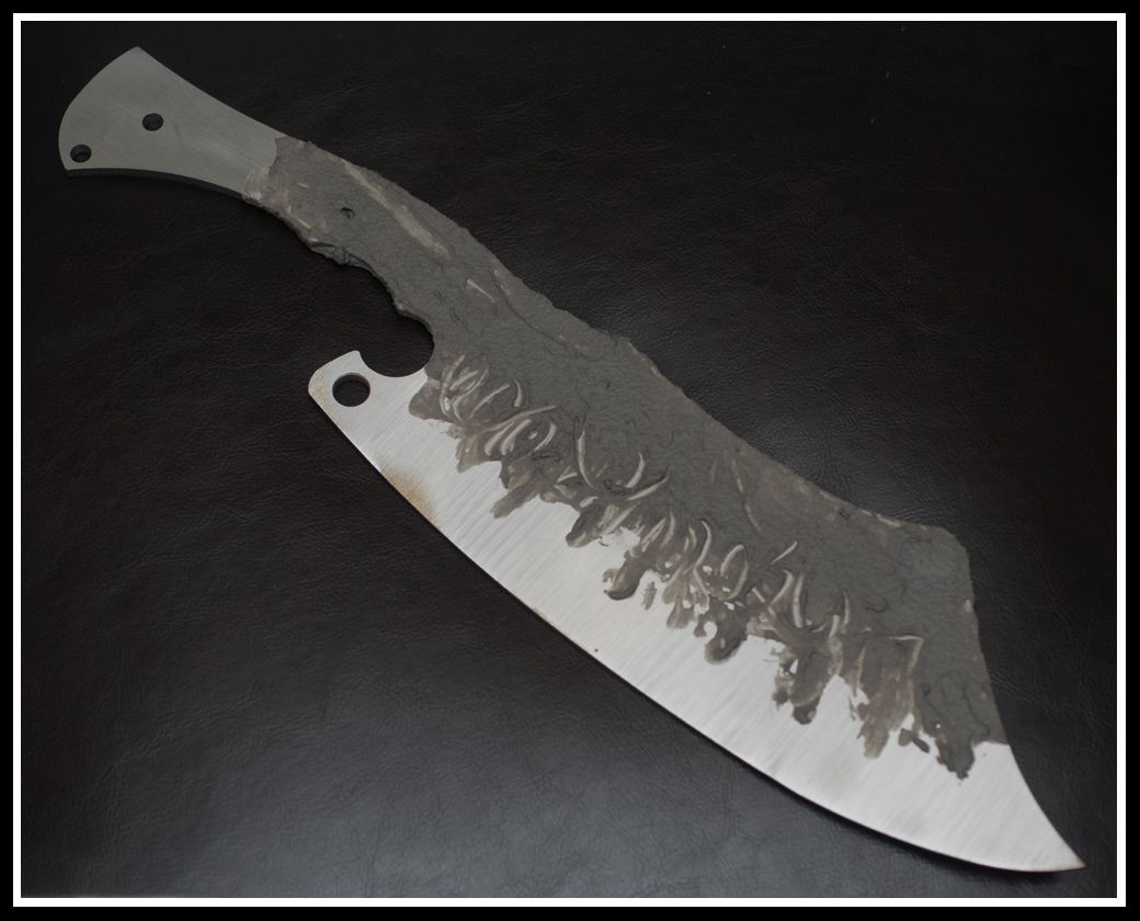

Here we have The Cleaver Clayed Up ready for Heat Treat

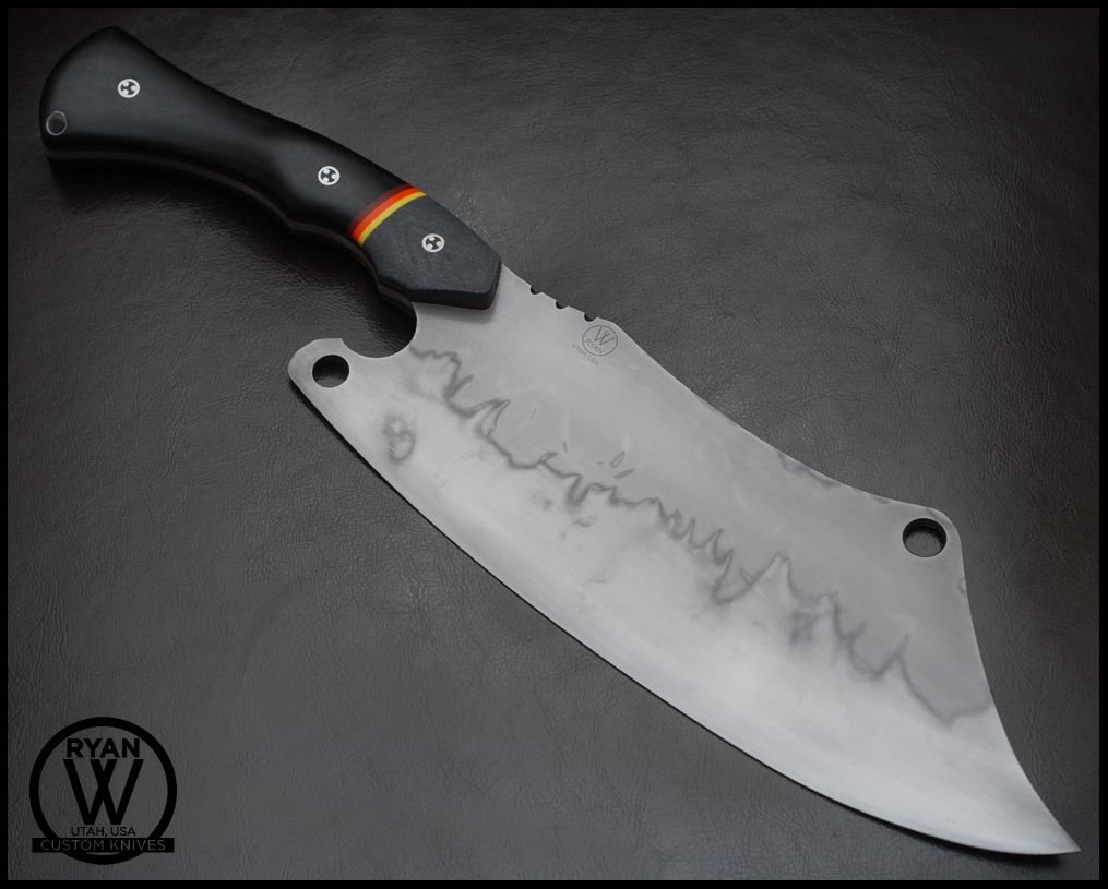

WOW... this cleaver has a lot of surface to hand sand! Spent a good portion of today hand sanding her... There is a nice hamon under there!
Here I have my Logo Etched on the blade and Polished out the Hamon
Have the Cleaver finished up and ready for David and some Kydex Magic
Still need to clean up the spine sanding a little, just wanted to show a top view

I have very little experience (none) with metallurgy, but is there a reason that you don't put clay all the way to the butt of the handle?
Thanks Cooper! I dont clay all the way to the butt because I only quench the blade and dont fully dunk it (Usually) Sometimes I clay all the way to the end.
