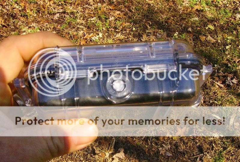

The case is a Pelican 1010 Micro Case,
It has a wide single latch that secures the case quite well, two stainless steel hinge pins, and a pressure equalization valve which I assume is for sudden or rapid changes elevation and temperature. It has thick shock absorbing foam padding in the lower section. The internal dimensions are 4.37" x 2.87" x 1.68" (11.1 x 7.3 x 4.3 cm). It is said to be “water resistant, crush proof, and dust proof”. It comes with a carabiner for attaching to a pack or belt loop, and has slots for attaching to a web sling or belt. It comes either clear with a colored liner of black, blue, red, or yellow, or you can get it in solid yellow or black. Pelican also makes an i1010 will built in retainer for your ipod or other mp3 player should you have a need for one.

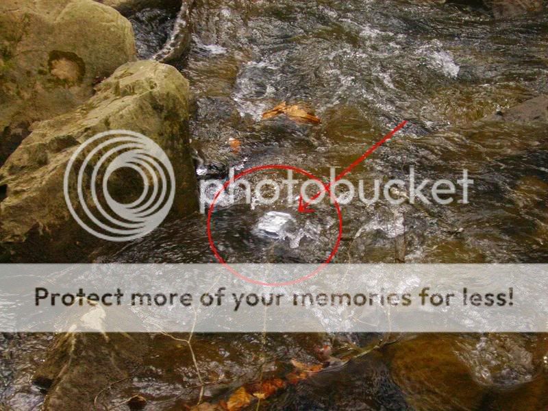

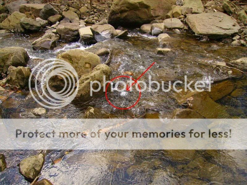

I took a cell phone (not the one I use) and placed it in the case, tied some braided line to it, and tossed it out into some small rapids in the creek and just left it there bouncing and bobbing for about 45 minutes. Actually at first I gave it too much slack and it went down into a hole between the rocks and got hung there for a few until I could get out there and push it down and pull it back out.
The hole it went in
The air and water temps were pretty cold, there was ice on some of the rocks and limbs at the top of the water that were getting splashed.
In these the arrows point at the case which spent most of it time submerged in the rapids

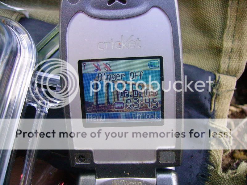

and after going from being in a warm truck, tossed out into nearly frozen water, all that time being beaten against a rock while repeatedly snatching on the string trying to free it, and bouncing submerged in rapids, this is all the water that got into a box not made for swimming or submerging. It should protect my stuff in my back pack or shoulder bag from the rain or a brief accidental dunk in a creek very well.
But the phone still works just fine, you can tell the temperature is cold by how quickly it drained the battery.
