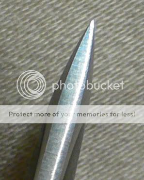

I got bored today and decided to figure out how to make a penetrator tip. I have no Busse knives with the penetrator tip but I have seen a few pictures. Don't mind the old D2 Kabar that has been used for practice many other times... I used the HF belt sander. Not sure if it is good for this and suggestions are welcome.
Anyhow, anyone do this themselves and have some pointers? I am putting this in here because I would like to add this to one of my ASH blades. It will probably be a few years before I attempt it so don't worry:D
Here is what I came up with....Not to happy with it....

I wouldn't use a belt sander if I was looking to put a penetrator tip on my blades, not until I had a lot of experience. It just removes too much metal too quickly.
I think if you used a file then that would allow you a lot more control. I imagine some sort of home made Edge Pro rig/set up. That would allow consistency to the grind and make it easier to have a symmetrical penetrator tip.

I am fairly confident I can put a symmetrical penetrator with a belt sander. I had not thought of a file though. That might be a much better idea and also give me a flat surface. I really don't think a belt sander is the right tool BTW.

I would agree that a file or a coarse diamond stone might be a more controllable way to do one yourself.

Richstag, I think that tip looks great, the edge looks nice as well.:thumbup: Do you have a spine shot?

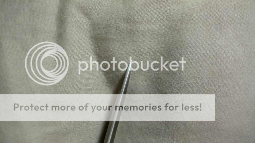

Yeah, a spine shot....about that....
I tried with my good camera earlier and could not get anything decent.
Just tried again with a point and shoot with macro setting...
This is the best I can get. Very thin spine.
Cropped

I measured out the half thickness point with a ruler (a good steel one) to get an approximate measurement, scratched that in with a pencil, then once the rough grinding was done you go a little slower and just go by eye (make sure you know what angle you want before you start. That's the kind of thing that's hard to adjust after the fact).
Don't get in the habit of looking for straight edges though, nearly all my production folders are ground uneven. Noticing it can get annoying.
Modding an uncoated blade would be better simply because it would look better. You'll notice my grind stops abruptly where the blade spine straightens out, if it were uncoated I could have gone all the way and had a nice smooth transition. the problem with doing that right now is it would leave a funny bald patch on the spine.
Also, the end product wouldn't advertise "this knife has been modified to stab things".
