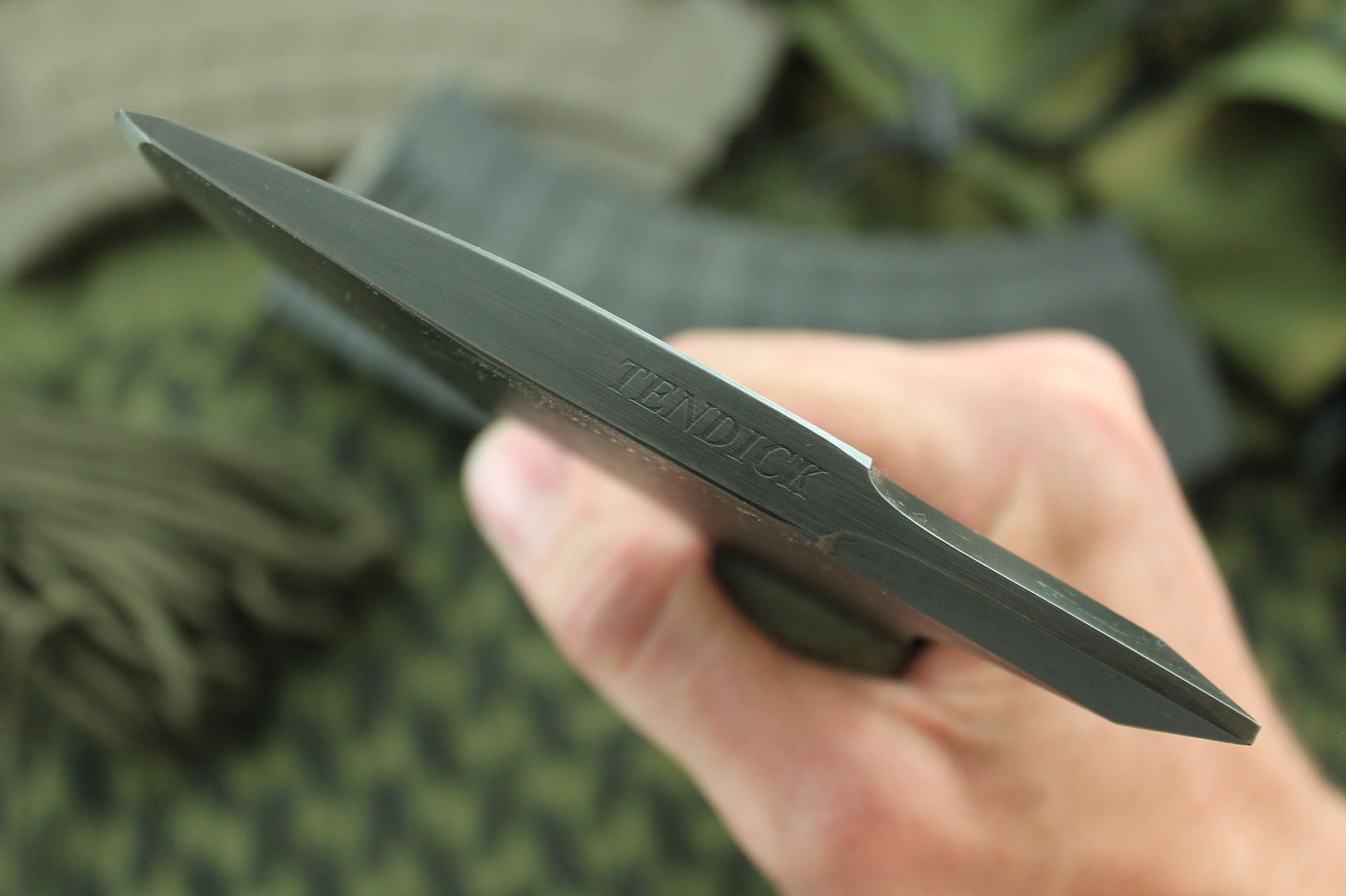

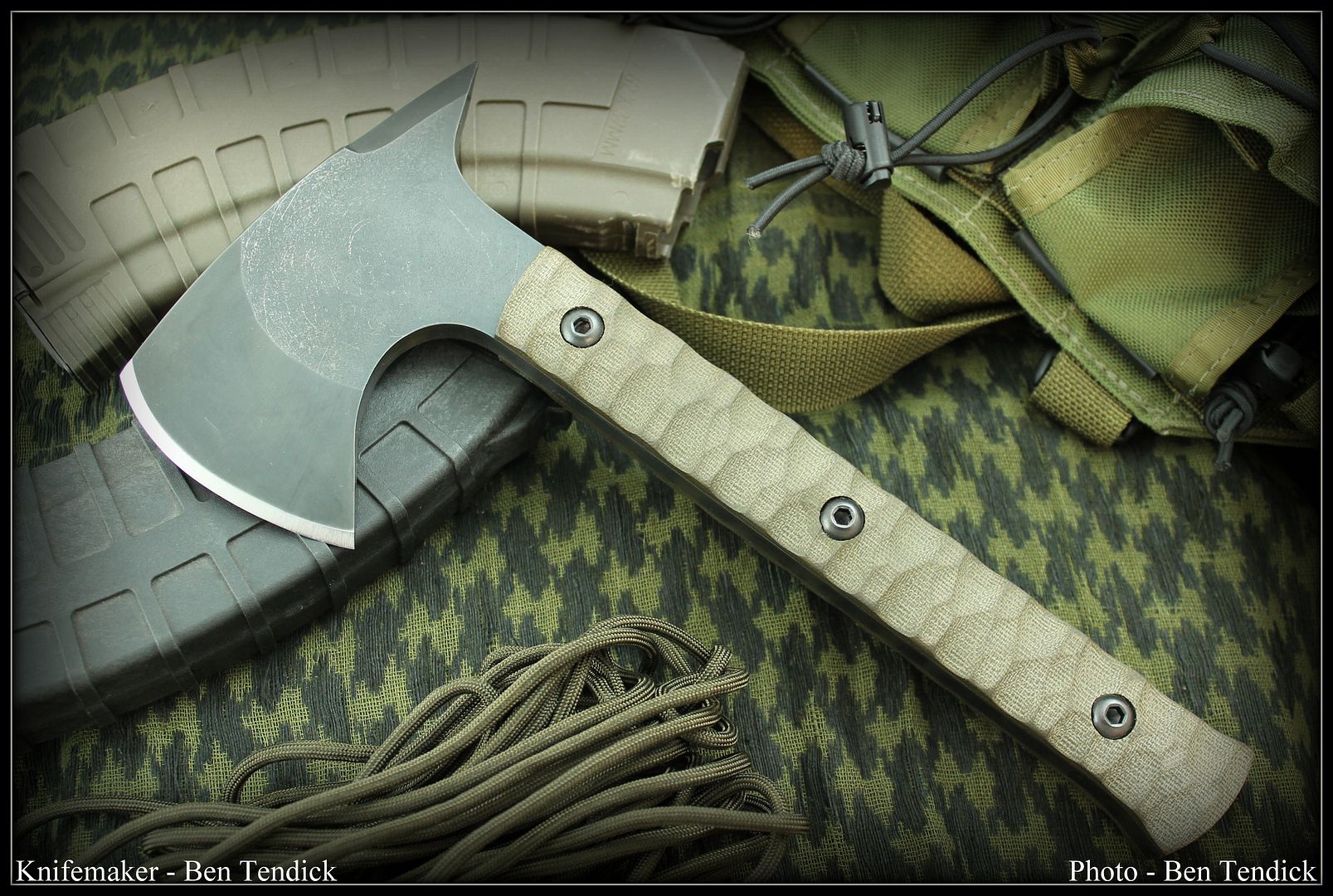

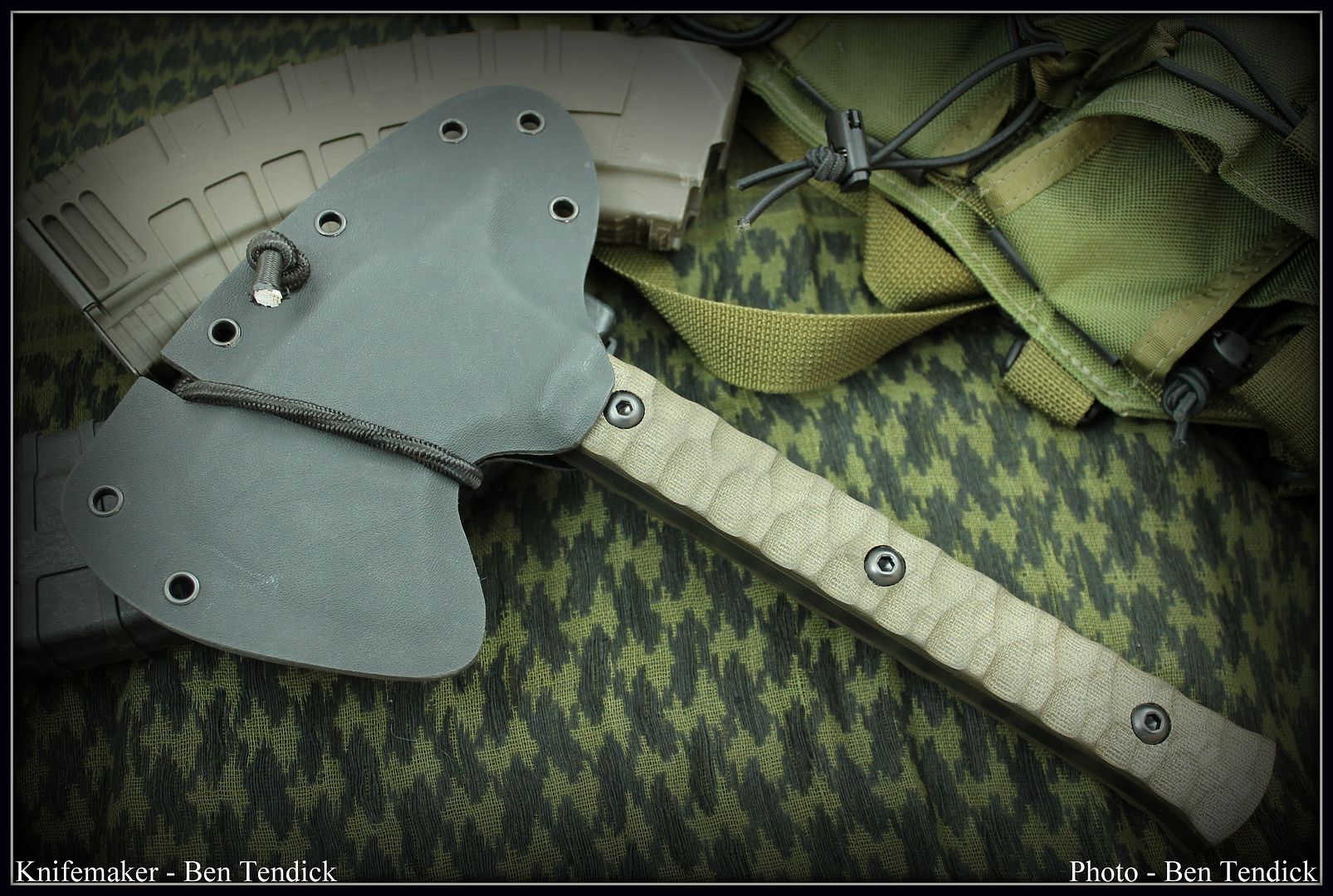

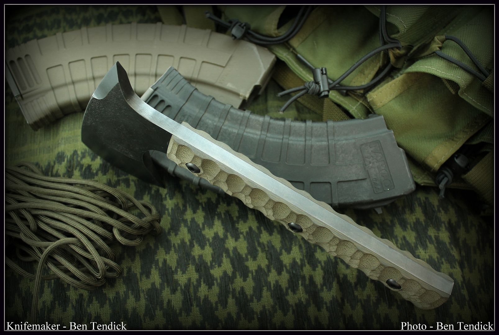

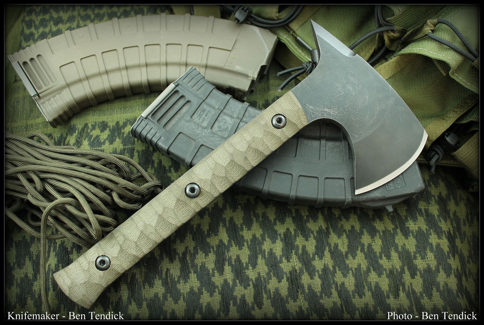

I just finished up this hawk tonight. This is the first full tang hawk I have done, and I am very pleased with how it came out.
I did a wip on it if you are interested in seeing the process...http://www.bladeforums.com/forums/showthread.php/1087103-Full-tang-axes-and-hawk-WIP
I have to give credit to Daniel Winkler for the bungee retention idea on the sheath, it is a simple but very functional way of locking the hawk in place.
The Steel is 4140, with an OAL of 11", a head length of 5 1/4", and a cutting edge that is 2 7/8" long.
Let me know what you guys think.
Gotta know: what is the weight? How thick?
The sheath: how easily does it release? The design appears slightly different than the Winkler/Tracker Dan design.
It is 3/8" thick and weighs in at 1lb 8oz. To release the hawk, you simply pull up on the bunge cord and it snaps out of the way, I think it works quite well.

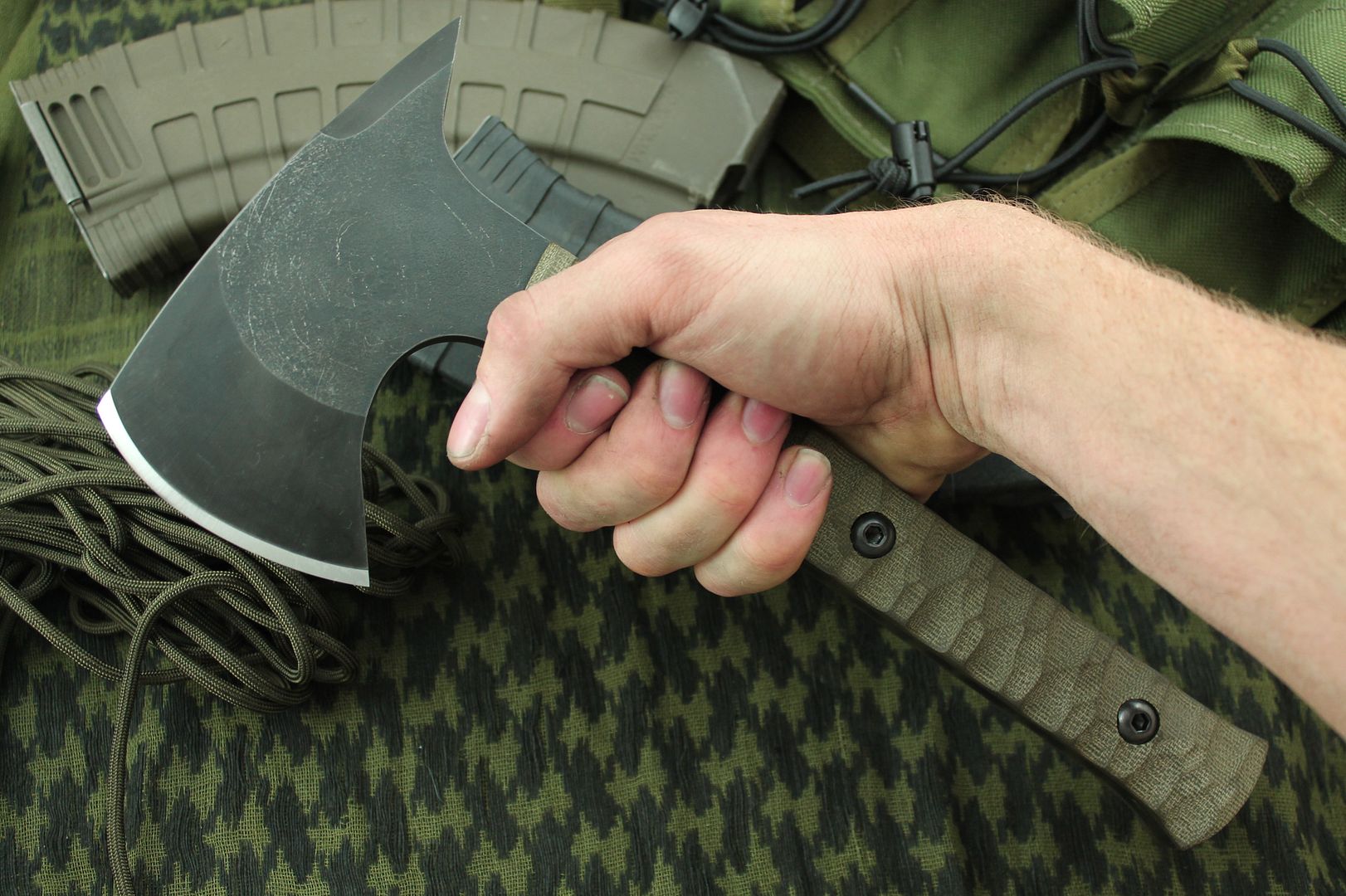

That's a beast Ben! Love it!
I only wish you'd move the camera instead of your wrist for that last shot... it's reminding me of the 3 times I've broken my left arm&wrist! :eek: LOL
Great work Ben. :)
Great work Ben. :)
Thanks Nick.
Yeah, trying to reach in my light tent and snap a pic is a bit awkward.
I know if I don't take an in hand shot though, someone will ask for one. :D
I wonder how they throw?
sweet, no nonsense design:thumbup:
Thanks Lorien. I am curious how they throw as well. I will probably have to wait, til I make one for myself, to see. :cool:
