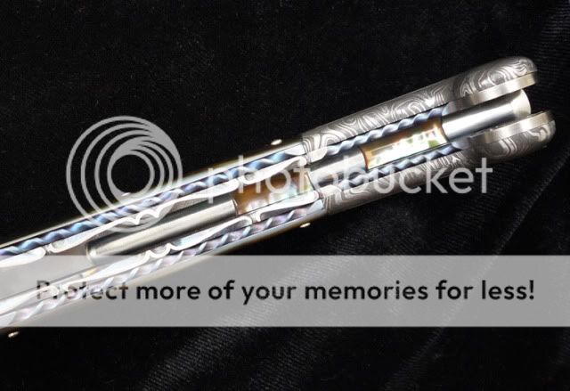

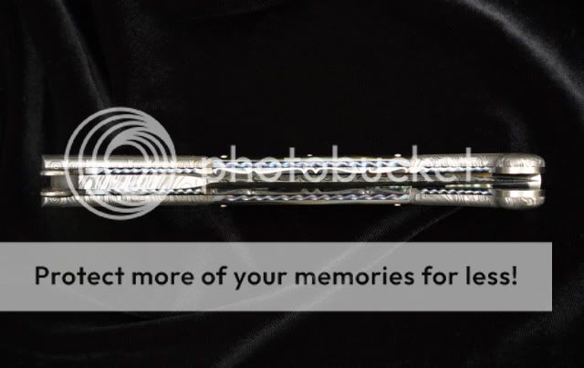

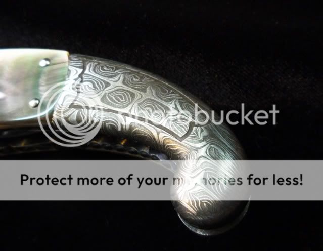

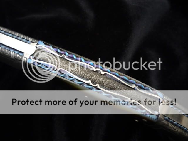

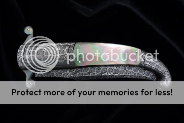

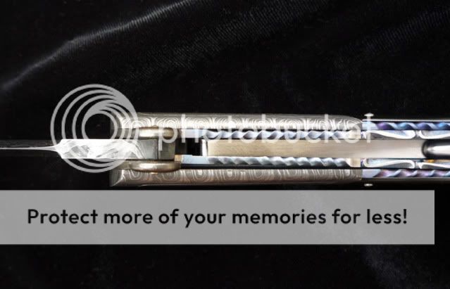

This is not new (I've finished back in may), but I wanted to show it because it's one of my best work... or at least I was very satisfied!
It's an auto folder, in persian shape, with a "secret" opening.
Specs are:
Blade lenght: 122 mm / 4 7/8"
Closed: 141 mm / 5 1/2"
Total: 263 mm / 10 3/8"
Blade and bolsters are in 5 bar turkish damascus, made from 1095 and 15n20 by Manuel Tacus. Forged to shape.
Grade 5 titanium liners, fileworked, jeweled inside and heat colored.
Black MOP scales with sterling silver domed pins.
Bolher N678 spacer with some texturing, and avalon blade stops.
No visible screws construction.
Let's see the pictures... At the end is a video.
Thanks for looking!
