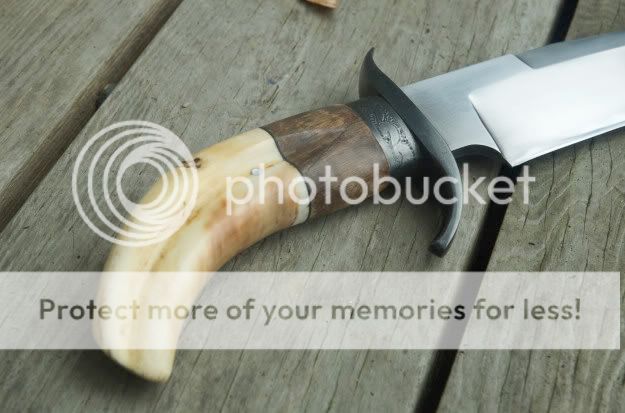

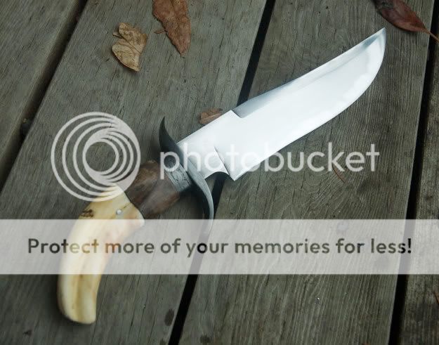

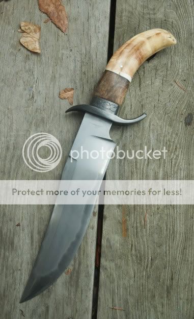

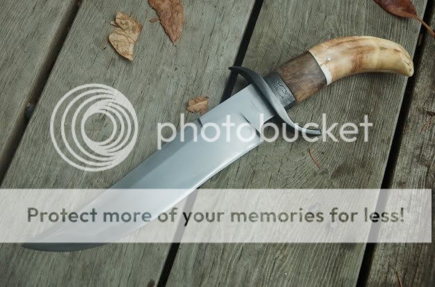

At about 2am I called this one done. A guy on another forum sent me a warthog tusk and asked if I would make him a knife with it as the handle.
It was a challenge but I really enjoyed this.
The Jason Knight/Dave Lisch course at Dave's Studio 4 a few weeks ago really helped my handle/guard construction.
Specs.
Blade is 8 3/4" of 1070/1080 with an OAL of 13 3/4"
Mild steel guard and ferrule soaked in cold blueing giving it texture and an aged look like wrought iron. (new method and I like it)
Handle is spalted maple/warthog tusk
I used a dremel for the "engraving" and will experiment further with this as a texturing tool.
I called it a persian style but if someone thinks this is something else let me know.
I need to come up with titles.
This is my 17th completed knife.
Thanks for looking.
