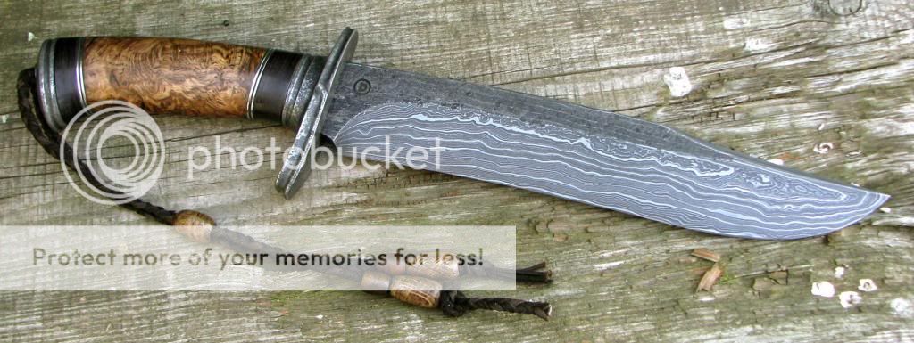

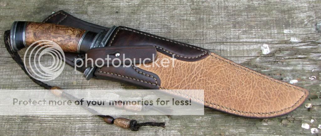

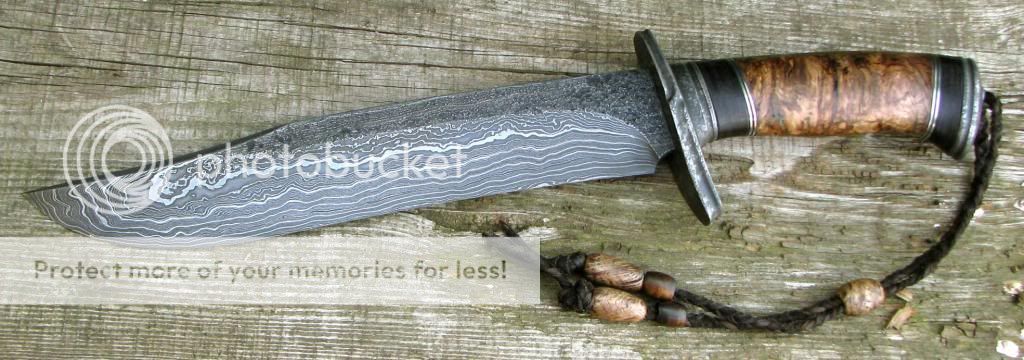

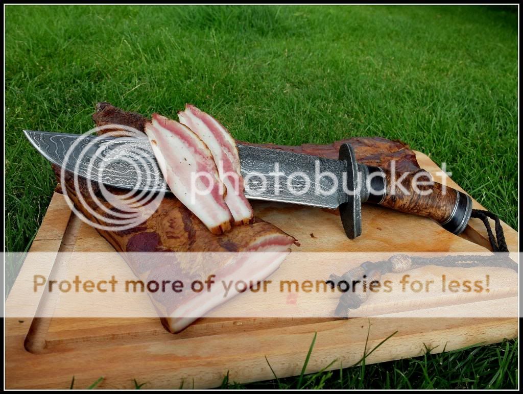

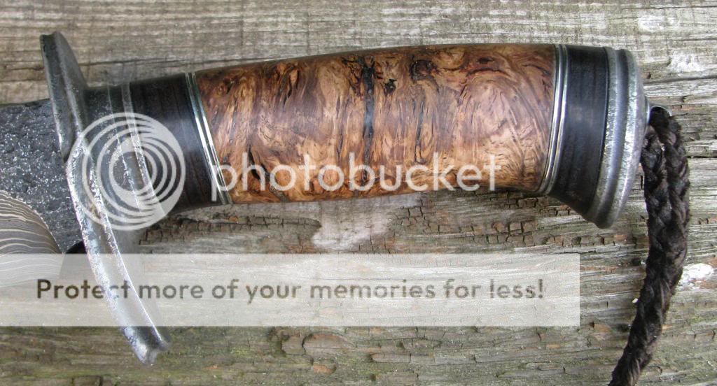

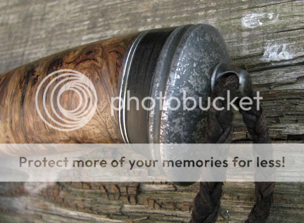

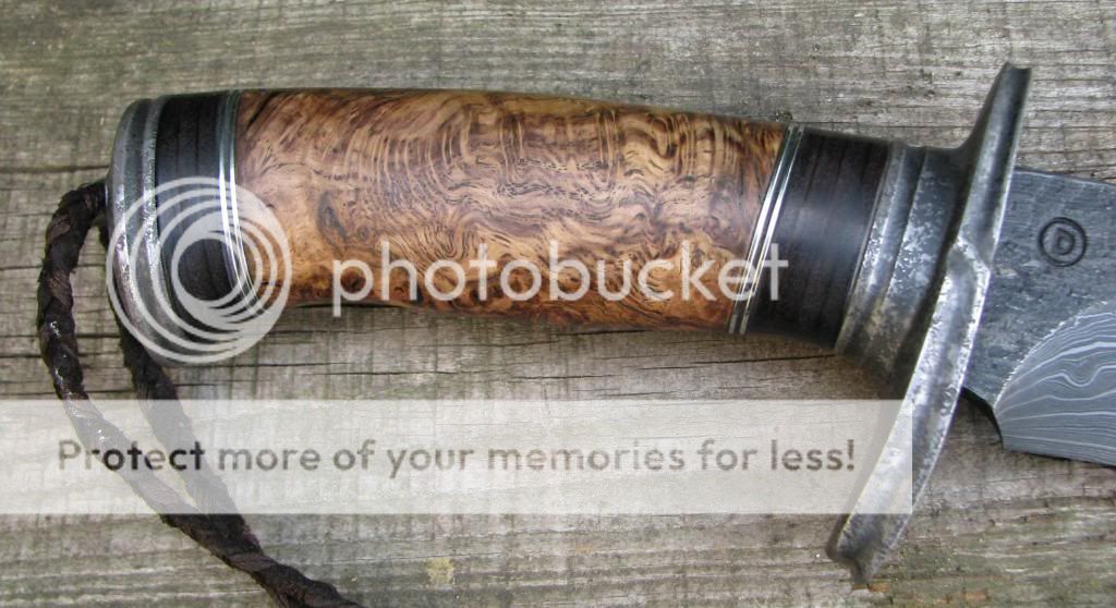

Our last Bowie.
Blade length 260 mm, the handset stabilized burl oak, leather rings, stainless steel and fiber. Fittings made ​​of hardened and patinated D2. Sheath - cow hide and sealskin. Damascus 500 layers, three steels, tool steel 19312, 80NiCr11 and the last is from springs my Ford Mondeo.

Very nice work Petr. Great overall package. Unusual using D2 for the fittings, I like the finish of them. Thanks for sharing it.
