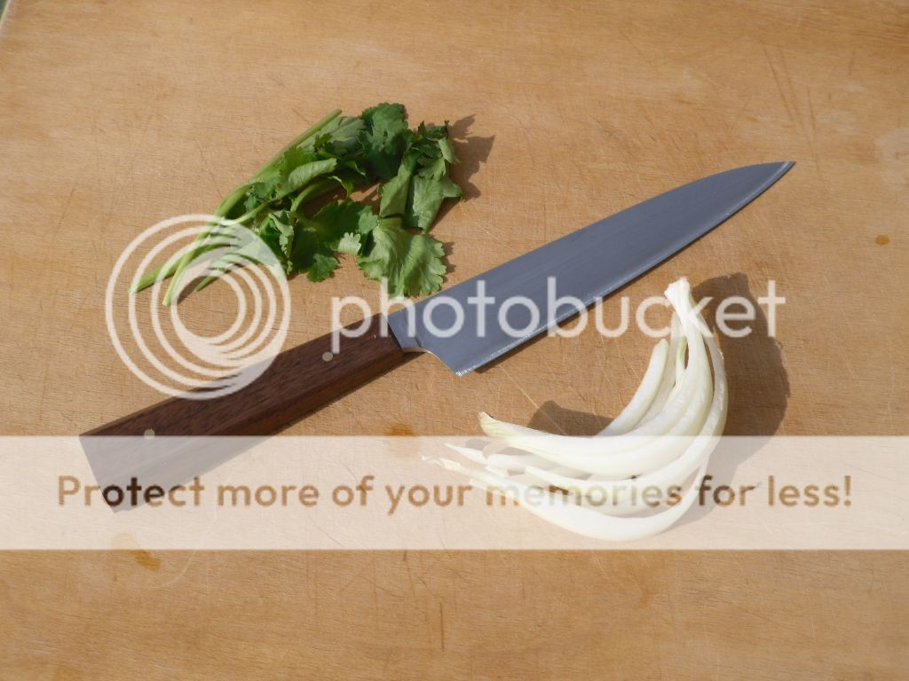

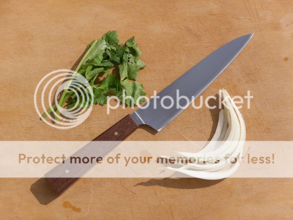

I just finished this one up for a friend. 1084 and Walnut. I need to do a better job of stopping my plunge before I reach the spine, and bring the edge down more before heat treating. I'm at .020" before HT, but I feel it could be lower. I use files to cut bevels and wet/dry paper to polish, so I'm limited on what I can do post heat treat. Hope you like! It's my 10th knife. Thanks for looking, and please critique!!!!!
