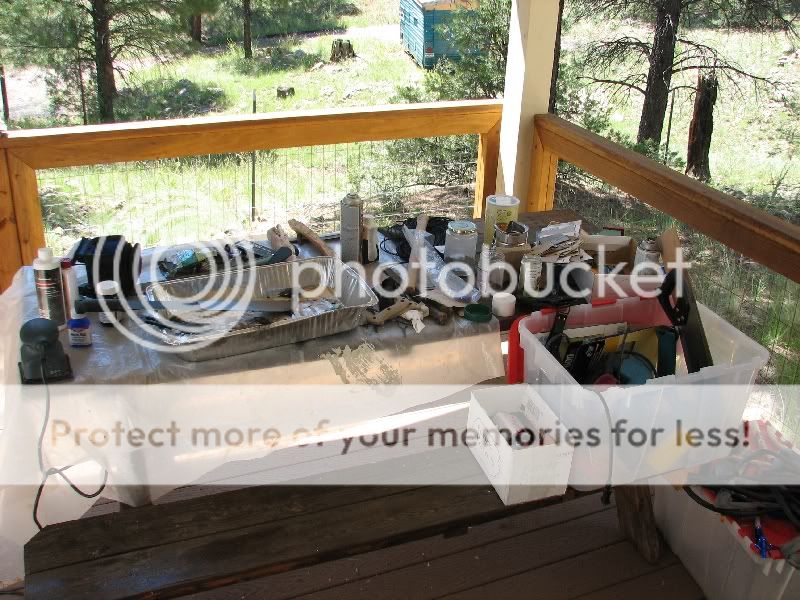

During a crazy weekend where I spent modding the heck out of a bunch of my bladed toys, I put some time into failing all over my Warthog.

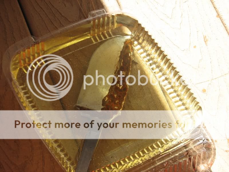

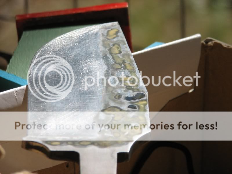

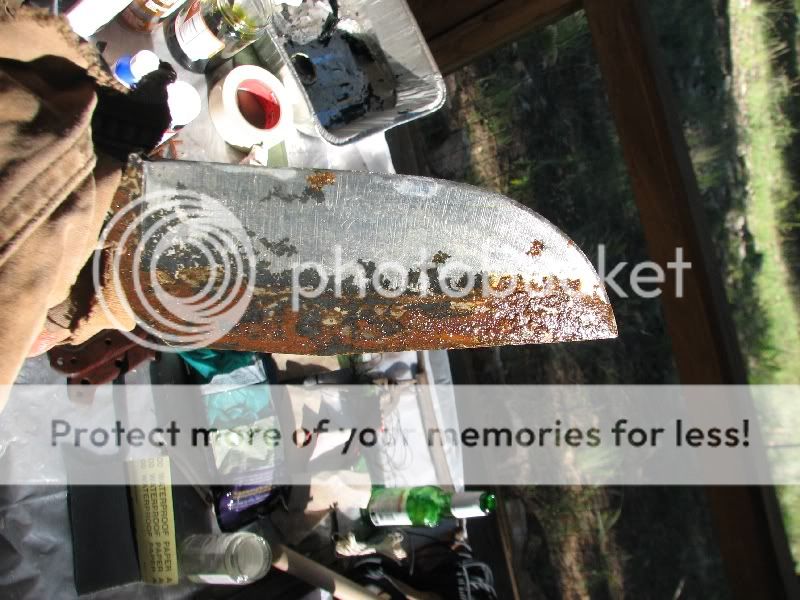

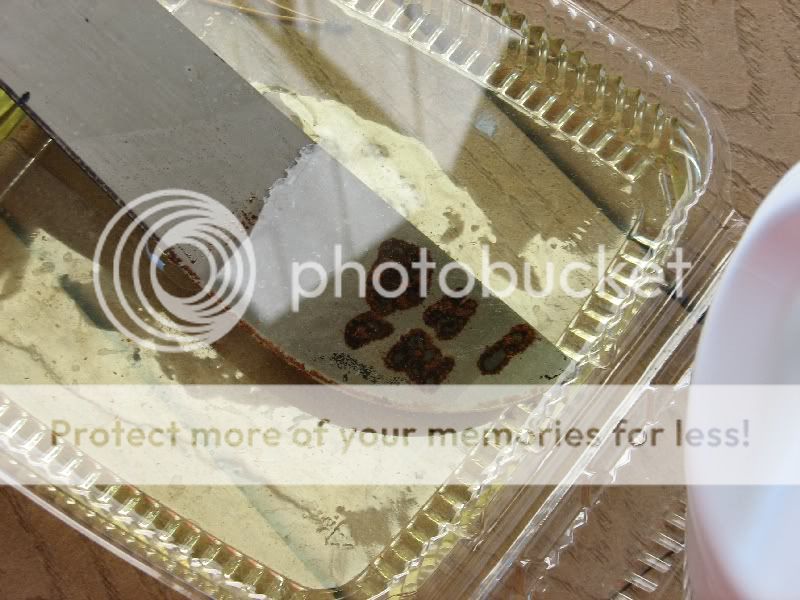

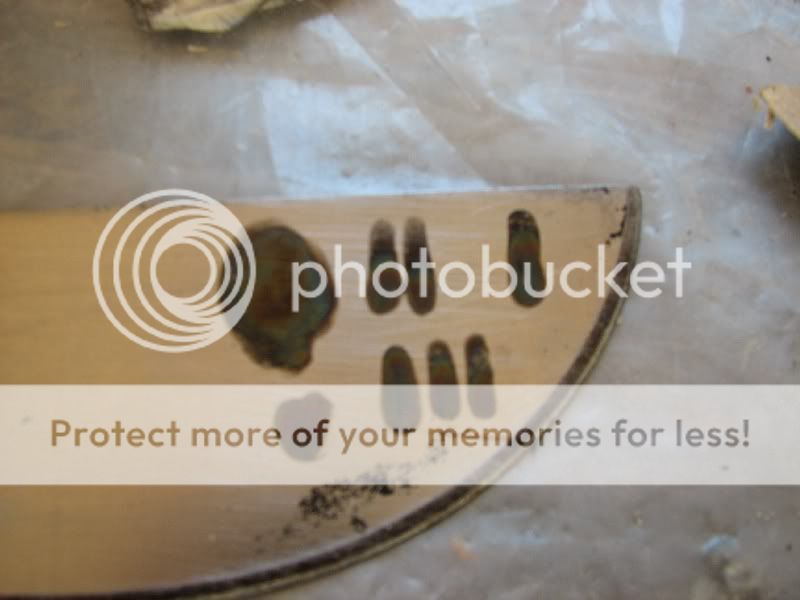

FAIL 3: ETCHING
So I have no idea how to successfully cold-blue etch a knife. I messed up bad on this Warthog, and messed up slightly-less bad on my BK11. And to think I first practiced on a cheap WalMart machete!
First I painted the blue on in several layers, letting them dry between each application.

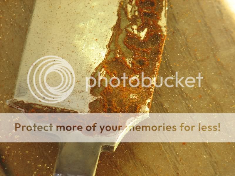

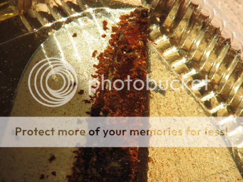

Then in to clean bleach we go... the reaction started right away, but I think I left the knife in the bleach maybe 1 or 2 hours. Note the specs of 'rust' where the reaction is taking place... I put NO blue anywhere on the blade, only on the flat area up near the spine, but yet there was etching going on all sorts of random places.

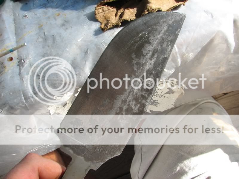

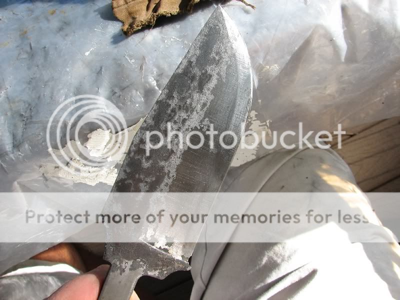

Ta Da! Bruce Sucks!
I put the blade post-etch in a bucket of water and went to work with it with 0000 steel wool. Here's the final etch, in all kinds of places I didn't want it. And not particularly deep or interesting in the places I did want it. Plus you of course still have all the grind marks.

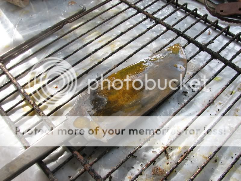

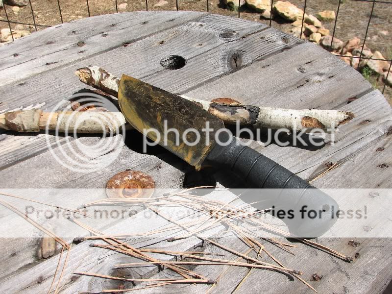

FAIL 4: PATINA
I wanted this brown and rusty looking. My Beckers came out brown and rusty looking. The Warthog looks like I spilled a glass of goat urine on it. BAH.
The only thing I think I need to try to see if I can salvage the patina is that with the Beckers, I did several 'coats' whereas the Warthog I only did one. Maybe it takes multiple applications. We'll see.

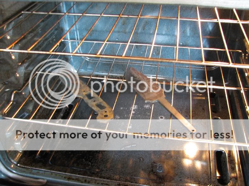

First, heat up to 275 in the oven *if your wife is not around*.

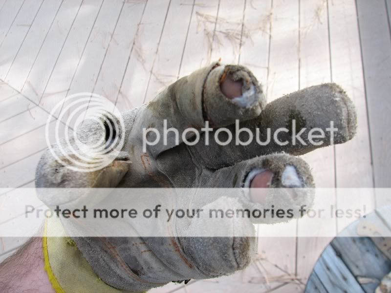

Next, find a ratty glove with holes in the fingers, grab the super hot knife blade, scream, curse, drop onto old BBQ grill.
Wipe on brown until the knife is cool to the touch.
Hit with steel wool then despair at the terrible, terrible color that wouldn't have matched the handle even if the dye had worked.

hmm. you are going to need power equipment or a LOT of time to remove the grind marks. Then for patina try heating the blade a little less hot & wiping it with mustard?

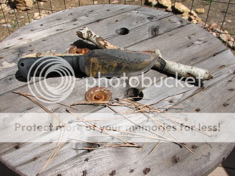

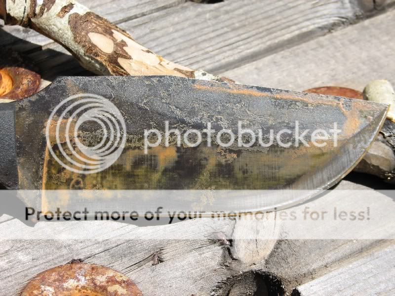

Thanks Logan. Yeah, I think my BK11 came out the way I had been picturing the Warthog: top photo.
Fishface: yep on the power equipment and time. Didn't have either as I worked on five knives and a tomahawk that weekend. Now I'm kinda screwed as far as the grind marks because of the etch I've already put on the knife.
And while I know about the mustard patina trick, I was trying to brown it up using the Plums as I like that kind of look. Check the link above to see the BK2; that's what I was hoping this knife would look like. We'll see if a few more applications of the Plums does the trick.
The thing I've learned with the etching is that as the blue/bleach acid eats through, the rust specs release and they float around and land on other parts of the blade. I used this to my advantage with my bk10 and actually putt the knife in upside down and let the "run" up the blade. I don't think its looks bad at all. Try a 3d etch by doing it again for more texturing and patina again and I think you will be pleasantly surprised with just how good at this your are.
In this pic the only part that had blue was the where the tumble finish was on top. But a little swirling of the bleach and the specs ran and made a cool effect
O and if you only want the etch to go a certain distance down the blade. Stand it on its spine and only fill the bleach up that far
