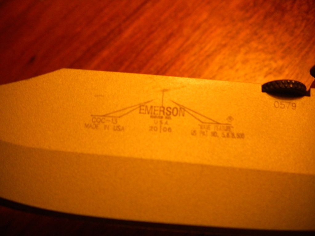

Excellent condition 2006 #579 Plain edge 13. Matte finish. Sweetness.

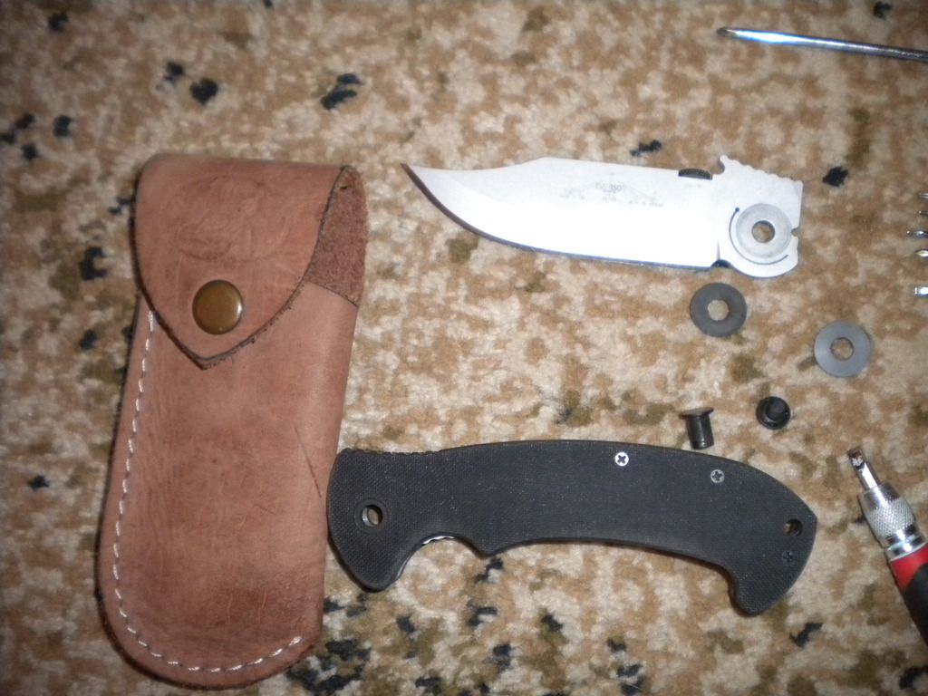

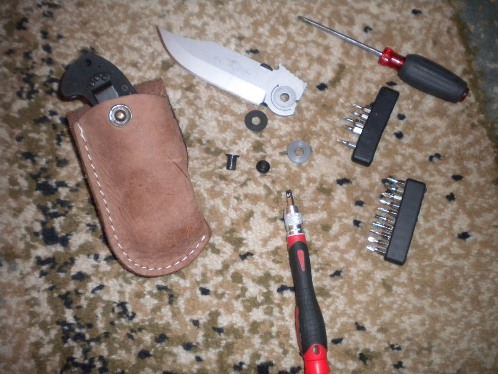

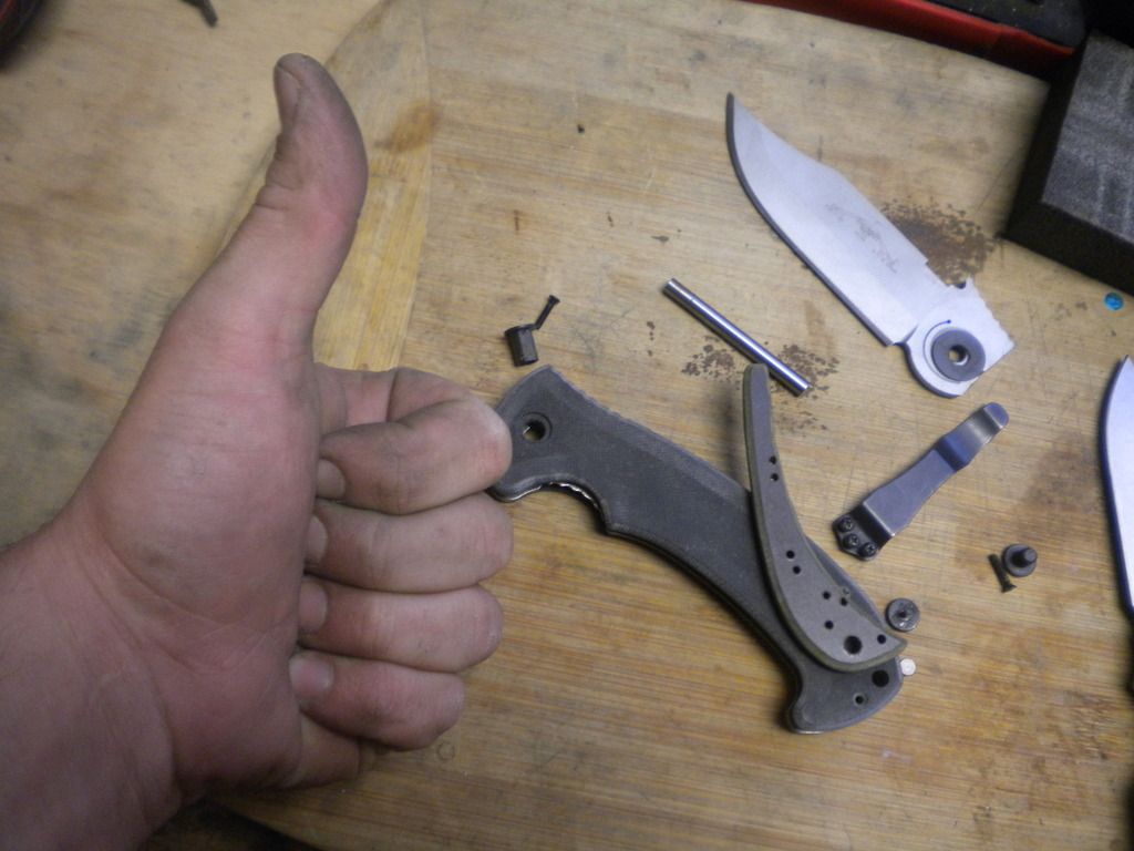

The first thing I did was take this puppy apart and simply clean and tweak it to my preference. Perfect lock up dead center of blade with just a hint of stick like I would want with an Emerson, The best ones I have handled had a nice minor stick and never slipped. I also make sure that there is no lube on the knife or parts. I prefer to allow it to run dry on the washers.
This thing is really a prime specimen for perfect fit and function. And locks up better than most liner locks I have handled on the market.

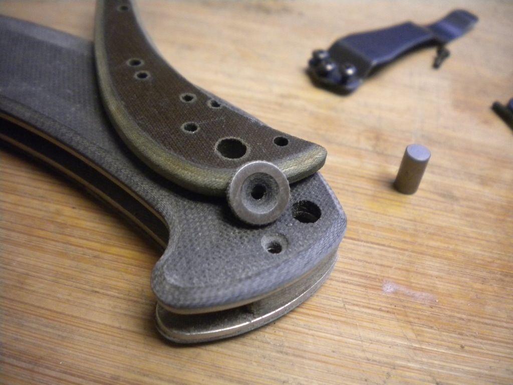

The finish of the scales to the liners is a bit rough as well as where the backspacer meets but only if you look closely..
I dont care its exactly as an Emerson should be. I plan on adding a chamfer to the handles and working them any how and making a new back spacer. Besides that I will take the coating off the thumb disk and enjoy. Its ideal as is. Once the handles are rounded the handle will fit like a glove, although it already does. The hook at the but of the handle makes for a nice easy grip with three fingers to chop.

I also like the set up with the stop pin. It is so easy to make a new one from a drill bit shank.

Also, I just so happened to get this sheath from a forum member a month back as an extra in a deal. It just so happens to fit this knife perfect!

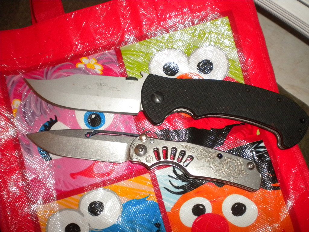

Next to me other knife, My EDC Ti-lock.
This Tilock is dear to me and I need to use it a little bit less. I use it just as hard as any thing else, but when I work my late shift. The 13 is my new baby. This is a nice duo to own. The only other liner lock on the market I care for is the military at this time. But I must say I far prefer the liner to be titanium than steel, it just grabs so much better.
