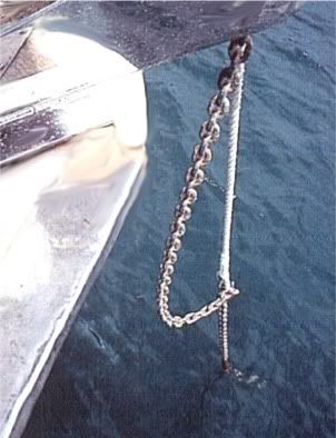

Another option might be to improvise a snubber like one uses to do the same thing when anchoring a boat or on some fishing rigs:

Thanks for your thoughts. Perhaps some sort of shock absorber could be useful in some circumstances. My initial 'fix' is simply to use heavier cord.
