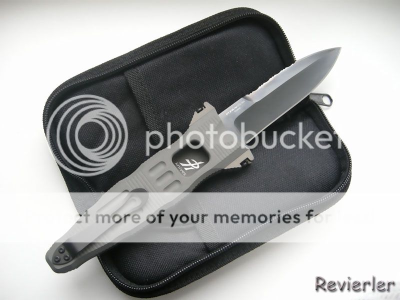

The knife comes in a black cordura knife case which is delivered again in a cardboard box. It also contains a piece of cord and two (optional) opening pins with detent screws and a suitable wrench for mounting them, but these are not really necessary, however, to be able to operate the knife.
The processing of this knife is flawless. One would see such precision in a Microtech with pleasure! Sami Stinner confirmed towards me that there is a relatively high drop out rate in the production cycle, because only the best hand chosen pieces are used to assemble the knives.

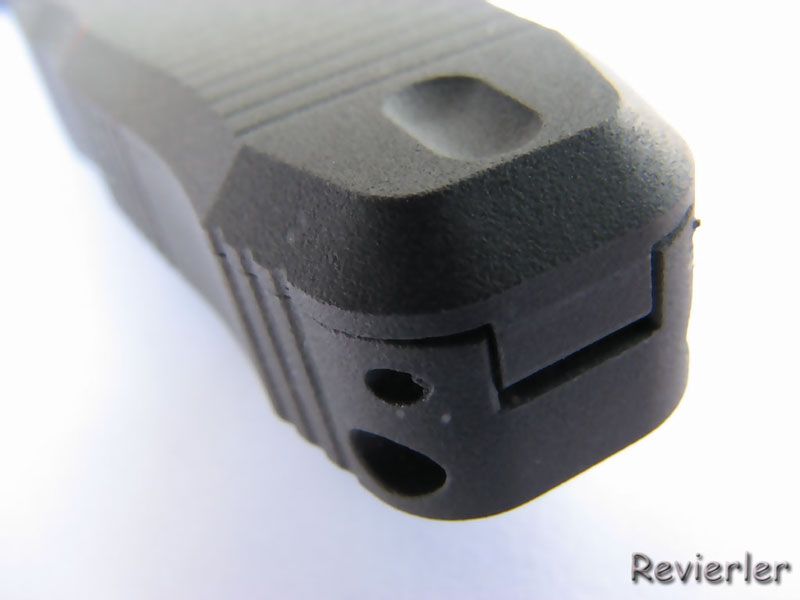

The body is mace of aluminum and provides a firm hold even with wet hands due to the many flutings in the material, everything is executedmost cleanly, there are no irregularities. Before the Anodizing (there are gray and green variations) the material matter blasted to produce a clean and even surface.
In the screwed on "parry elements" two small Plungers are seated which release the blade when locked open. Again one finds only the best manufacturing quality great attention to detail.

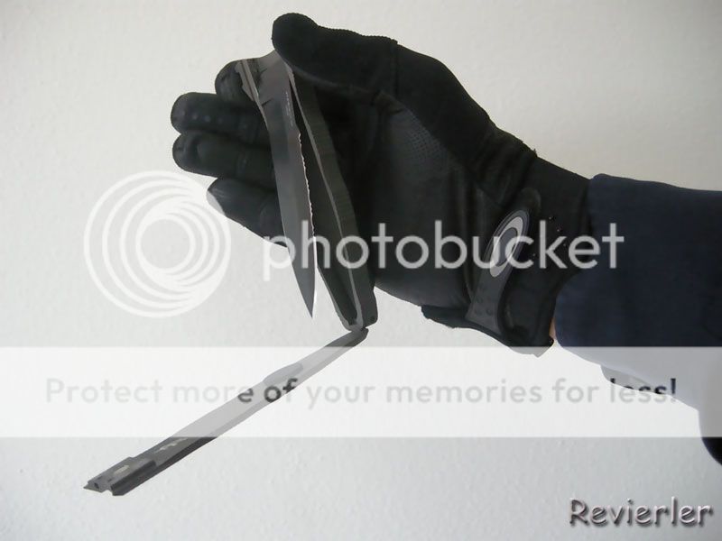

To open the knife, one must hold it with the thumb and 3 fingers on the lateral sides of the handle and with the index finger on the front side of the side plate (latch). The Index finger flips the latch open, against the hold strength of the magnet keeping the side plate closed. With a movement of wrist the side plate swings open, the blade swings out of the handle, then the side plate, by a quick turn of the wrist closes with a nice snap.
The play factor is huge... just like with balisongs, but there is no risk of injury. If one holds the knife in such a way that he would come in contact with the edge,the side plate is blocked and the knife does not open. It is possible nto mount the opneing aids for operation with with gloves, But this will only be necessary with really thick gloves.

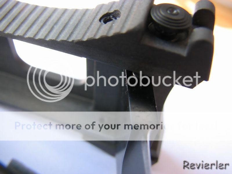

In the area of the blade root some wear tracks originate from the aluminum of the side lid, because the steel blade slides along the lid upon closing/opening the knife. These tracks can be wiped easily off the blade, however, in the side plate a small nick appears, which is normal and originates from 100s of openings and closings. There is no functional problem. The blade still sits bomb proof in the handle.
Also the side plate developed a very slight rattle in the hinge area, probably due to the smoothing out of the anodizing in this area. This can probably be cured by later adding a very thin teflon foil washer....
