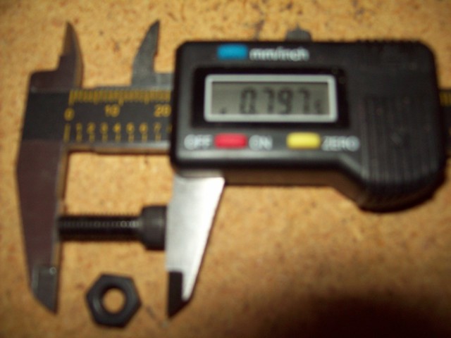

First, we start by taking some measurements:

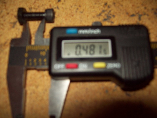

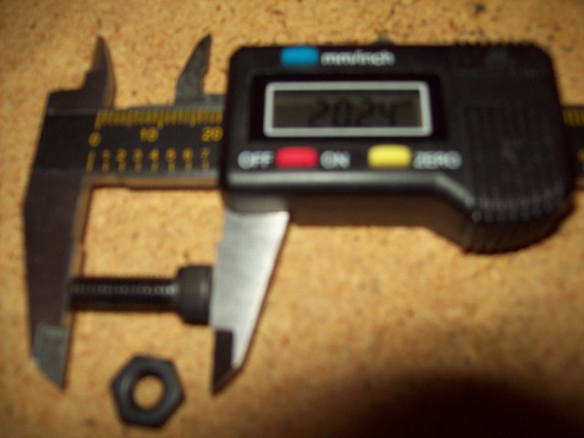

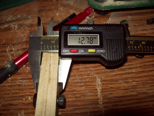

Overall legnth of the bolts that came with my BK-5 were right around .79 inches.
That's around 20.25mm for you metric fans.

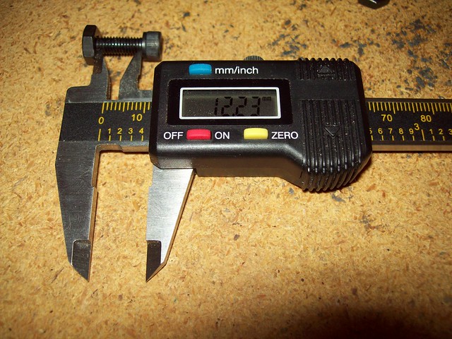

The length of the threads(minus the cap and screw at the other end) is just under 1/2.
Again, in metric, that's around 12.25mm.

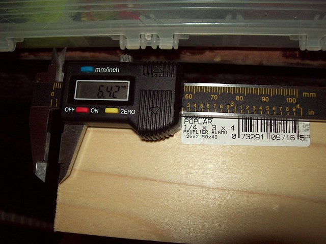

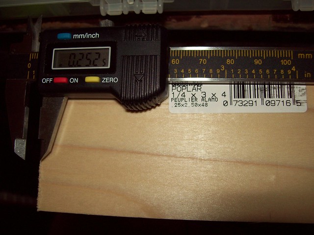

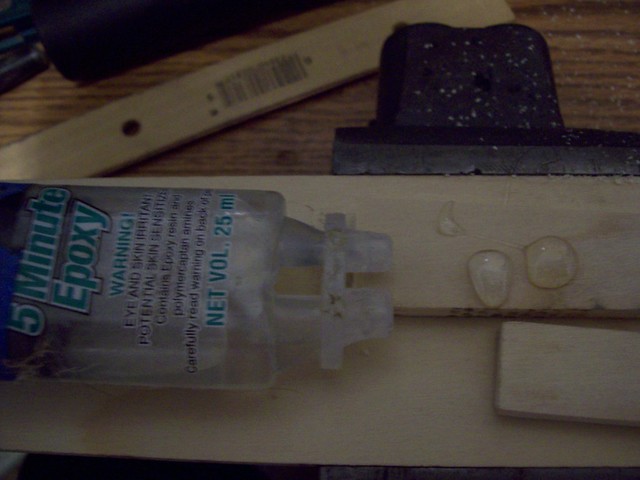

A quick scrounge around my house lead me to find this: some 1/4" lumber that's actually close to
size... Two thicknesses should be right on the money to leave a little "wiggle room". The objective here is to find something pretty close to 1/2" /12.25mm thick; and remember: you can always remove, but once it's gone, that's it.
Metric is around 6.4mm.
I epoxied the two parts together -- The dimensions other than thickness are not crucial, just enough to
clamp in a vise or hang on to whlie sanding.
This part reminds me of watching paint dry...

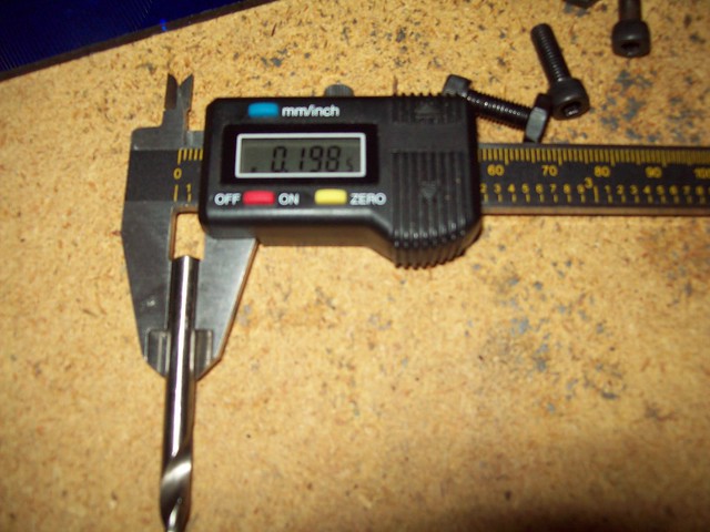

So, While it did, I went off to get some more measurements:

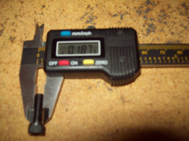

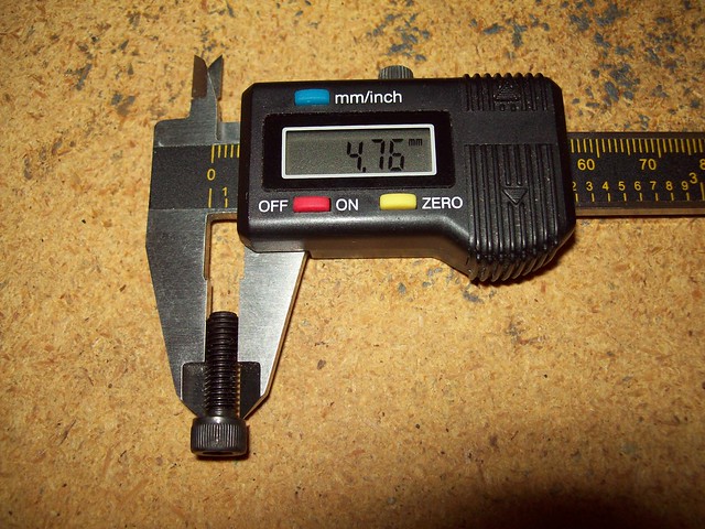

Thread width: ~.18"
or ~4.75mm.
caps are ~.309" / 7.87mm
bolts are ~.365" / 9.26mm
I mention this so you don't pick a drillbit that's too big!
I found this 13/64 drillbit in my cheap-o-matic drill index -- check specs on your own, but 13/64 / 5mm
would be what I shoot for to allow plenty of clearance for the threads. 3/16 looked a little tight at .183".

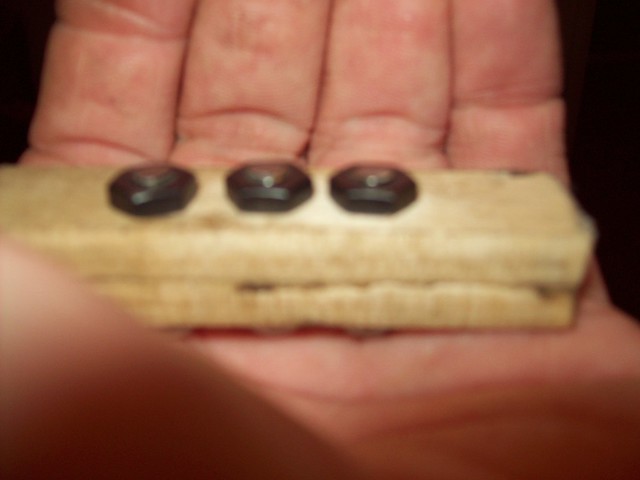

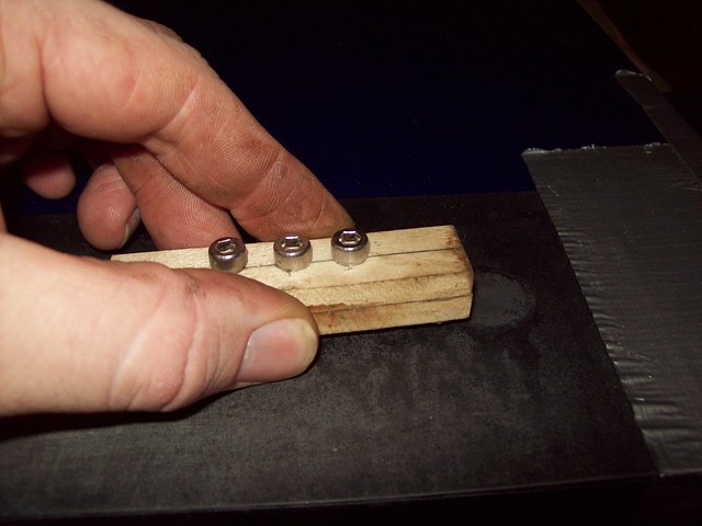

Here's mine glued and trimmed squareish (so there's less lateral stress when in a vise.

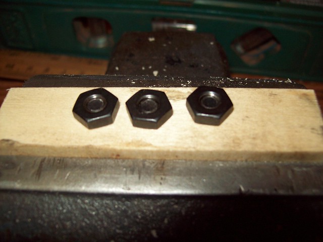

Next, Mark the three points to drill for the jig: the trick here is to have them close enough to shorten them as one via your preferred method, but not so close that the bolts/hexcaps interfere with each other.
I used 1/2" / 12.25mm between the center of each hole to good effect

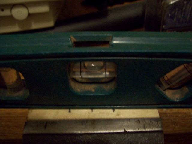

Be sure to level the jig before you go drilling if you don't have a drill press! (my drill was held level as well)

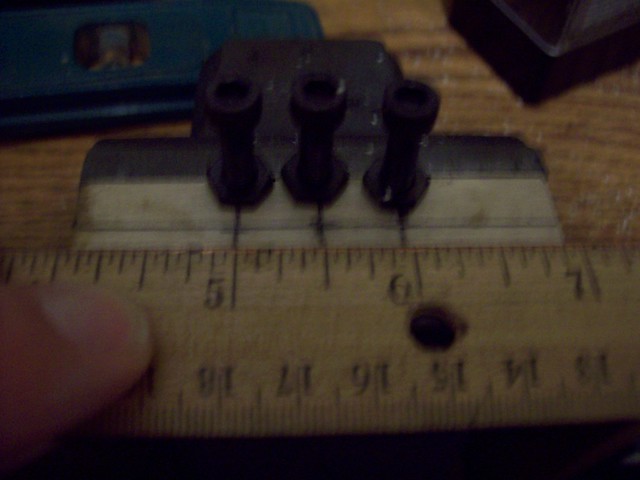

Here's the rig with the stock hexcaps in it, note the "wiggle room" built into the jig.

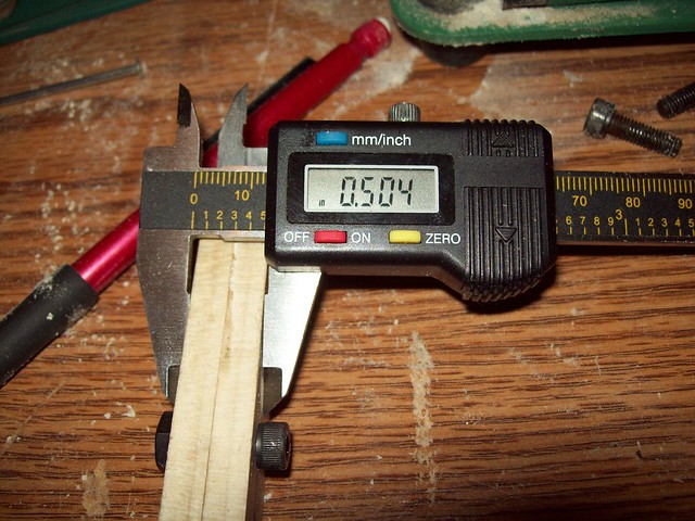

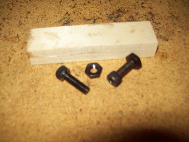

Reality check! let's see how close we came to our target thickness.
Metric friendly version:
Close enough for me, If you're pickier than me, sand it down using a "figure 8" motion and minimal pressure on sandpaper taped to a piece of glass; but be sure to leave the "wiggle room".

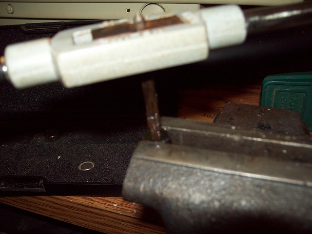

Here's where I expect to get a little well deserved flak about this lack of a "design" :foot:, My stainless locknuts were .237" (about 1/4") or 6.03mm thick. And the stock bolts were .126" (about 1/8") or 3.2mm thick, and also had different threading.
If building one of these for yourself,You should either buy 3 standard {not lock} 10-24 nuts of about .126" (about 1/8") // 3.2mm in thickness, or Shave 1/8" //3mm off the thickness of the rig!!!
For me, My taps & dies were 5 minutes of free. Hardware store trip was 25+ minutes and about $1 I could save for beer :D :cool:;)

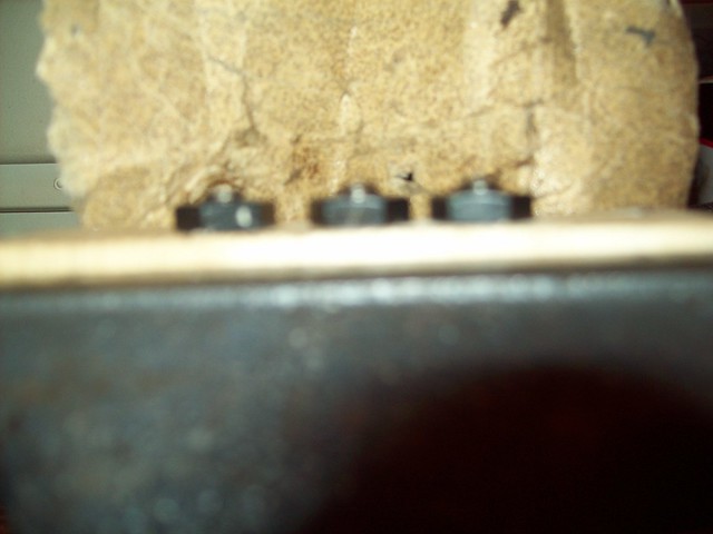

Rig Complete !!! Insert blurry pic to show how close I got by "eyeballing it" before I built the rig...

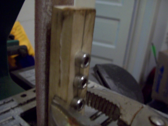

Example of using belt sander (taut belt on platen for you grind-meisters out there)
-use a pair or two of "locking pliers" to hold the jig, very tightly
-use protective gear
-don't grind too fast and create a ton of heat
-note: sander was OFF and unplugged for the picture--I like my hands as they are.

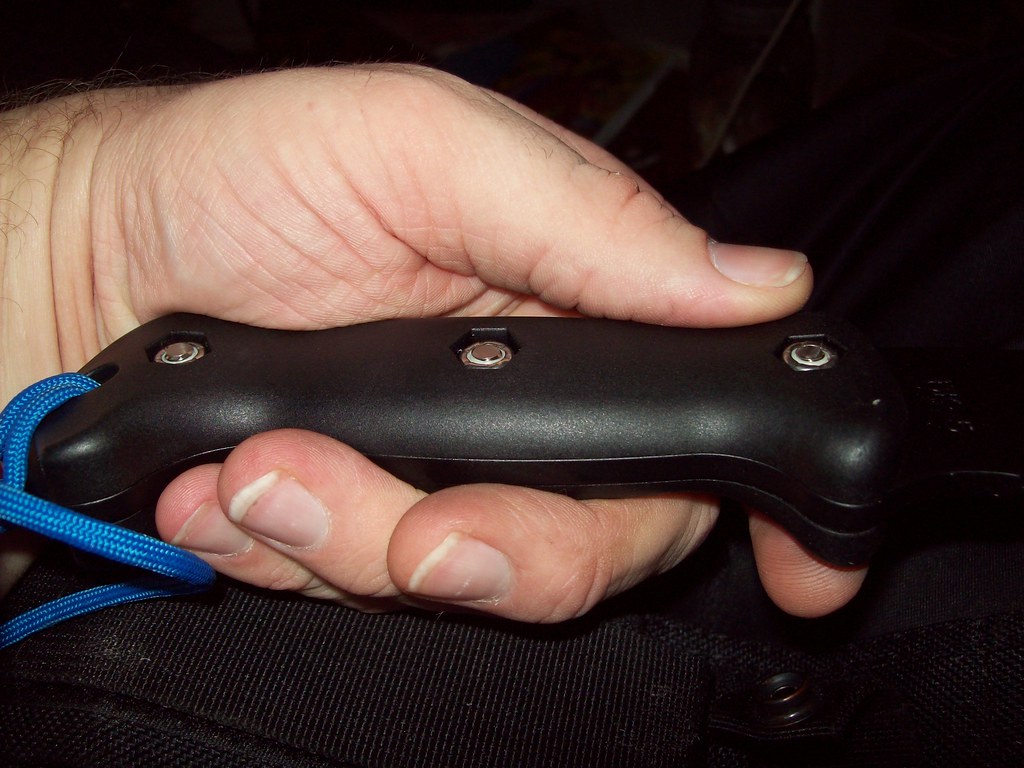

And here they are installed on my BK-5 ready for action!
