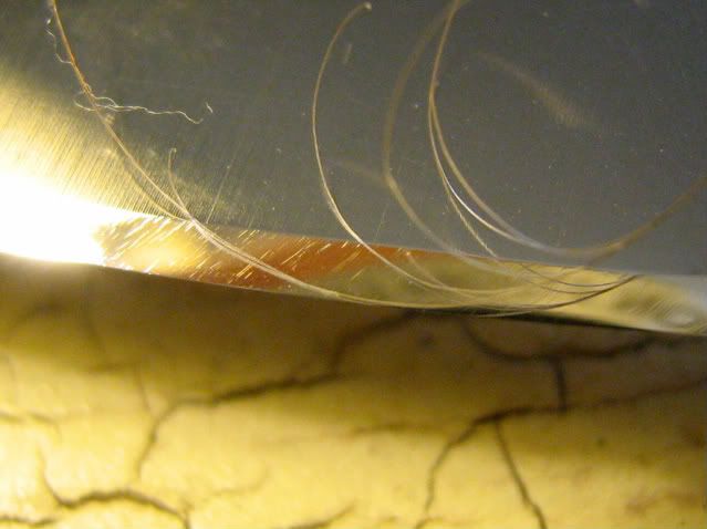

I have been hand sharpening for 18 years and have used almost every stone and system that came along. I always stuck with hand sharpening because my edges were always sharper than with any jig, plus I enjoy it more, more "In touch" with the edge. I used Spyderco ceramics for the longest and would still highly recommend them, they work very well at finishing carbon steel blades but as the steels got better the ceramics started working slower. I started looking for some more or new sharpening stones and after doing a lot of homework I was almost set on getting a full set of waterstones. I then found diamonds :D and that is the way it will stay. I went with the DMT hones because thay have the XX-Fine(8000mesh/3 micron) and a good rep. In total I have the X-coarse, fine, X-fine, and XX-fine dia-sharp 8x3 benchstones, I plan on getting the other 2 to finish the set but what I have works fine for now. I also use diamond compounds on my strop and well, I let you guess how well that works.
If I had to start all over again with what I know now It would be diamond stones all the way. You may not get the best finish on you bevel but you WILL have the sharpest edge.
If you want the perfect mirror finish add a Spyderco UF ceramic as you last stone before the strop. It will look better and still be very close in sharpness but that diamond edge is really something. :D

That's freakin' crazy! You can see the text around the camera lens reflected in the edge!:eek: Did you do that freehand or was it clamped in something with you using a guide?
BTW, I put a mirrror edge like that on the exact same knife using an EdgePro. I still have it for now but I'm going to sell it.

That CPM-D2 gets nice and shiny :D and that's freehand my friend. :p

Yeah, it does. I've polished it a few times. I don't know about people who complain about not being able to sharpen D2. I think it's the best.
Still, freehand... you have some mad skills!

Thanks, here's a little close up you might like. I guess I should add that my UF ceramic has been re-lapped by spyderco and is much finer than before, closer to a 1 micron stone instead of the standard 3 micron.
